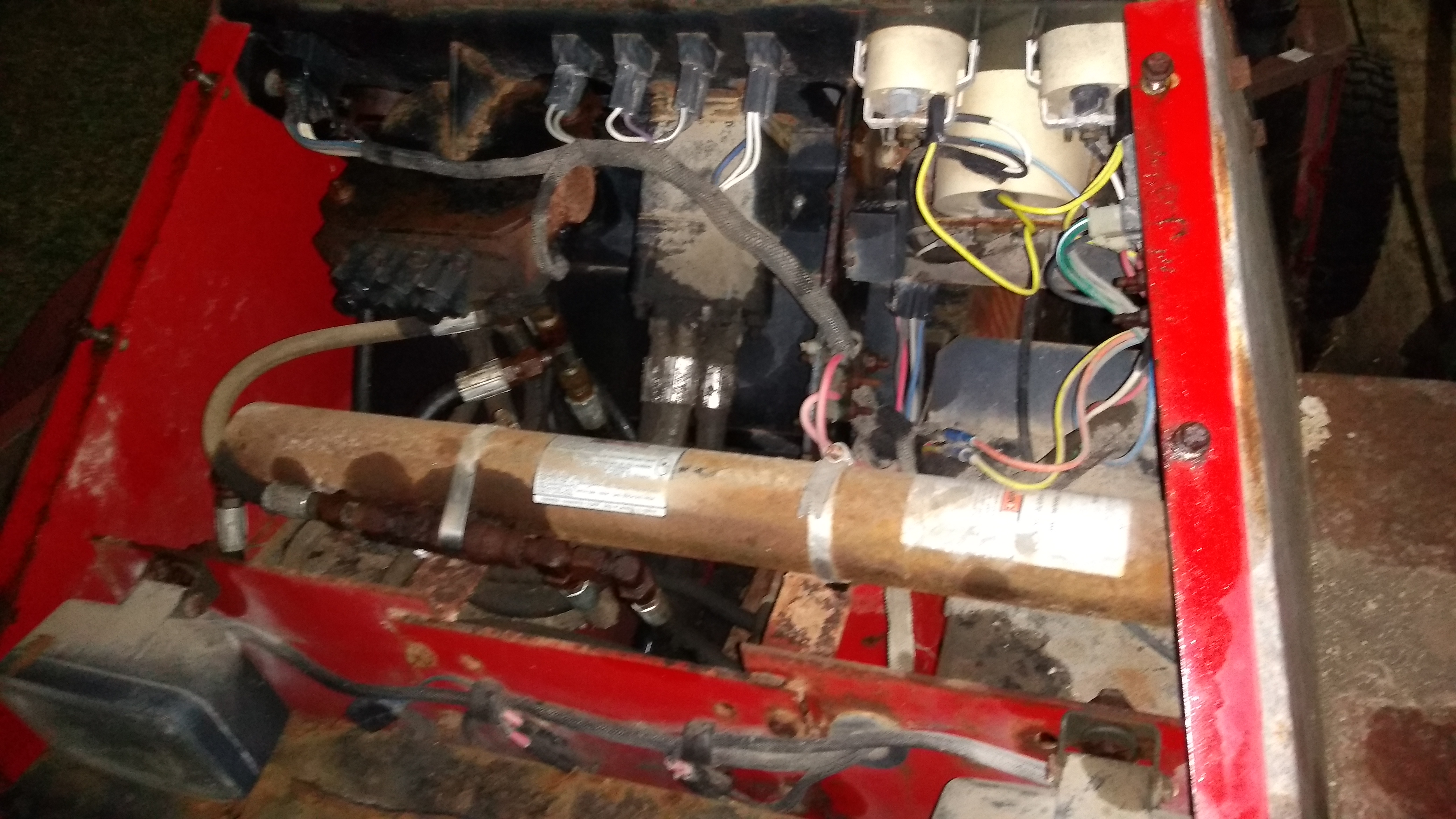

#14
Does anyone know what this is? the long brown tube?
My unit has some sort of Parker hydraulic dampener/accumulator. I don't see it on the parts list.

#18
What do the two stickers say?
It is a Parker piston accumulator. Many are charged up to 150psi on the dry end of the piston. Still not sure of it's reason for being.
I found it!
https://www.messicks.com/st/3507
Item #37
It is T'eed into the left most hydraulic spool. The manual they sent me only has a 2 spool, mine has 3 handle levers. Middle one I believe is for the hydraulic accessories on the front available pair of outlets. Right is for front attachment Float/Lower/Lift. So, not sure what the left one does just yet? Could it be some sort of cushion for the lift cylinder??? It has a strange decal associated to it with a rainbow arrow pointing to the front end, and one pointing to the back???
   / Old to Me, Steiner 230 questions
#19
Okay, I am now guessing that it is to help control the downforce or lack thereof of the front end lift system.
   / Old to Me, Steiner 230 questions #20
You sure it isn't a hydraulic weight transfer system? ..... jim
