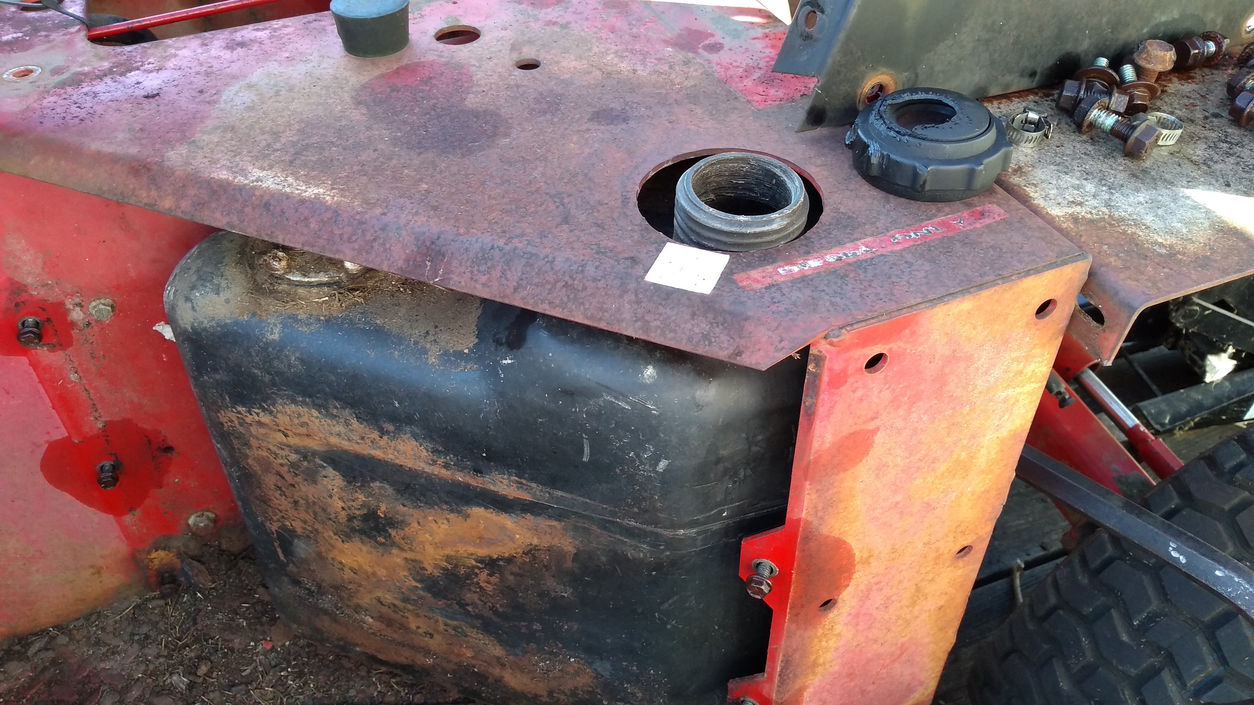

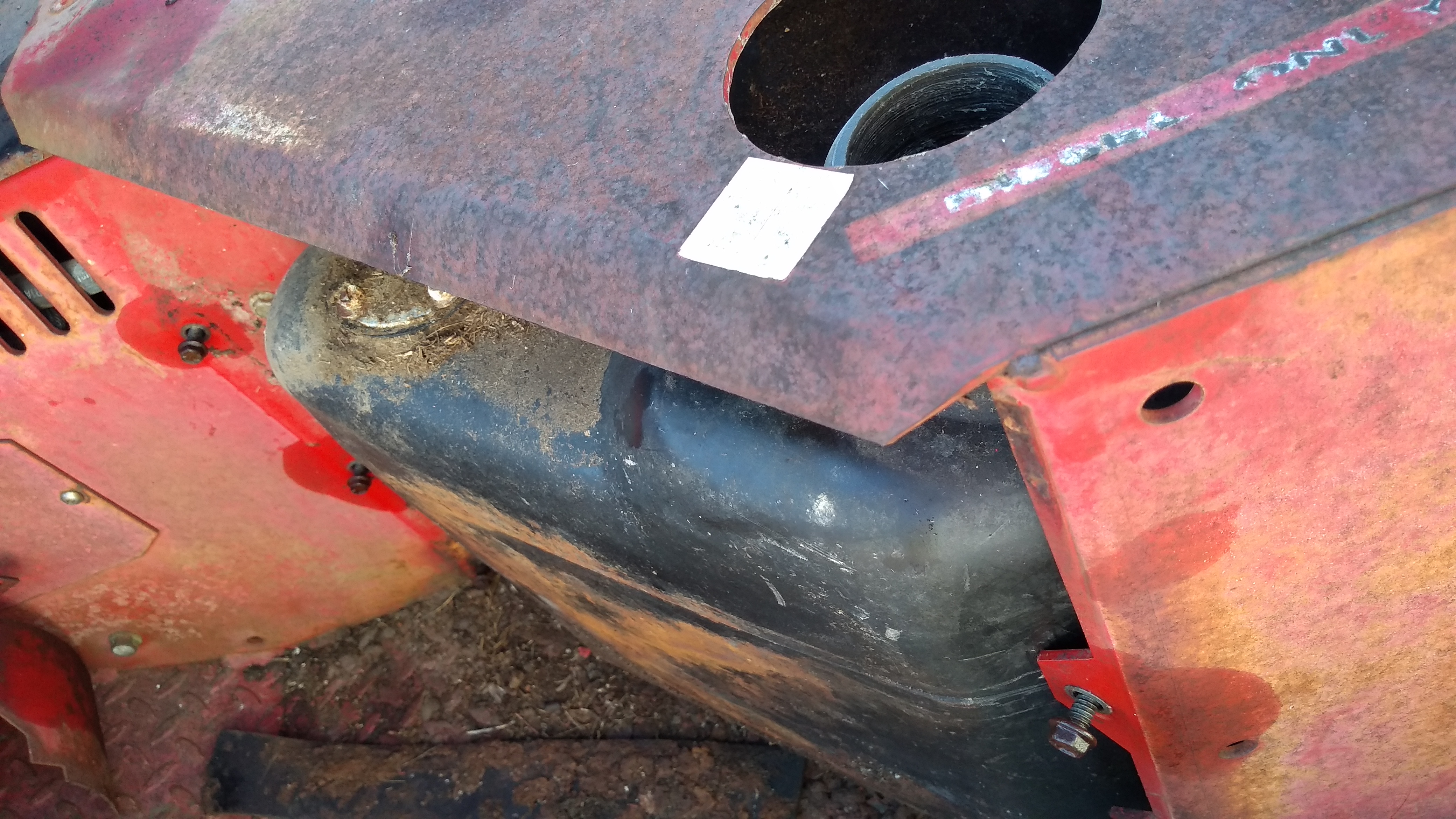

Here is the fuel tank's filler neck. It also has a protrusion on the bottom. This is what makes it so hard to get out.
Here's how I prayed up the main sheet metal with a crowbar under the back angle iron support.
I needed every millimeter to get the tank out.
Finally. Got it cleaned, replaced pre fuel pump filter, emptied main fuel filter.

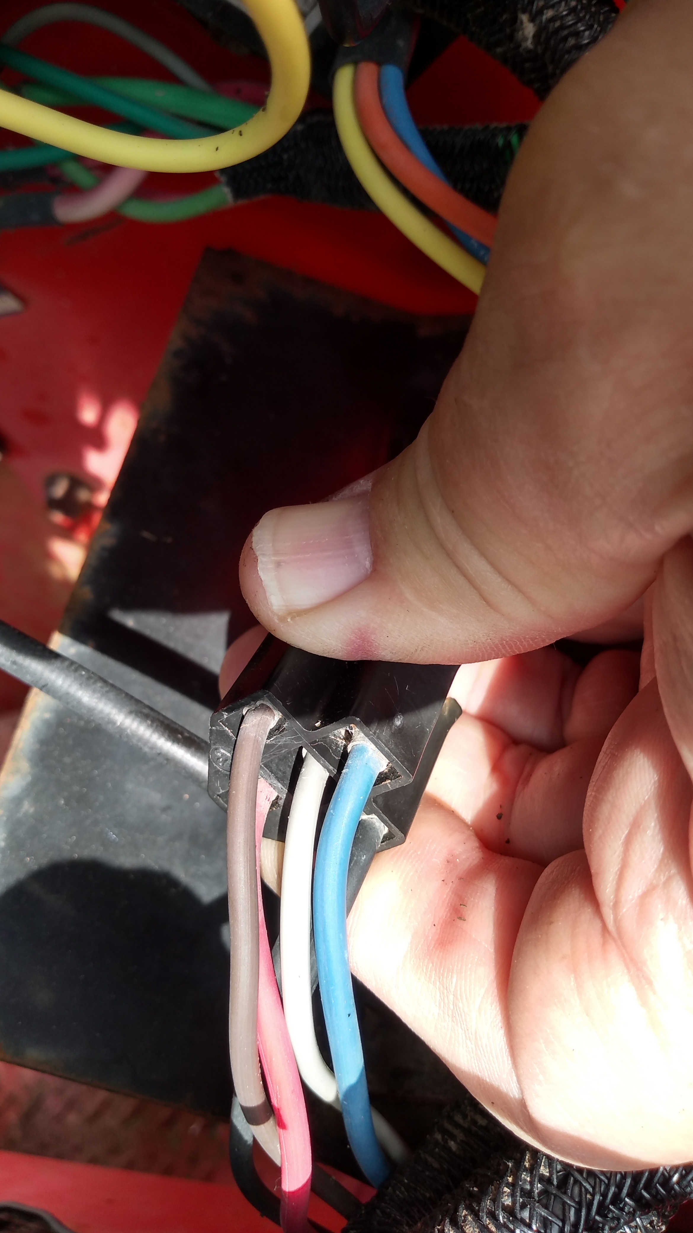

So under the dash, there was a five wire relay. I ended up replacing it because every single prong was totally rusted off.
I had to replace this female harness attachment because the old male prongs had rusted into it.
