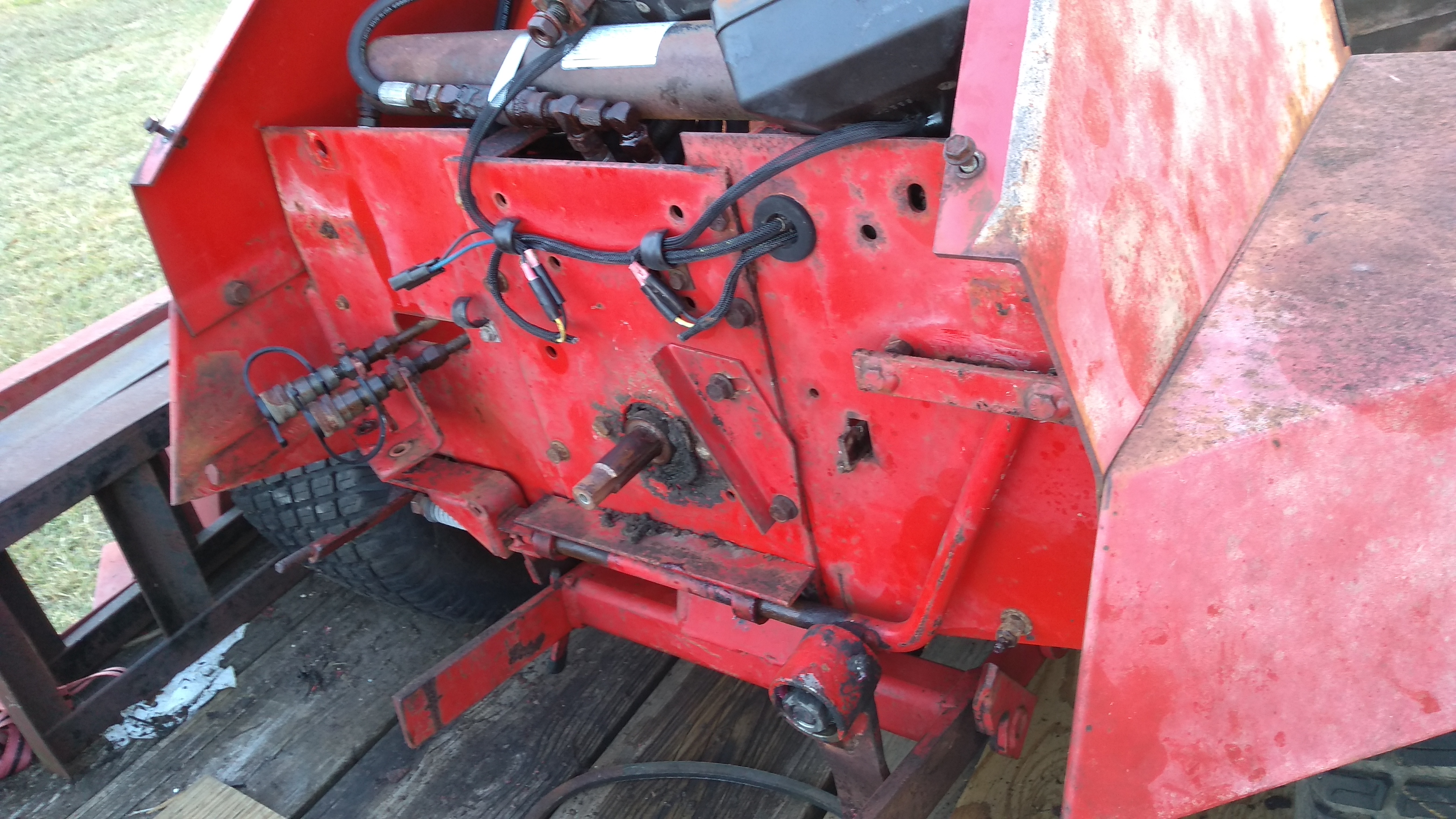

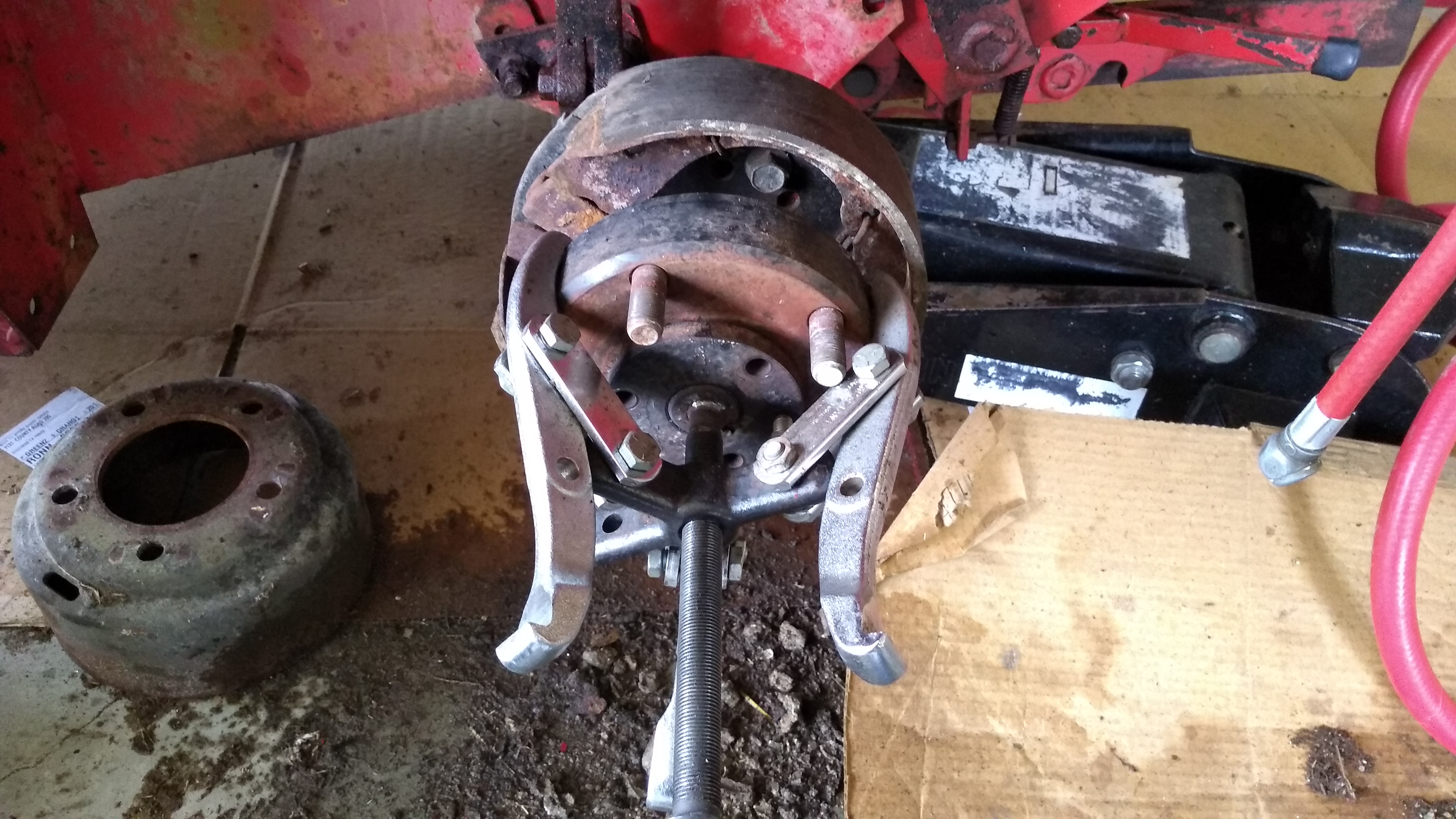

The electric PTO was hard to get to, due to rusted bolts that are hard to get at. It was not turning on when I had it running. I had to use my pneumatic air chisel hammer to get the PTO off.
You have to remove the front black plate with the slots, and then you have to remove another plate that runs horizontally in front of the PTO.
I'm glad these things are built with serviceable, commercial grade components...because getting at them is a pain in the neck. You would think after being in production this long, they would have streamlined ease of service. The fact that there are no service manuals, nor many videos or how to's doesn't help.
