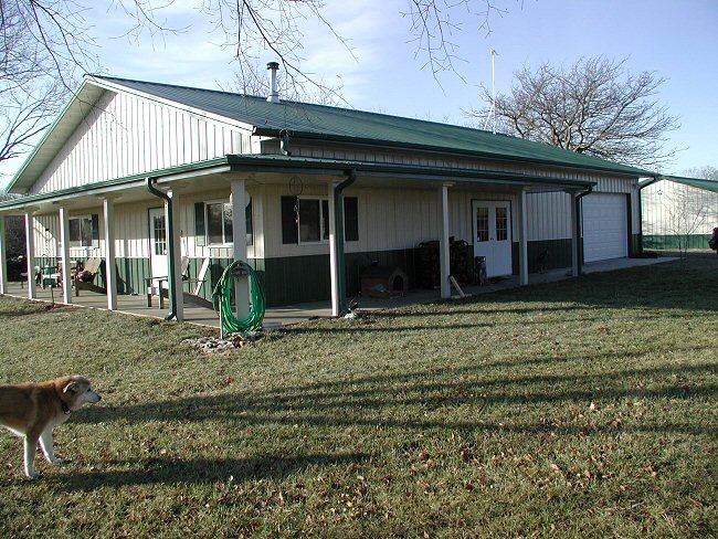

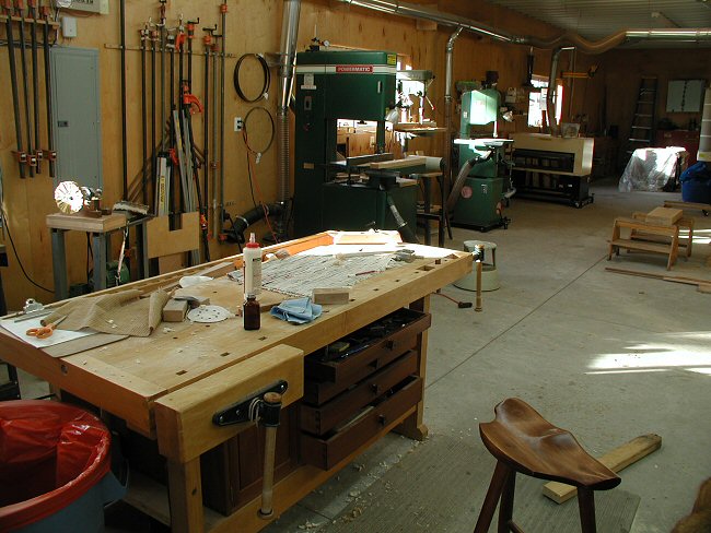

I built a 40 X 60 shop about 100' from our house location. All of the power comes first to the shop, then underground to the house. I wanted the meter and all the power company stuff on the shop building, not the house - strictly an aesthetic decision. I have one meter for both the shop (I'm a furniture maker) and the house. I installed 3 different conduit connections between the house - one for power, one for phone, computers etc., and one still unused for who knows what. The capacity was cheap to install during construction. The aesthetics aspect is kind of my thinking too.
One feature of my shop, a wood framed, steel sided structure, is that I framed between the posts to allow the structure to be sheeted with 3/4 plywood. I used blown-in insulation ("bib system") which is 7" thick. The posts are 5 1/2", the horizontal purlins (maybe not the right term - girts) that hang the steel are 1 1/2 thick, so together they permitted 7" of insulation. The plywood sheeting makes the structure incredibly rigid. The blown insulation puts a little pressure on the steel, so the net result is that the building is rigid, tight, and unbelievably quiet. One of the reasons I'm leaning towards a metal building is to minimize flammability in the structure since welding and grinding sparks are planned to be a regular part of my activities out there. What little wood hacking I do is essentially to make temporary fixtures or mockups.[/quote]

I have considered the same setup as your shop. Although the 3/4 ply is expensive for an interior finish it adds greatly to the structural integrity of the building and allows almost anything to be attached inside.
Did you blow in insulation in lifts as you added layers of Ply? Also wondered if you added a moisture barrier to the outside before blowing insulation? Sounds like a nice place to work.
MarkV
Mark,
I found bunks of birch veneer ply at HD for $27 per sheet. The cost (.84/sq.ft.) was hardly any more than finishing sheetrock. The plywood also allows me to hang up stuff on the walls anywhere without hunting for studs.
The "bib" system I refered to uses a fine grid nylon netting which is stapled to the inside surface of the framing. The insulation is blown in by sticking a tube through the mesh at the top of each cavity and blowing the insulation into the cavity. I did not use a vapor barrier.
Rick
