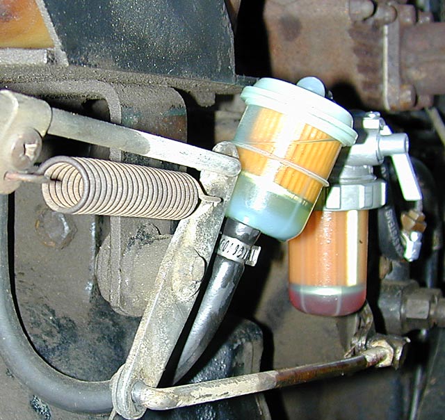

Here's what my true-blue American Yanmar came with, straight from a True-Blue (firefighter, even!) American farmer.
First, I didn't get a picture of the 'original' fuel filter because I replaced it immediately. But this is a replica of what I found on it:
I soon got manuals and realized that wasn't right, so I ordered a "Yanmar Diesel Fuel Filter, Bowl and Mount" [exact title of the ebay auction] from Corriher Implement Co., a true-blue American tractor dealer.
(I ran double filters for a while until I sorted out a rubbish-in-the-fuel problem. I think the American Farmer gave me a tank of pre-1993 high sulphur diesel judging by the nauseating exhaust stink.)
Ok, still not right. That "Yanmar Diesel Fuel Filter, Bowl and Mount" won't accept yanmar filter elements.
So I went to the local VN importer and watched them strip a filter assembly off a YM2000.
Dang. still not right. I bought a fresh OEM filter element and realized I still needed a bowl to replace the unknown one that was on the VN refurb. Back to another ebay auction.
This sequence was a nuisance, but not expensive. Under $50 overall.
In summary - I got about the same level of 'service' from the good ol boy American sources as the VN importer. Buyer beware, I don't see any reason to consider those refurb importers as different from any other nonsupporting merchant. Just budget some money for post-sale setup of the refurbs same as if you are buying 30 year old anything.
