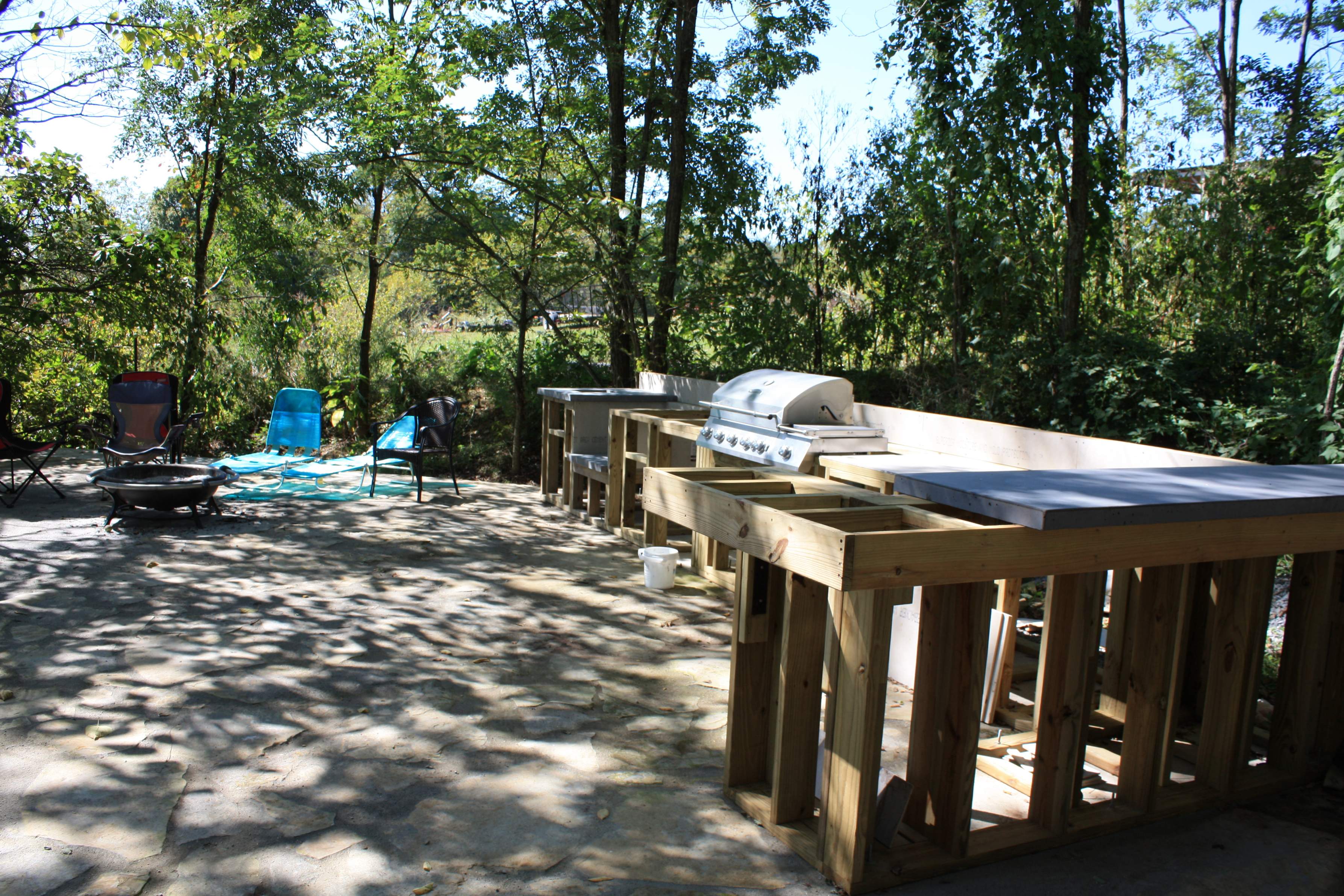

/ Outdoor Kitchen #84
One more question: What kind of grill did you get? Looks pretty nice, but you may want to consider using metal framing around it. Just a suggestion, they get pretty hot.
/ Outdoor Kitchen
#85
Coming right along Buggyman! Did you buy the angle grinder polishing set up for your counter tops? I had thought about doing concrete, but I'm not sure now. We saw granite for $39/sqft installed and may go that way. Looks good so far, thanks for the update.
Mark
I'm using my random orbit sander with the diamond pads and water.
/ Outdoor Kitchen
#86
The grill came from lowes, not sure of the brand. I couldn't justify paying 3 or 4 grand for the grill.

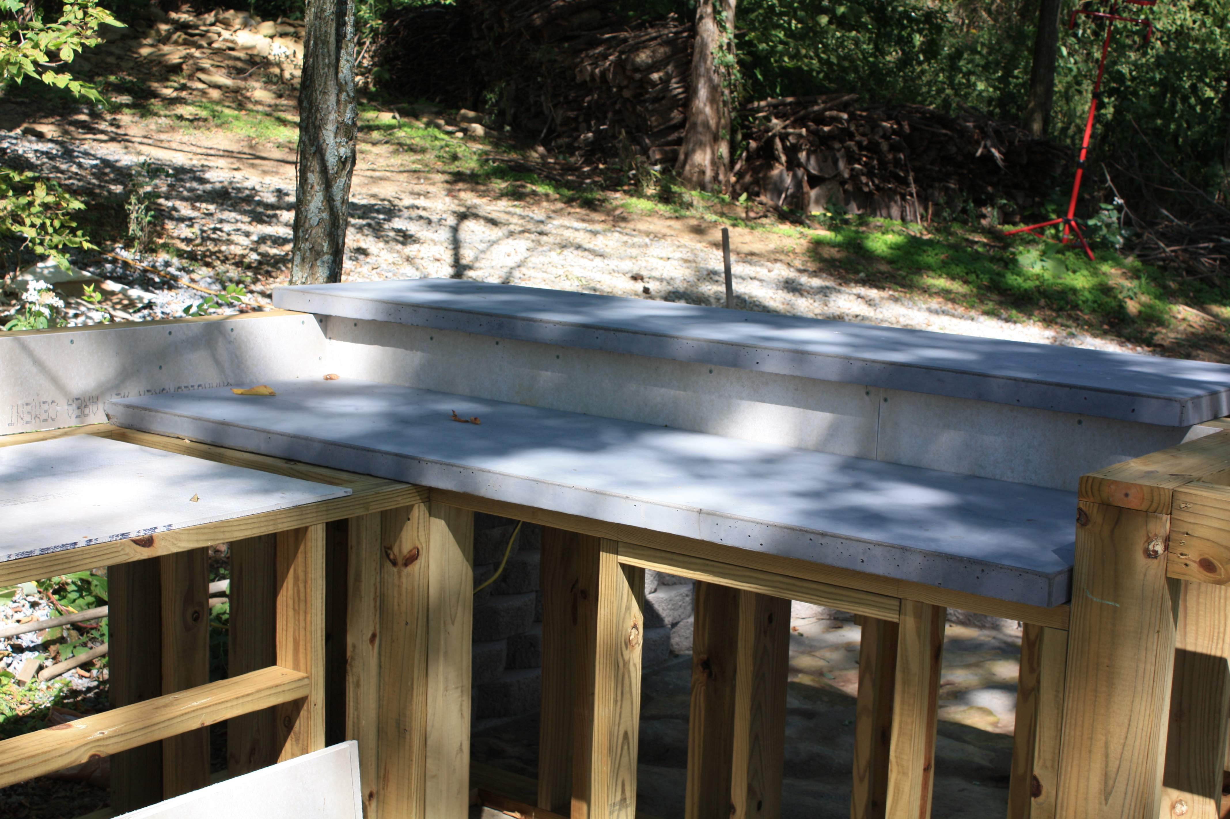

#95
Out of the molds: I think they turned out pretty good, i wish i'd put a thicker bead of caulk around the edges, and finished the bottoms better (forgot about the overhangs), and i still haven't seen the tops yet (they may be totaly screwed-up) , overall i'm happy how they look so far. I filed down the edges on the bottoms with just a hand file to keep them from chipping out. Be careful with this, it's a knuckle getter.
/ Outdoor Kitchen
#96
The more you vibrate the better when pouring. These have a lot less pin-holes than the first ones. I even vibrated the sides of the molds this time, and i think it helped a lot. Now comes the fun part...putting them in place.

/ Outdoor Kitchen #99
Thanks for the update
/ Outdoor Kitchen
#100
Is this the backside (unseen) or the topside??? How will you fill in the pin holes and them match???
I would like to do these for inside the house if they work our for you.
Chris
Yes, you're looking at the bottoms. The top side's are facing down against the melamine, they come out perfectly flat. When you flip them over you have almost a perfect top (and sides). I'm going to mix-up a slurry to fill the pin-holes (i'm using the quikrete mix and color, and just pouring it through a screen). Kinda do it like drywall, or wood putty and screed it off with a wide puddy knife, filling the holes, let dry, and then start with 400 grit, sand, and work your way up (im sanding to 1500 grit). You may have to do this a couple of times to get a good finish.
