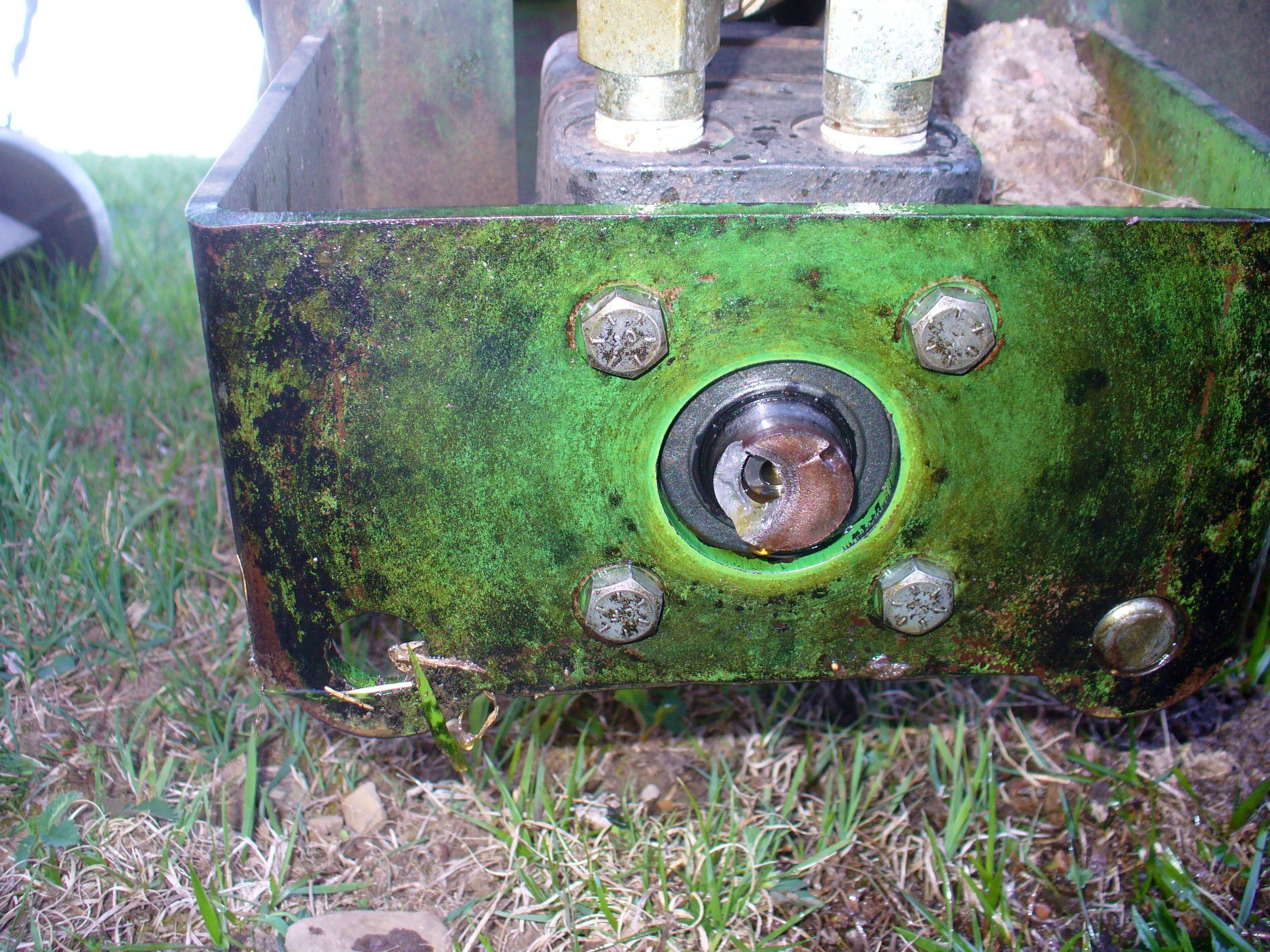

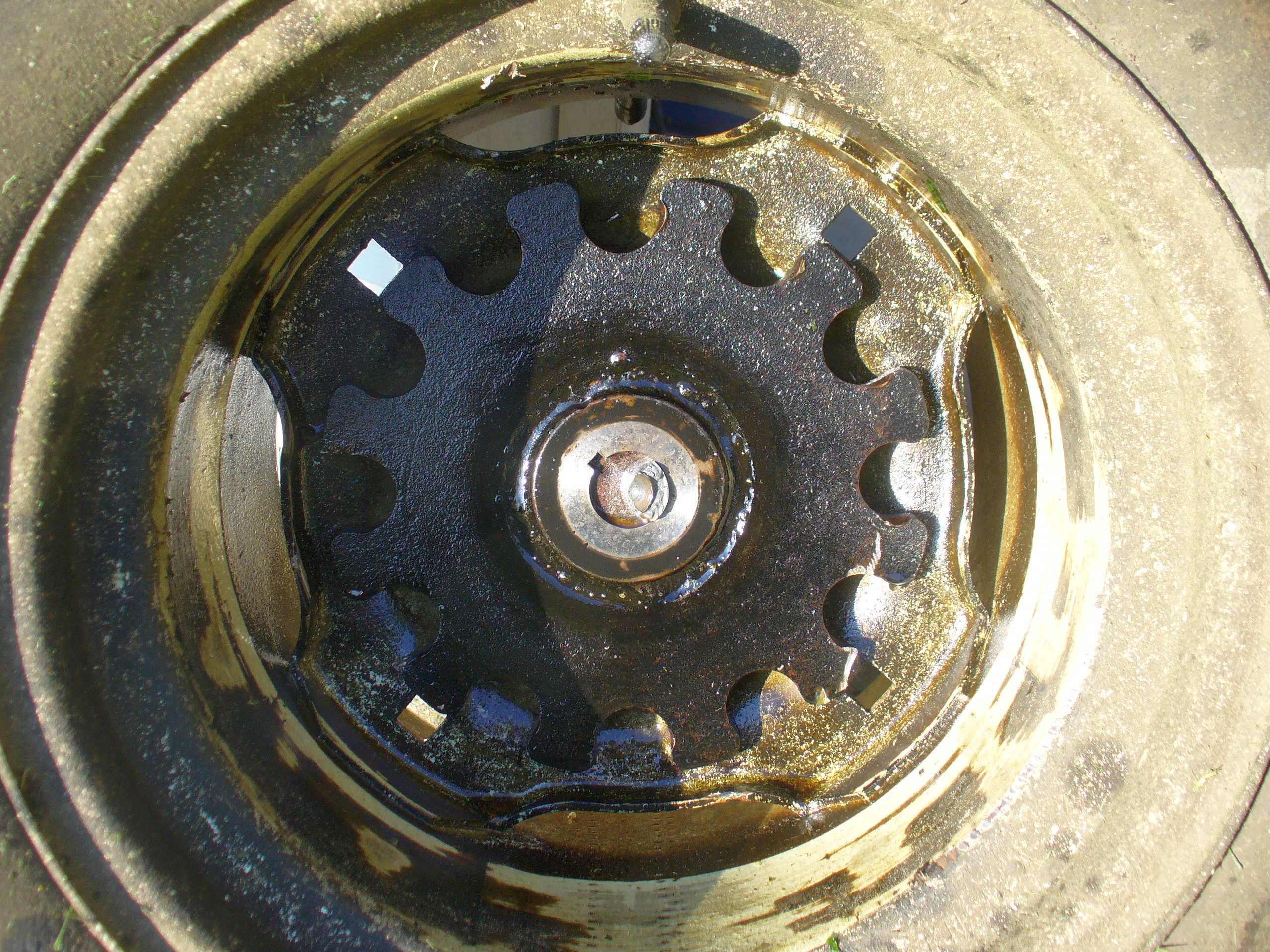

   / Overheated Robin EH72-FI (28 hp) in PT-425 solved #112
What kind of stress did you put on that motor shaft?
Your two options are .
Rebuild the motor with new shaft.
Replace with new motor.
   / Overheated Robin EH72-FI (28 hp) in PT-425 solved #113
Nothing out of the usual. I do run it on a lot of sloped/hillside areas(it sits now precariously on a hillside) and make turns on that would stress the shaft, but I thought the PT should be able to handle that. I'll probably be calling Terry to order a new motor and when I have time look at rebuilding the old one. Any resources/step by step instructions to rebuild would be appreciated.
   / Overheated Robin EH72-FI (28 hp) in PT-425 solved #114
Well, good news(sorta)....instead of buying a new pump Terry in Tazewell will put in a new shaft and rebuild for considerably less...just means more down time waiting for it to come back. He also suggest I get an impact wrench to get it back onto the shaft...said hand tightening the nut will not be good enough....I've been meaning to buy one anyhow.
