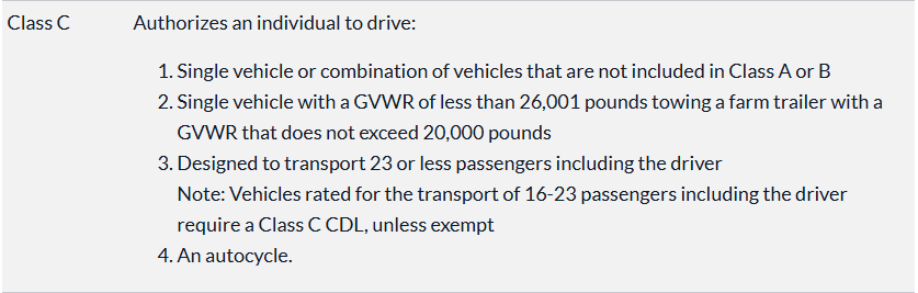

I am legal. Texas allows for hauling a 20,000# GVWR trailer with farm plates with a Class C license. All three of my 15,900# GVWR trailers have farm plates.
Classes of Driver Licenses | Department of Public Safety

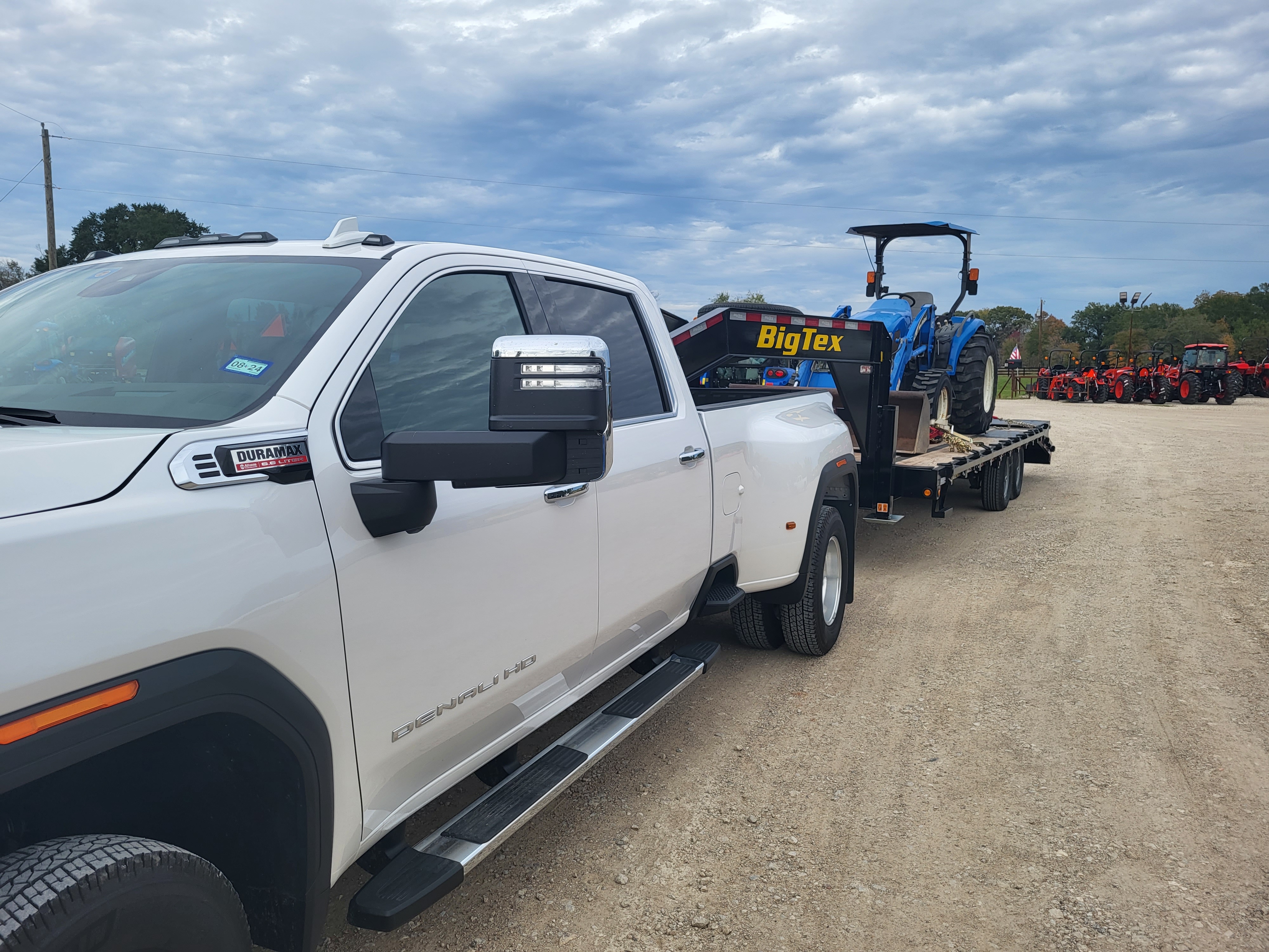

I'm fortunate that here a basic license allows me to max out my 3500 (14,000 GVWR) and trailer (25,000 GVWR).
Most of my trailering miles are out of state, went through three states to get the pictured machinery (about 16,000 lbs.) and I have yet to be hassled by any cops or scales. Not that I stop at them.
For the most part both the 3500 and trailer are overkill, but I much prefer it that way.

Nice rig! A pleasure to tow with no doubt.

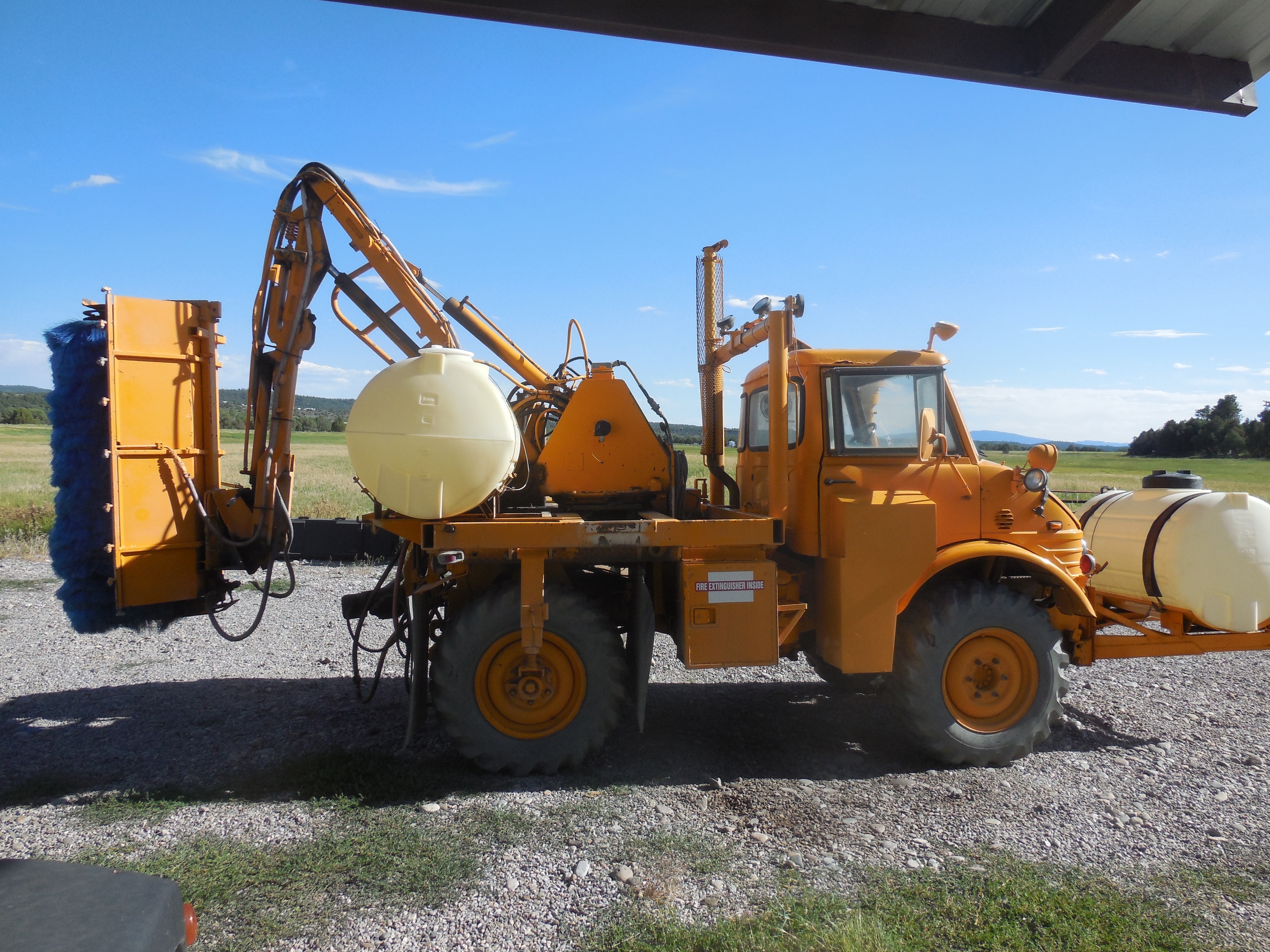

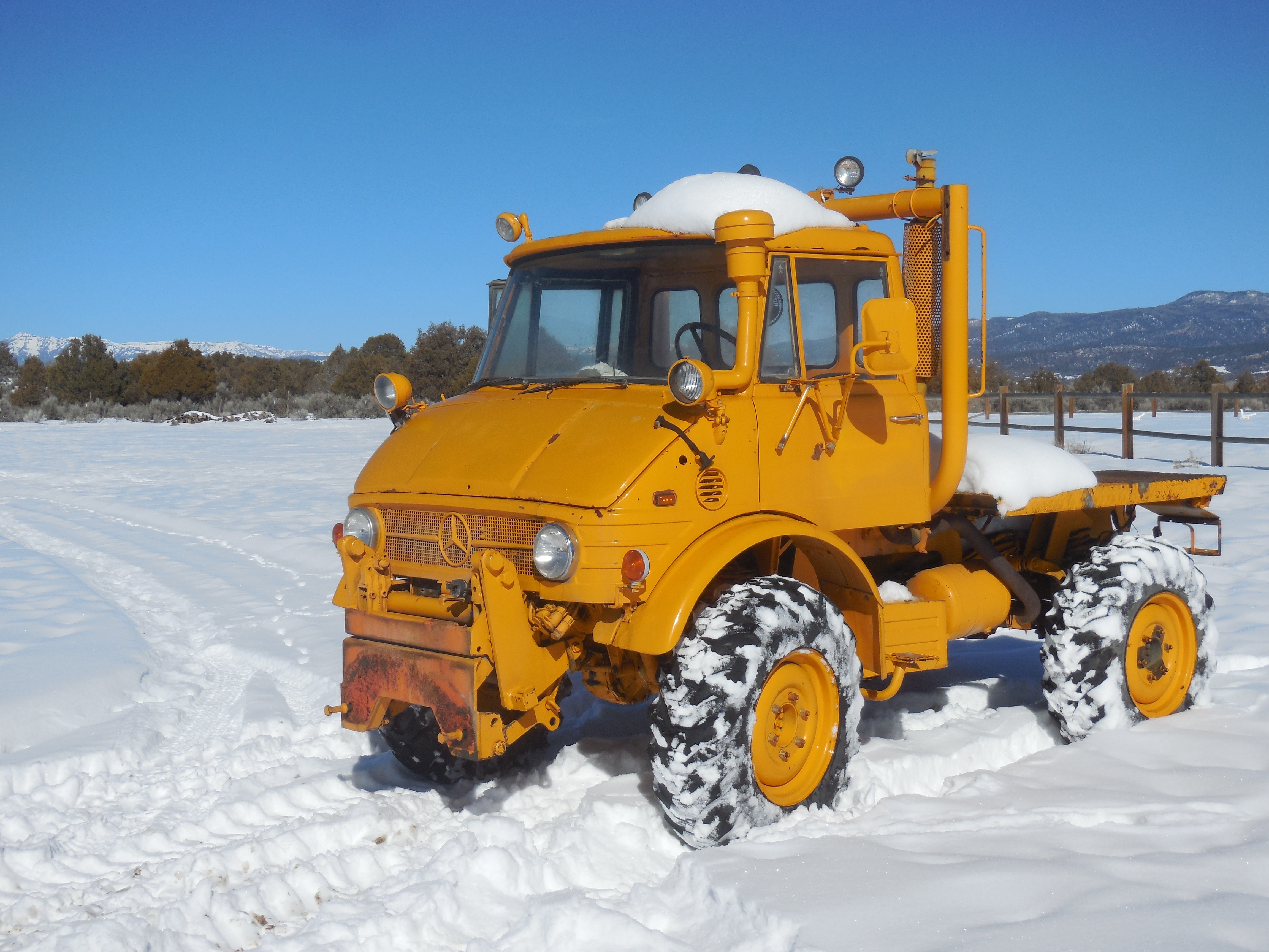

Nice equipment. What is that? A Unimog with some sort of bush scrubbing attachment?
   / Owning a new(er) tractor that's too heavy to haul with your pickup? #37
Yep, you got it.
I didn't even know there was such a thing as a tunnel washer until I ended up owning one (kind of a long story).
The original idea was to run the snowblower off of it since it has front and rear PTOs and hydraulics (and the 2,000:1 lower gearing), but once I figured the washer part out I wanted to put a flail mower on there instead of the brush.
Well, that would've likely worked well, but required a second person to operate.
Removed all the washer stuff (do you want it?), then ended up selling the Unimog.
That 32' trailer is for sale by the way. Bought a 35-footer, also with hydraulic dove tail, air suspension, and disc brakes.

That 32' trailer is for sale by the way. Bought a 35-footer, also with hydraulic dove tail, air suspension, and disc brakes. View attachment 978800View attachment 978801
It's a shame you couldn't make the mower work. That would have been a sight to see.
I have no need for such a device but that giant arm with the brush really remind me of this kids classic!
   / Owning a new(er) tractor that's too heavy to haul with your pickup? #39
Oh, I probably could have, but it'd been a bit costly and work intensive.
As delivered, all the hydraulics are operated through switches and would've had to be converted to valves, so I could adjust at least the height of the mover with some precision. The ground next to my ditches isn't exactly smooth and consistent, and that's where it would've been useful.
Also, a hydraulic flail mower would've cost more than I paid for that Unimog.
