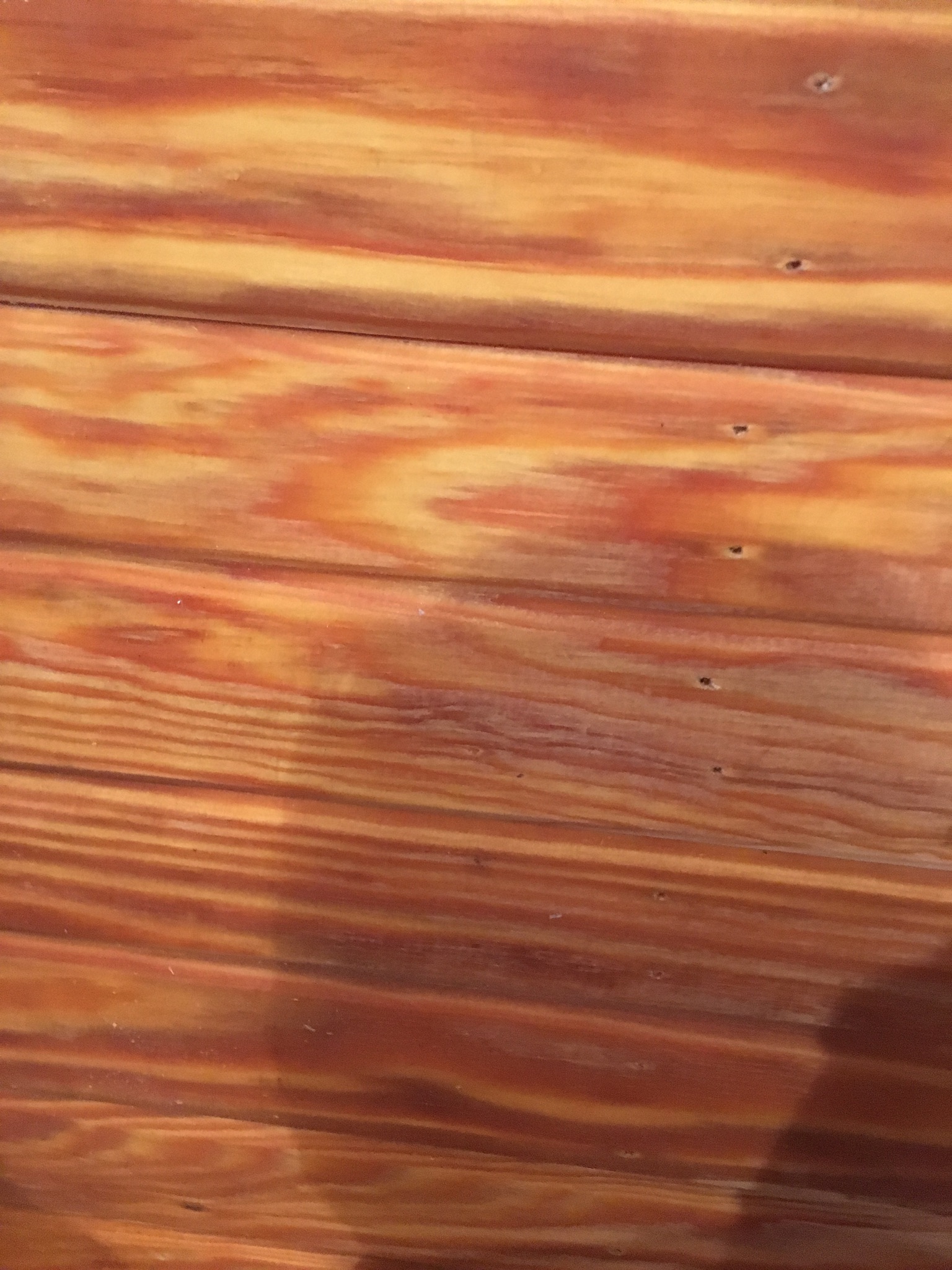

Anyone have any pics of the linseed/mineral spirits on a trailer deck, curious as to how it would look
   / Paint trailer deck #17
Not a trailer deck but some unfinished pine for a door I am building.
I didn’t brush it on or spray it. I set the boards down in a bucket and let them absorb the linseed/turpitine through the end grain.
