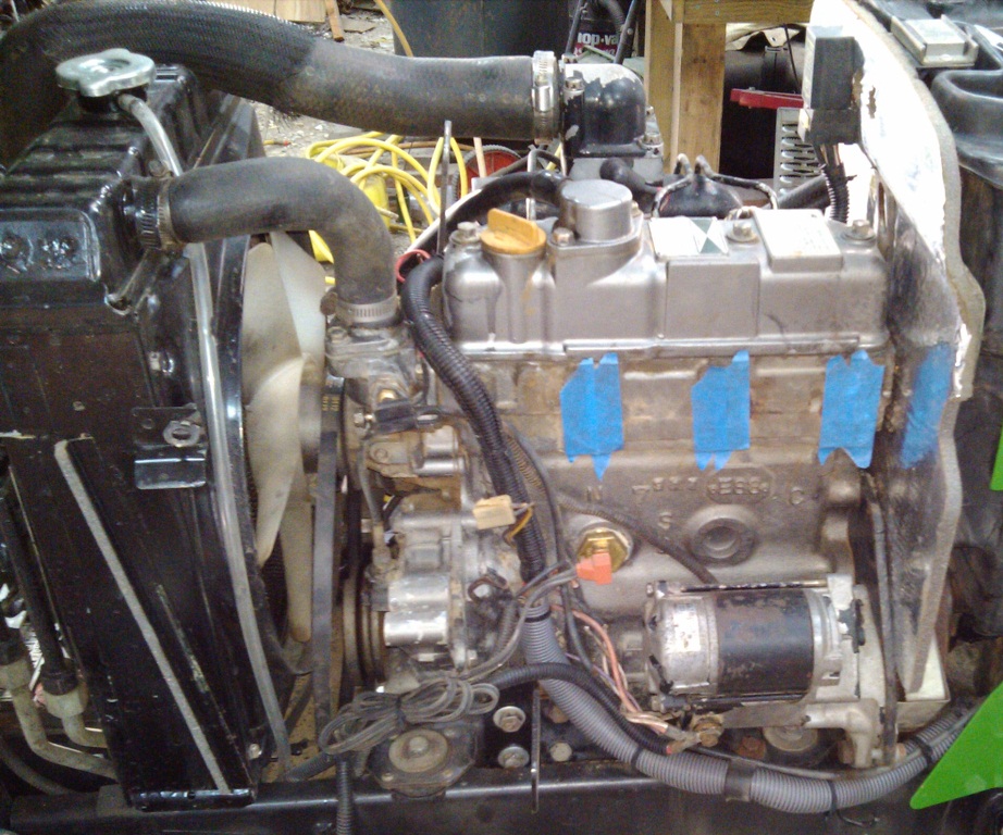

Seems like every time I want to get started tearing into the engine, something comes up. Now that the days are so short, it's usually dark by the time I get home from work and the lighting in my barn was virtually non-existant. So, I used the three-day weekend to remedy that problem and put up six 4-bulb, 4-foot flourescent light fixtures with T-8 6500K "Daylight" bulbs. I have six more to put up to finish out lighting the barn, but the six that I did get up fully light the area that I'll be working in to overhaul the engine. After running conduit, pullling wire and installing the fixtures.... that's about eleventy gillion trips up and down the ladder. The barn has a 14' ceiling and I had to do it all from a single extension ladder. My back is killing me and my legs are on fire, but I have light to work in now.
I did move the tractor into the area and began my initial investigation. I started by pulling the exhaust manifold and altenator to get a better look at things. I thought I'd pull the head off and look around on the off-chance that the repair could be done in-frame. Looks like the water pump has to come off in order to pull the head, so I'll have to remove the hood, core support and raditor before I can get the head off. I decided that my back was sore enough and I'd had enough for the day, so that's as for as I got.
BTW... that pic was taken without a flash, inside the barn, with the doors shut. Just to give you an idea of the lighting.

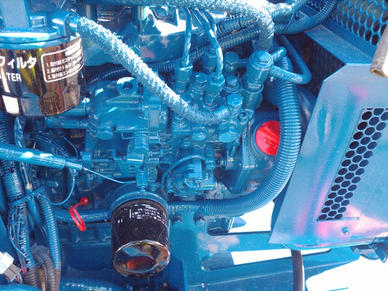

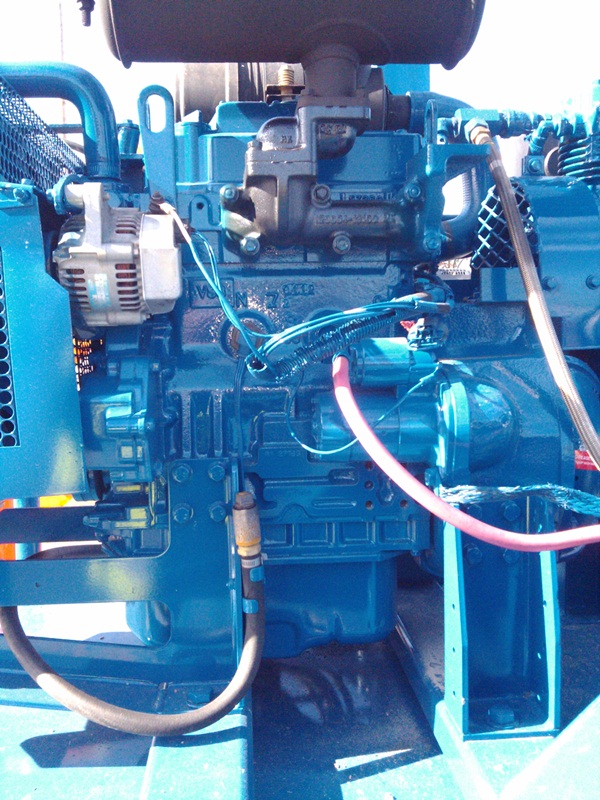

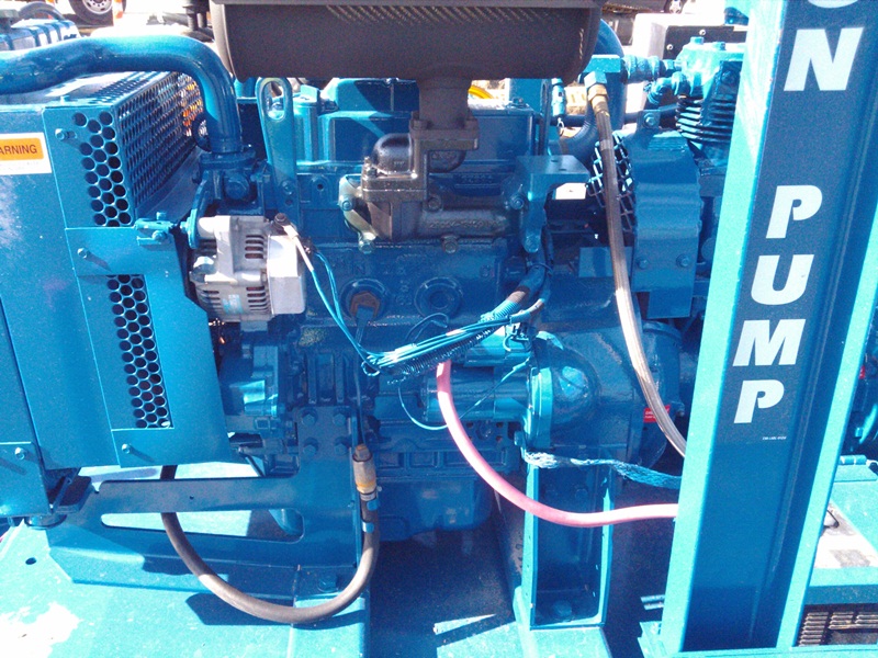

I pulled up on a jobsite this morning and there was a brand new shiny 4" pump powered by a brand new shiny 3TNV88. Now that's just rubbing it in... :laughing:
The V series replaced the E series but is virtually unchanged in physical dimensions. The V series has a stiffer crank, stiffer rods, tighter tolerances, updated combustion chamber and a distributor type rotary injection pump instead of the inline injection pump the E series used. Swap the intake and exhaust manifolds and a few other bolt on parts and it would bolt straight into my 955. I offered to "return" the pump to the rental company, but rep declined. :laughing:
