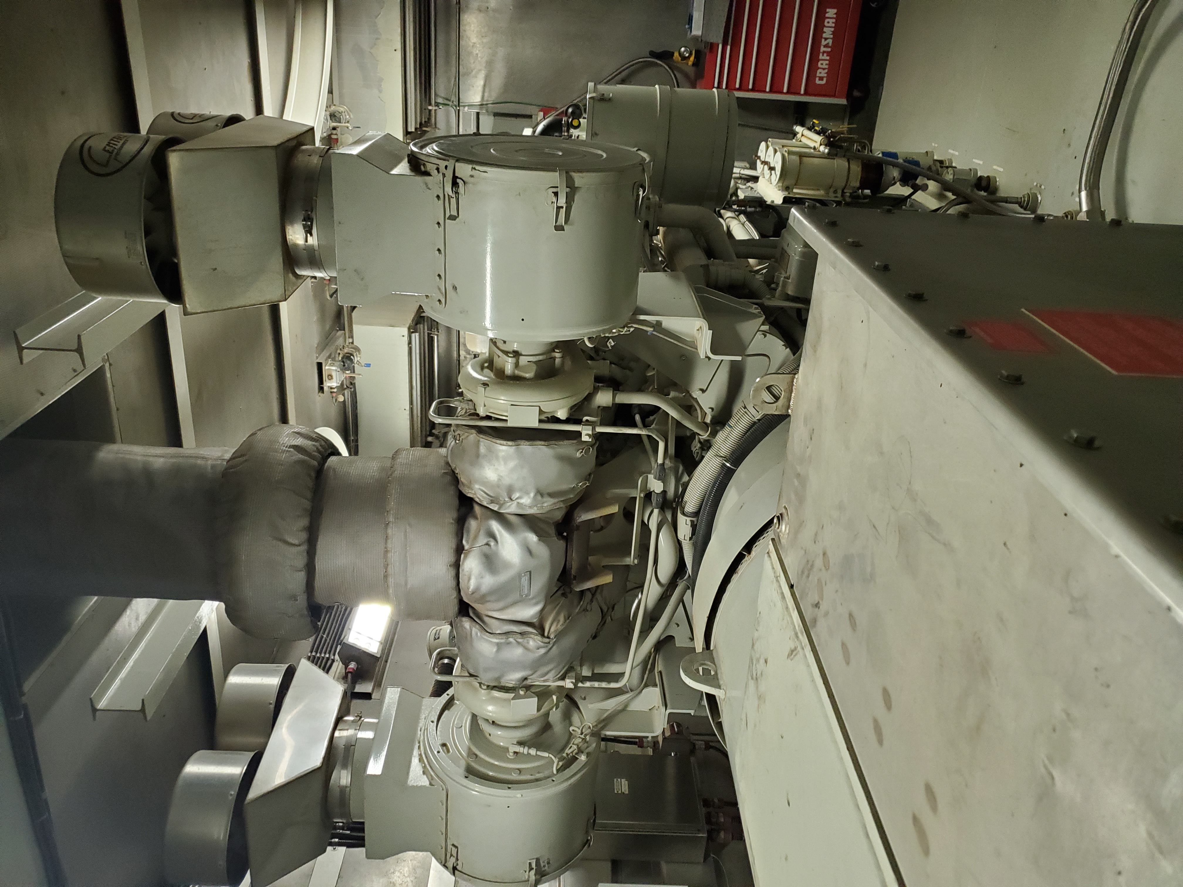

Not trying to talk hate just facts. Apparently if someone has something that does not go in line with what you assume then its hate. I deal in facts not ********

Here is one of the little diesel's we work on dailyView attachment 644516
I only worked on Diesel Perdormance and emissions for thirty five years, in product development engineering for a Diesel engine manufacturer, so what do I know?
Yes, there were some teething problems, but a properly functioning DPF is relatively seamless, and raises back pressure an inconsequential amount.
   / Particulate filter delete #159
Apparently part of what you do not know is what happens to these engineering marvels in real world conditions.
