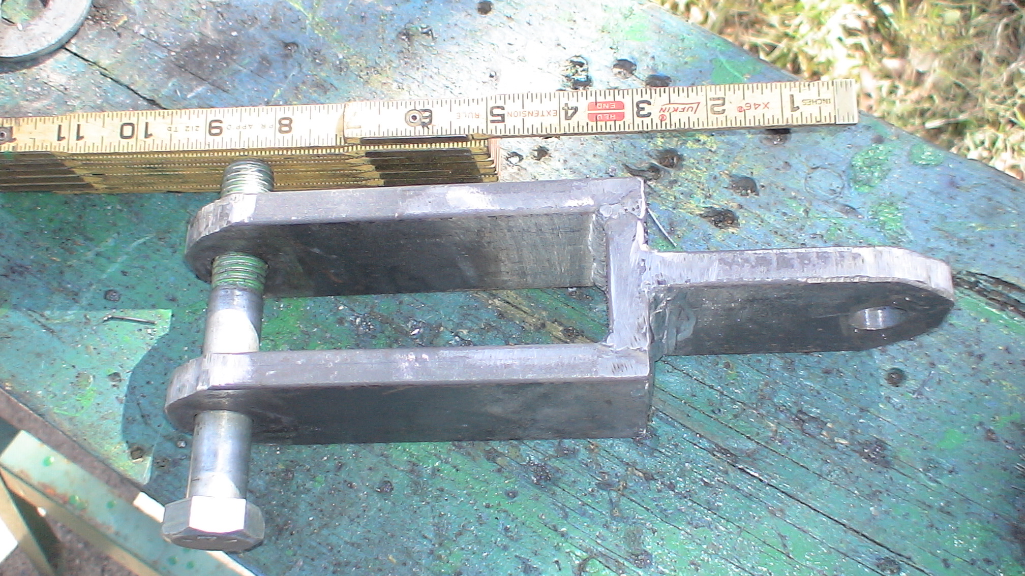

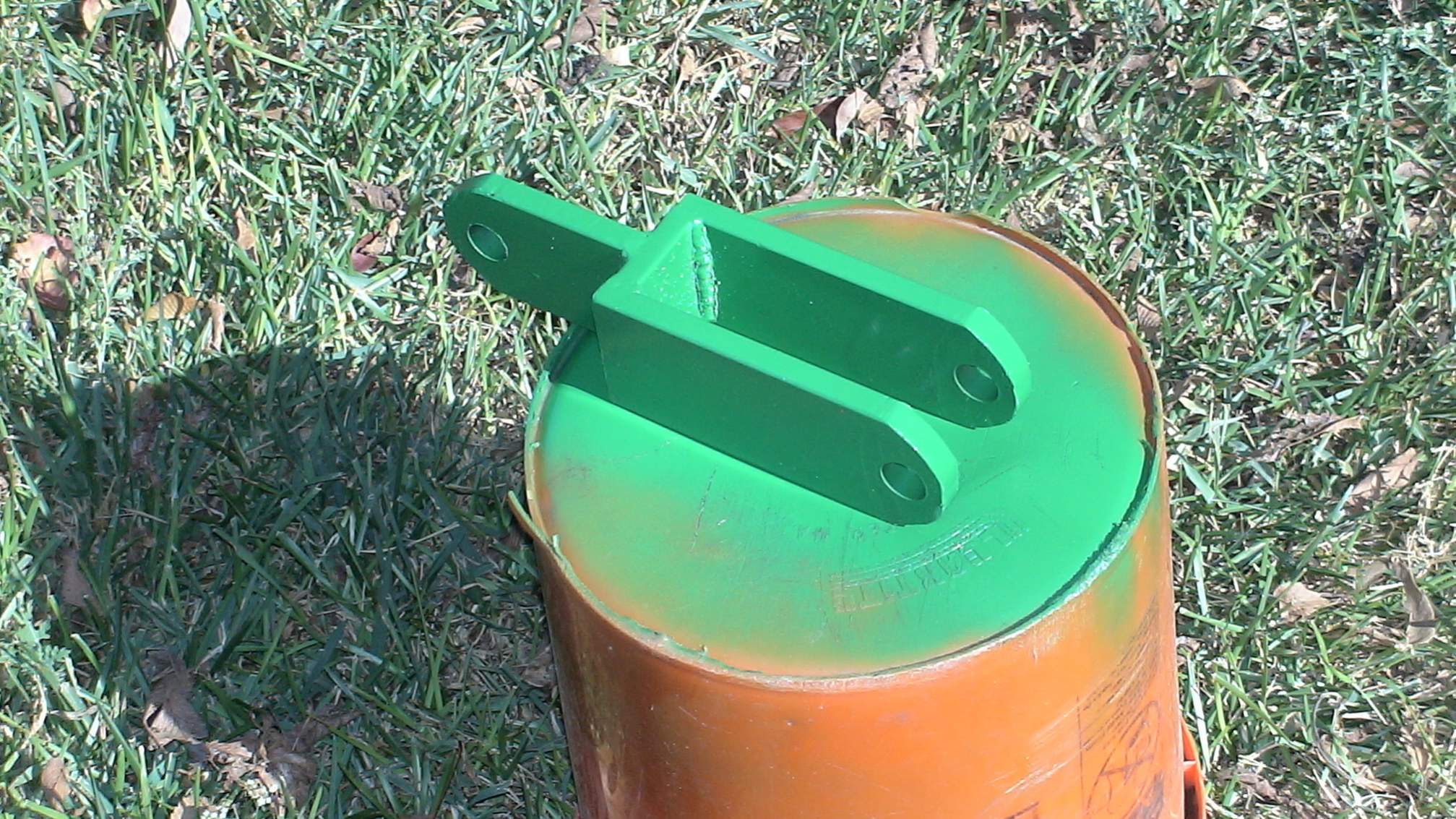

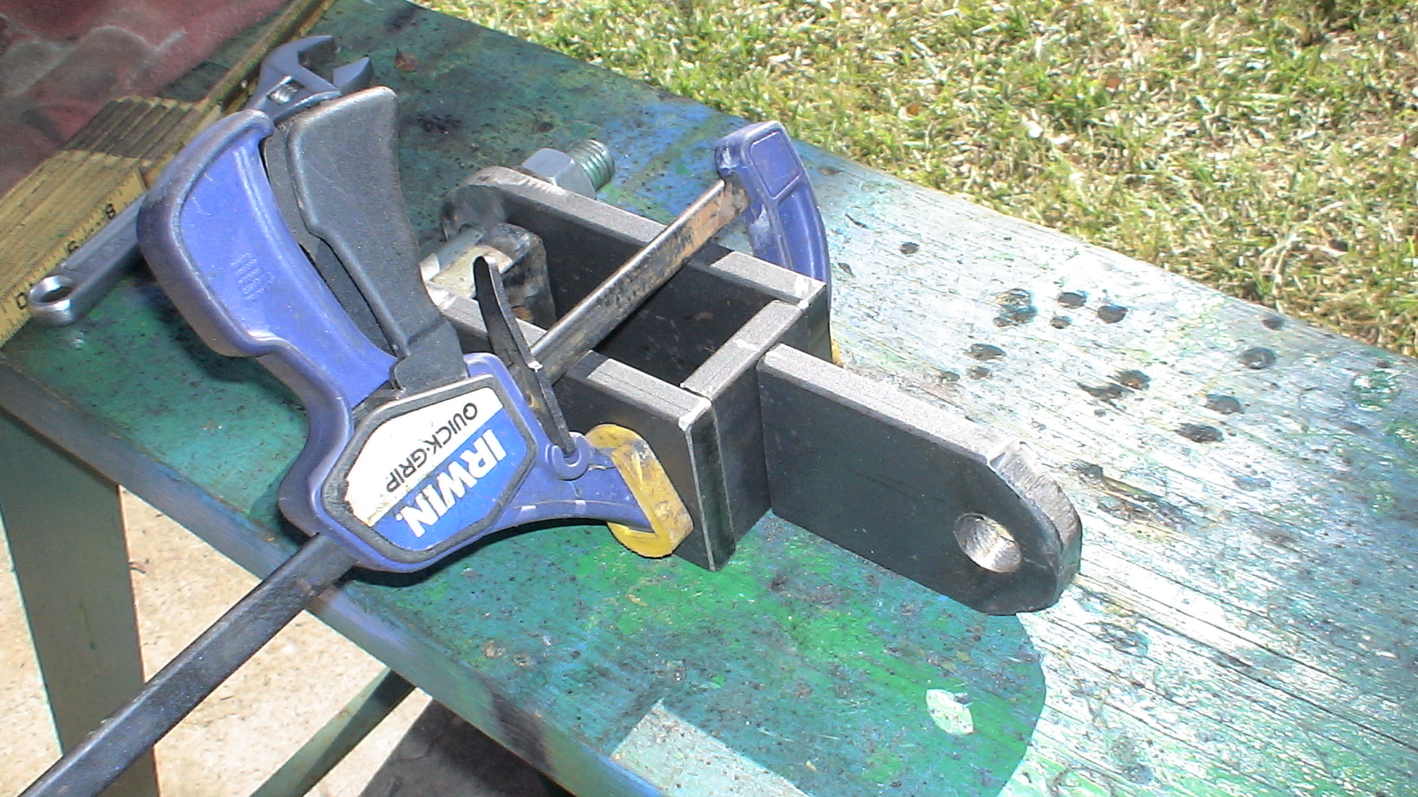

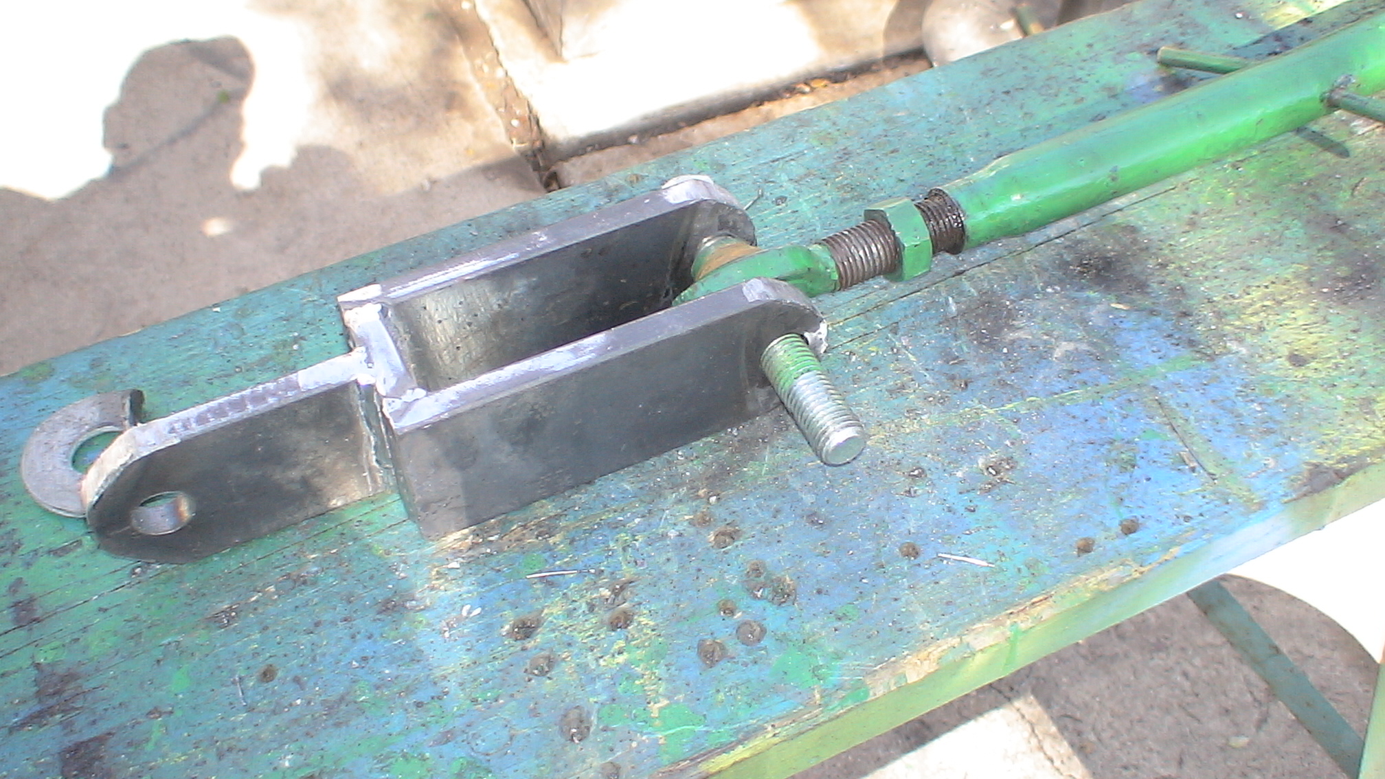

Facts are that Pats extends the lower arms a little bit, thus if you leave the top link the same length, an implement will no longer be level.
solution is to lengthen the top link to again level the implement.
Sometimes, the amount of additional length needed, just a few inches, exceeds what the existing top link can do.
solution is to obtain a different top link which is longer.
Or, to craft an extension to the existing top link...requires some metal cutting/welding perhaps, depending on how one designs the extension.
if you have a hydraulic top link (I do) then perhaps there is no problem, just extend it hydraulically. However, if the max extension is insufficient, then either craft an extender (I did) to the top link connection, or get a different hydraulic cylinder with more reach.
Net, many people are able to use their existing top link, lengthen it and just add PATS system. Others need to make an adjustment or obtain a longer top link...just depends.

One final note is that I experienced the same thing I had read about on TBN with my top link being too short on some attachments due to Pat's easy-change system moving the connection point about 4" farther back. Yesterday I bought at Tractor Supply Company a longer top link that should fix this problem. I don't yet know if the PTO drive shaft is long enough on every PTO-driven attachment after the attachment is moved back this 4".
