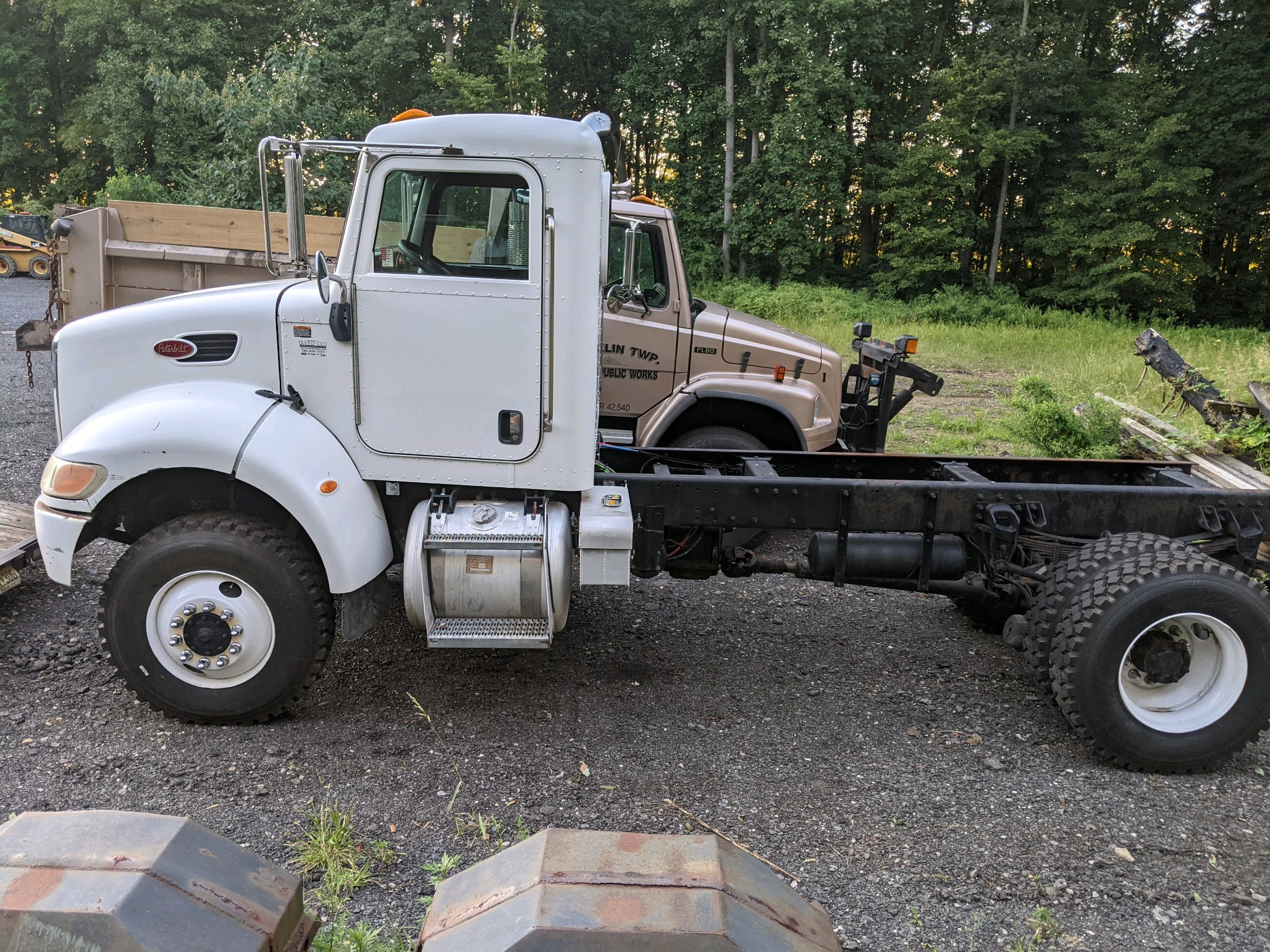

Found a really sweet 2009 Pete 335 4WD with a Paccar PX8 (8.3L Cummins), Allison 3000 and air brakes. 33,000 GVWR. Has air to rear. 10/23 axles.
However, it only has 12’ of frame and 108” cab to axle. Makes a 16’ flatbed kinda tough. Ideally should be 120” cab to axle for 16’ flatbed.
I really like this truck, but sliding the axle back a door is pricey. Body installer says ”it‘ll be ok”, but as I told him, I want to pull a 10 ton hay trailer behind it and 6 ton hay on the bed (square bales).
Thoughts?

You should stretch it out so it makes it safe to haul or tow what you intend do.
Just depends on whether you want to do it the right way or not.
If you stretch it out, you will probably have to add a midship bearing and make a two piece driveshaft.

/ Pete 335
Pic

It would be spendy to move the rear axle back, double the frame, lengthen driveshaft, lines, etc.
I cant even find a 4wd thats longer and spec'd out this way.
But this truck is twice the truck of an F-550 4x4 for 1/2 the cost.

I could also add an air lift axle behind the rear axle. That would increase my GVWR, allow 16' body with no overhang and increase available tongue weight for towing. Shorter than 16’ is not an option. Adds cost, too!

Adding frame and air lift axle gets me close to the cost of a tandem 6x6.
However, none of the 6x6s are Peterbilts and none have an 8.3L and all the features.
Most are IH with a DT466/530 or one of the junk MaxForce engines,or it’s a Freightliner with a C7. Former digger Derrick trucks. Very underpowered and usually beat to death
