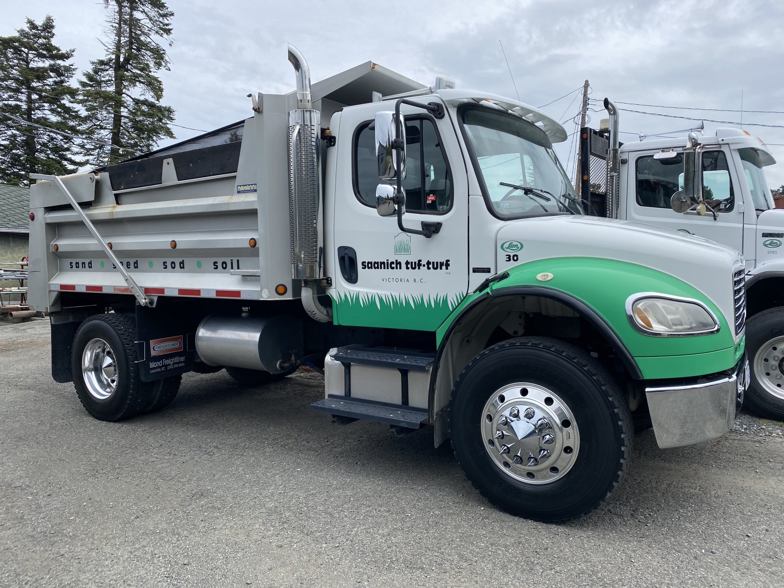

Here’s my 750 in it’s last gear. This is a 6 speed manual with a fixed rear. I wanted a different option than that but this truck checked every other box I wanted.
/ Pete 335 #30
You will be fine with the 10speed.
My single axle Freightliner had the 330HP MB engine with 8LL and it was fine.
I did the opposite of you. I SHORTENED the wheelbase. LOL.
