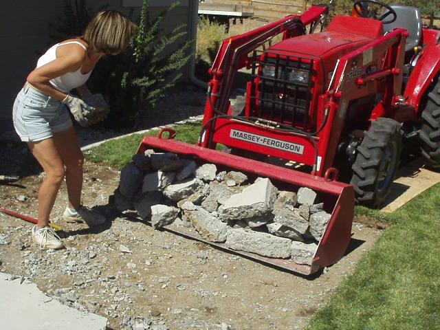

The 'L' style bucket in action, easier to fill than the 'C' type but as can be seen gotta be carful to correct loader leveling when its raised with a full load to prevent dropping part of the load on that pretty hood. /forums/images/graemlins/shocked.gif

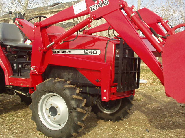

Last one, a side view. Not really shown is the operator platform. On this model its open and flat, pros of that is of course more room and easier on the legs, negative on this model is its harder to remove for service.

Now as for your comments that could loosely be defined as "opinion" there are people reading this thread that don't like opinions, so please keep those to yourself /forums/images/graemlins/wink.gif For example, I would never point out anything like the "L" shaped bucket: <font color="red"> easier to fill than the 'C' type but as can be seen gotta be carful to correct loader leveling when its raised with a full load to prevent dropping part of the load on that pretty hood. </font> and that sure is a pretty red hood so those rocks your "assistant" is loading into the "L" shaped bucket need to stay inside that bucket.

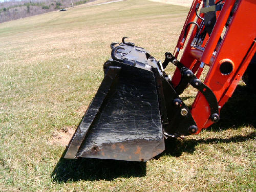

A few pictures of a Kioti DK 35.
Side of bucket. Bucket is quick attach type, C-shaped, heavy duty.
