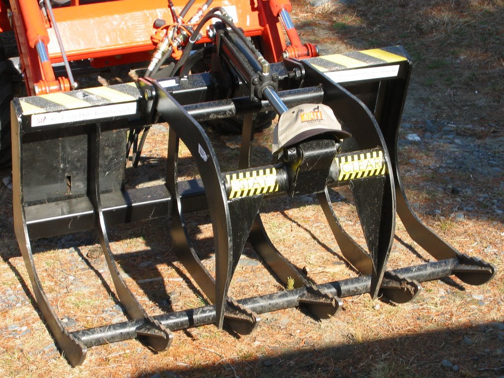

My grapple is now suposed to be in monday. I was wondering by those who have and use them--- can lifting objects off center that would offer a huge twisting force cause problems for the loader? I'm wanting to lift logs for cutting and will obviously be grapping them other than the center of gravity even if I try otherwise. To state otherwise,can I damage the loader with a heavy load off center.
/ Piranha Root Grapple #52
wkpoor said:
My grapple is now suposed to be in monday. I was wondering by those who have and use them--- can lifting objects off center that would offer a huge twisting force cause problems for the loader? I'm wanting to lift logs for cutting and will obviously be grapping them other than the center of gravity even if I try otherwise. To state otherwise, can I damage the loader with a heavy load off center.
I think the potential for loader damage is clear with heavy offset loads (e.g., large logs, concrete pipe, etc.) due to the high twisting moment that can be placed on the loader arms. That's why I always try to center my heaviest loads right along the axis of the tractor... even if that means taking a little more time to drag them out and into position where I can get a reasonably centered, balanced grip. In my case, I am also a bit concerned about the quick attach components which seem a bit light-duty for the work I'm doing and planning to do in the future.
Dougster
/ Piranha Root Grapple #53
I agree with Dougster, you should try to center loads-- Not only because it is less likely to damage the FEL, but also because it is dangerous to drive with a heavy off center load. Things get "tippy" real fast with a heavy off centered load in the grapple.
That doesn't mean you cannot put one edge of the grapple under a tree root to pop it out but you should probably not do that with something that doesn't "give" pretty readily. I can see the FEL twist sometimes when one side of the grapple is stuck on a root and it doesn't do any more damage than doing the same thing with a toothbar on a bucket but it is not what the FEL is engineered for so it's best to minimize that sort of asymmetric loading.
With a big root ball sometimes you need to center the heavy part and just let the rest hang out the front of the grapple.
