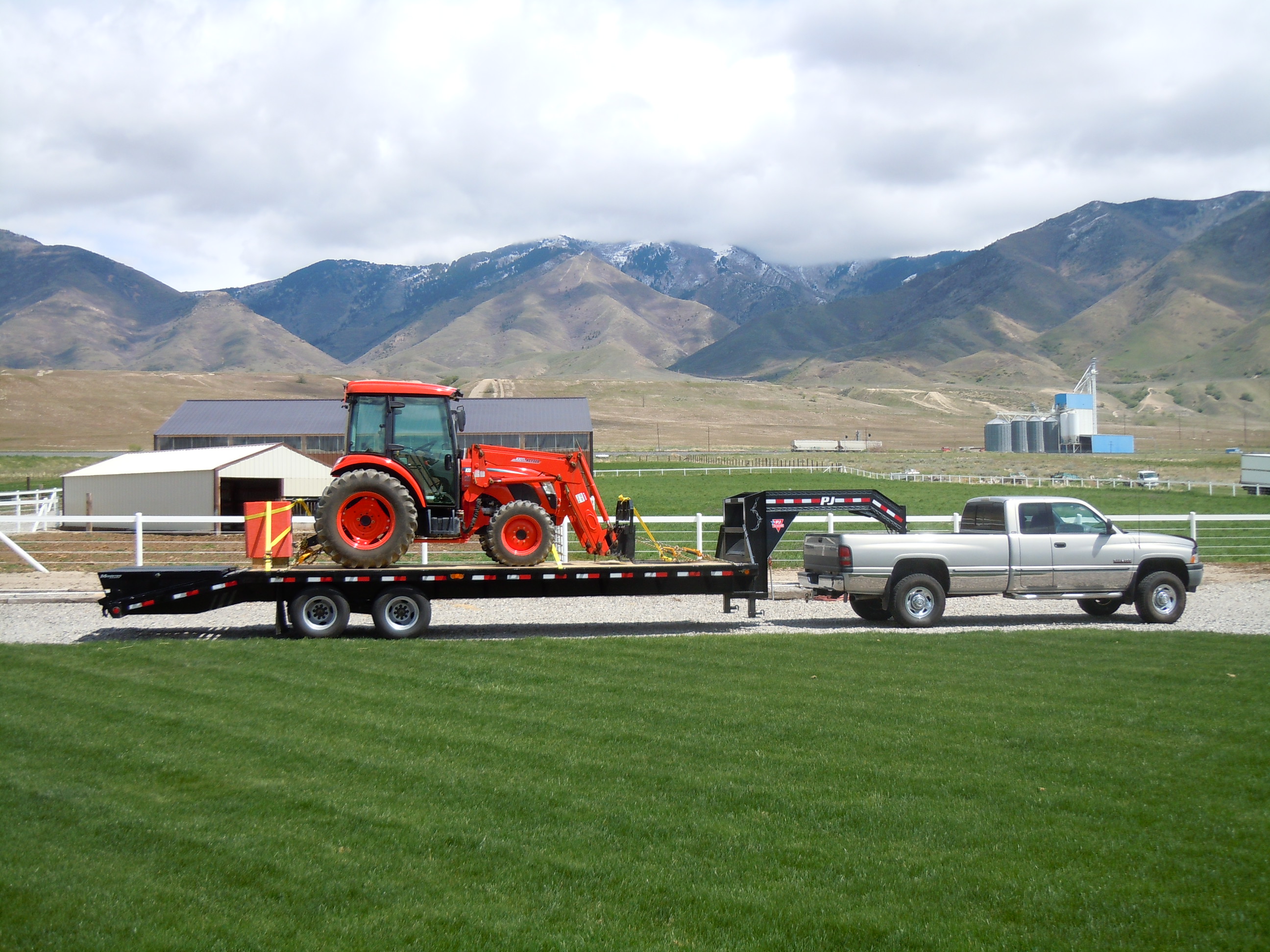

I tried to imagine my longest hauling length, and other potential needs and wants. I measured the tractor with FEL, added the length of a 6ft bush hog, and added a couple feet of leeway. After waying pros/cons for ramps I decided against flip up's in case they got in the way but now I'm im sorry for that as I do not like the slide in ramps. They do not stay secured when loading, they are too short, and of course heavy. This winter I'll fabricate a longer, adjustable flip-up ramp set with spring assist.
Here's my PJ 16,000lb GN 22ft+2ft beaver tail and tow rig:
And loaded with some gear:
