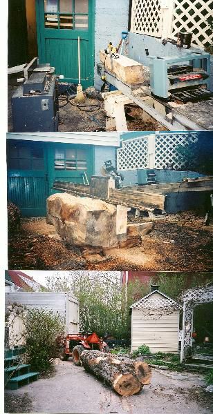

I have one of the cheapest portable planers, a Delta. 12 inches wide, two reversible blades. You do get snipe with it on the planed boards. Mine is set up so there is a six foot in feed and out feed table. It has planed many boards and has produced a lot of shavings. The drive pulley on it has required replacement.
For house building quantity lumber I'd recommend a commercial milling operation for cutting and finishing the logs to lumber. Constant thickness and square edges may be a problem for the "do it yourself" concept. Also the wider board edges may not be planable or it would be difficult to plane them.
For some portions of house building unplanned lumber may be used. " Code's"
Note: I very much enjoy planning lumber. For me it's fascinating.:D:D
Attached is a picture showing my planer set up. It may not look all that great but it does work.:)

I remember your setup, Egon, from previous posts. It does not matter what it looks like - results count:)
And infeed and outfeed table is almost as important as the planer itself.

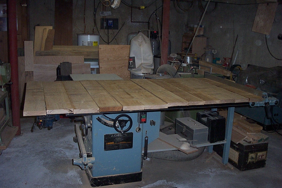

I pretty much agree with the advice the others have given you, the portable planers offer alot of bang for the buck but have their limitations ! I have been building furniture for years and when you get into the harder woods and thicker and heavier boards you need more HP and a good rigid machine ! I have a 15" Grizzly planer that I bought years ago and it served me well ! I built a white oak kitchen extension table a couple years back and that planer just breezed through that wood easily. The other piece of good of good advice was from Prokop about your infeed and outfeed tables, they are VERY important !
I would keep and eye open in your local classifieds, Craigslist and E-Bay. Something may pop up, but a real good piece of equipment wont come for free ! ;)
