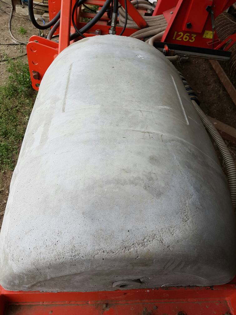

I made a couple of weights for my aerator from "readicrete" and they turned out a fair bit heavier than I calculated, unsure if that's relevant or not
I sprayed some detergent on the inside of the mold before pouring, and put some in each barrow I mixed, they turned out smooth enough. 20170221_150020.jpg
They are about 600 pounds each
Half of a plastic drum plus a 2" raised piece to locate the weight in the frame
