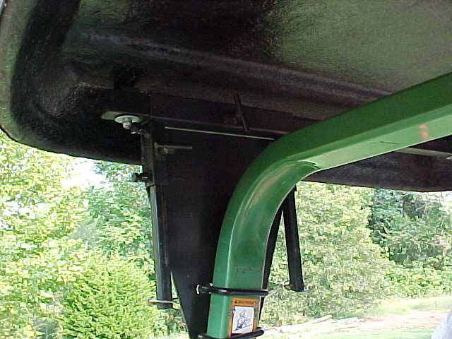

Hello Gary,
The slider/riser arrangement is mostly home-fabricated. The square tubing that attaches to the canopy, and the bracket that attaches to the ROPS are part of the Bucktop kit. The rest is scrapyard junk. Here is a shot from under the canopy.
OkieG

Here is a close-up underneath.
OkieG

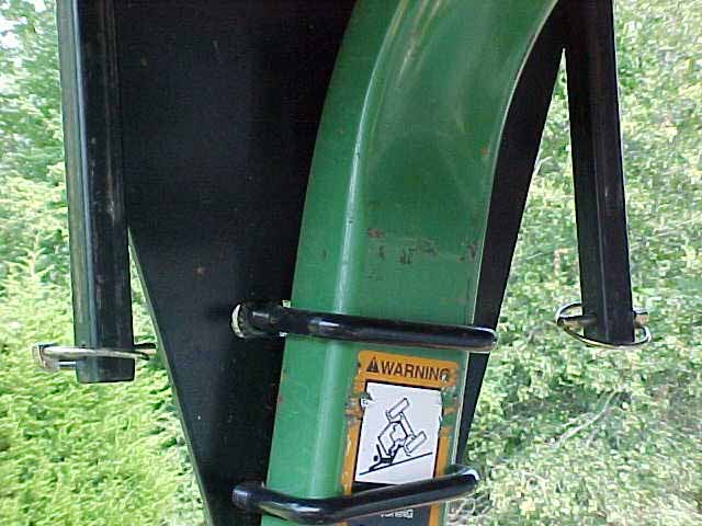

This is a shot of the riser pins that act as stops when the canopy is raised.
OkieG

Here are the lynch pins acting as stops with the risers raised.
OkieG

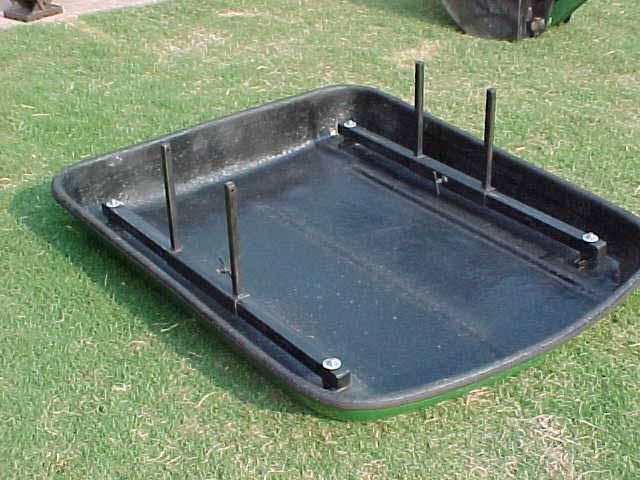

With the riser lynch pins removed, the canopy lifts out of the riser guides. Here is the canopy, top down, on the ground, after removal. All that's left on the tractor are the brackets, U-bolted to the ROPS.
OkieG
