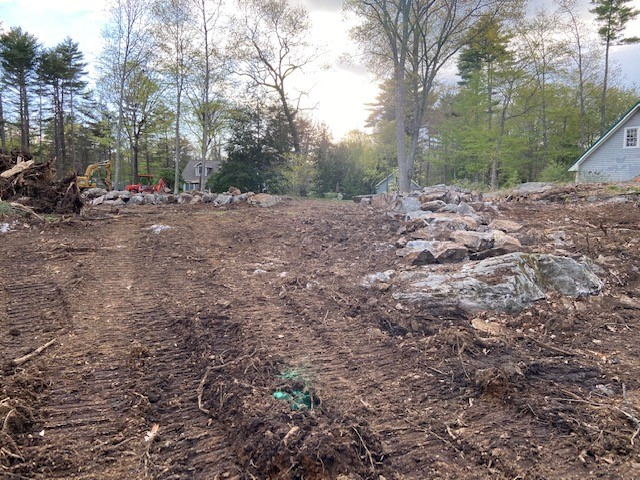

This is typical New England each 2x3' hole is 40% rocks 60% soil. Rocks are usually 5-18" and you can't plow or dig or use a spade, and a 3 PT PH digger is nearly useless with no down pressure. As Tony H stated go 2" into the ground and hit stones.
I had success with an 18" auger on a 3500LB Bobcat BT100 Tracked skidsteer with down pressure, then cleaned the holes out with my BH before planting. Still had to pick 4 yards of stone from 40 trees planted and use 8 yards of compost.
