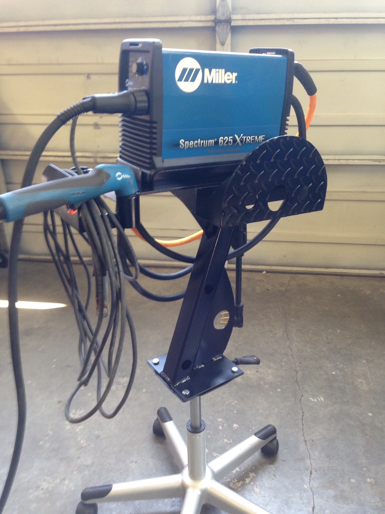

I have the Miller Spectrum 625. At the time I was shopping for the next size up Miller or Hypertherm but this one came up brand new unused on eBay with hard case and a ton of consumables for $1050 USD shipped.
It realistically only cuts 5/8” but I’m glad I didn’t get the next model up as anything thicker I like using my oxy-acetylene torch.
/ Plasma cutter recommendations #22
Still love that office chair stand. :drink:
