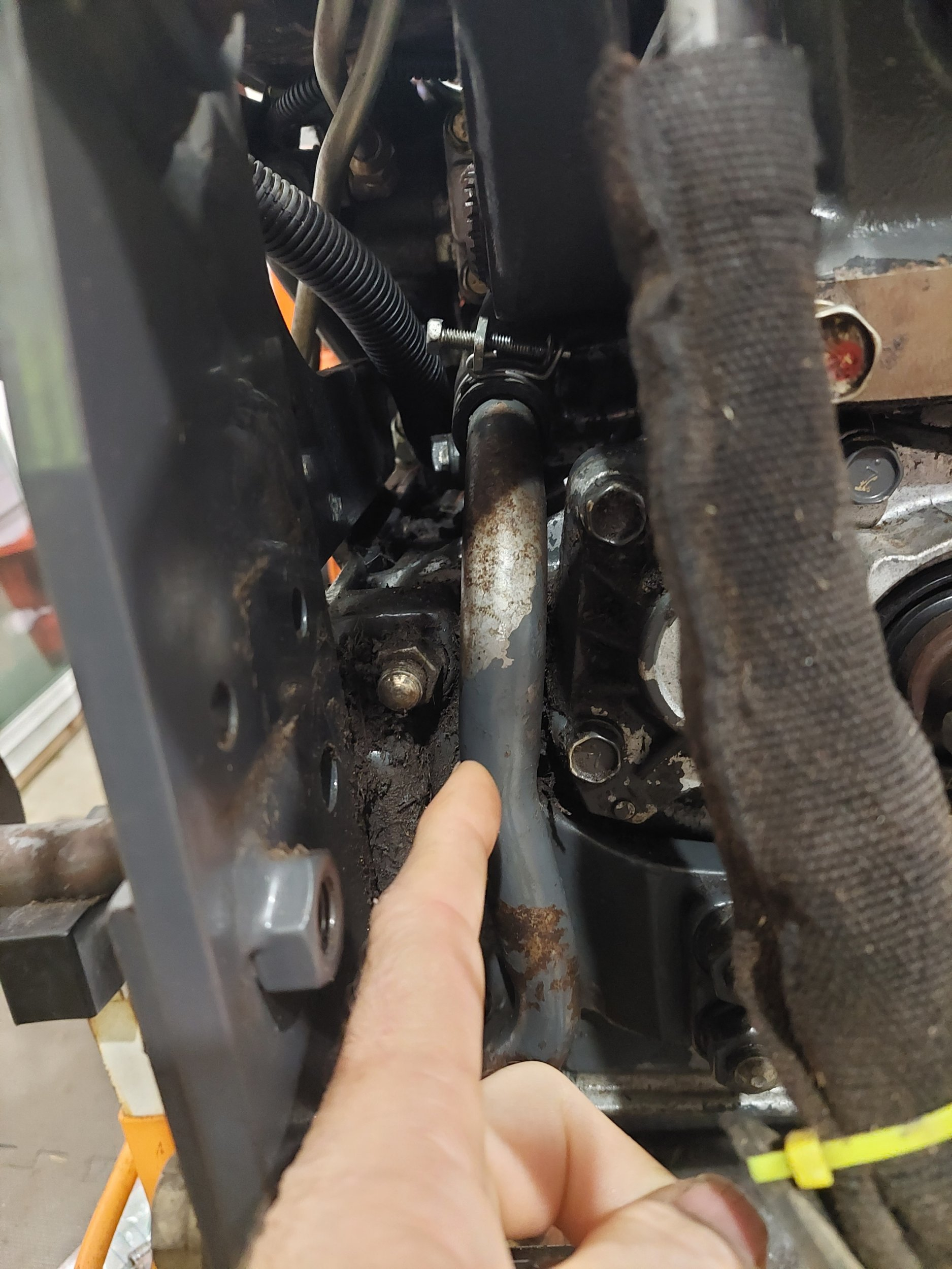

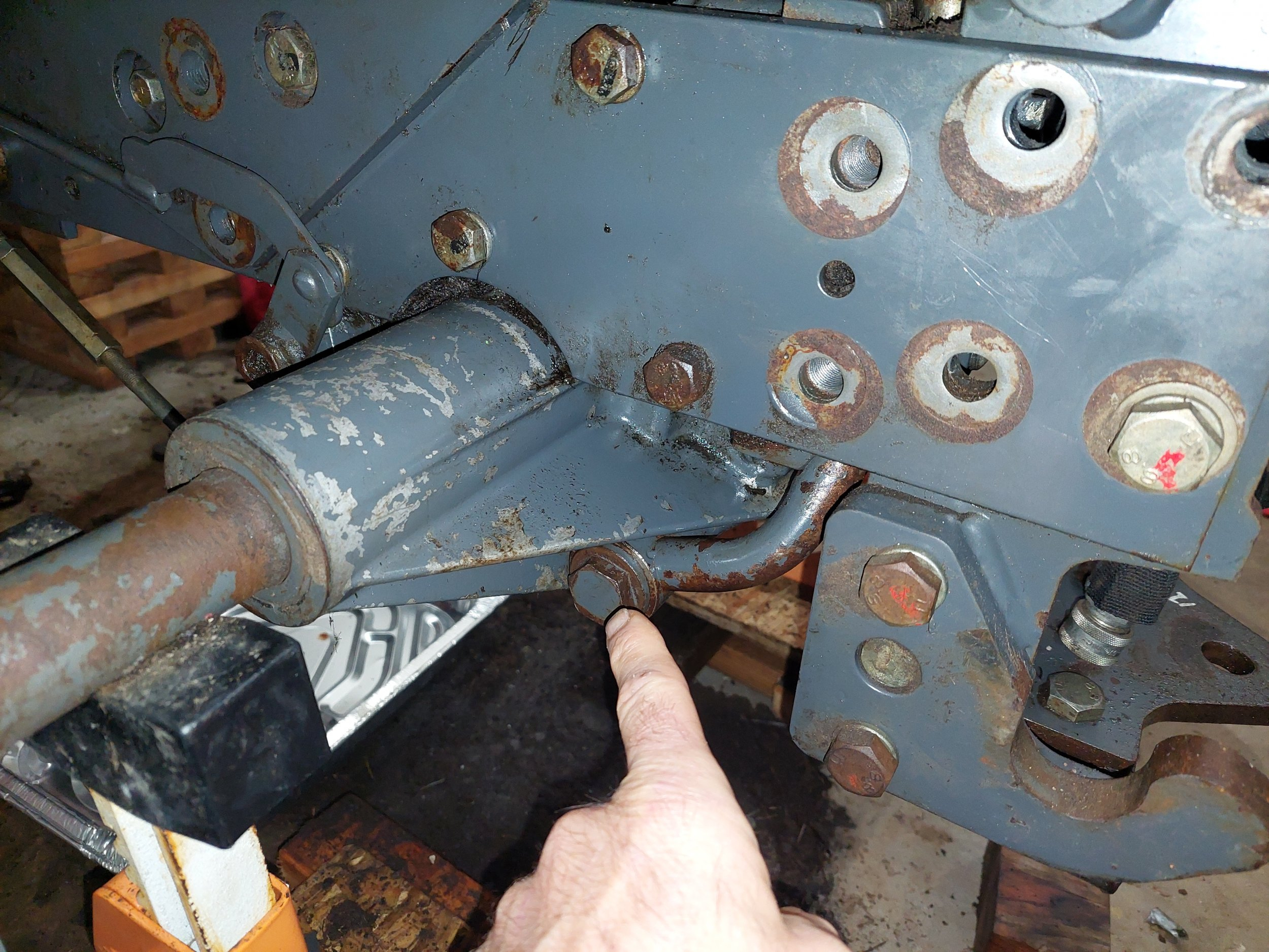

Could you do me a favor during your adventure and snap a pic of where the HST's inlet strainer/filter is? Ive been trying to find it in parts diagrams of my b8200 (NOT the same tractor, i know but it appears all the HSTs are extremely similar in layout) and it's been bugging me that I haven't found it. Im an ASE Master Tech and i give you all due credit for jumping into this project with both feet! I hope I don't ever have to replace mine.. which is part of why I feel like i need to find and inspect that strainer! :mad:
Nice work on all the research/sourcing so far. It'll be back up in no time and way cheaper than I would have guessed at the beginning of this thread.
Hey buddy here are a few pics of the strainer.
Let me know of this helps. I believe its a 20mm bolt. Be careful when you pull the strainer out there is an o-ring on each side of the pipe I if that makes sense... The black hose I'm pointing to connect to that curved pipe that goes down to your strainer. It looks like a regular bolt as the strainer is part of the bolt head.
It's the moment of Truth for me. I'm getting ready to start the tractor and check for leaks and see how my job turned out.
/ PLEASE HELP? BX22 HST problem #70
Interesting. I knew about the strainer banjo bolt thing that goes up to the engine-driven pump but i didn't notice any T's off of it to feed the HST either physically looking at my tractor, or by looking at parts diagrams of the hydraulic lines running down the side of the tractor. I would be pretty relieved if i found out that there really was only one strainer I needed to worry about, but unless i've made a major oversight, the stuff i've looked at makes it seem like my unit is not set up like yours.
Thanks for the pics! If it turns out my tractor is like yours i'll be very happy about it!

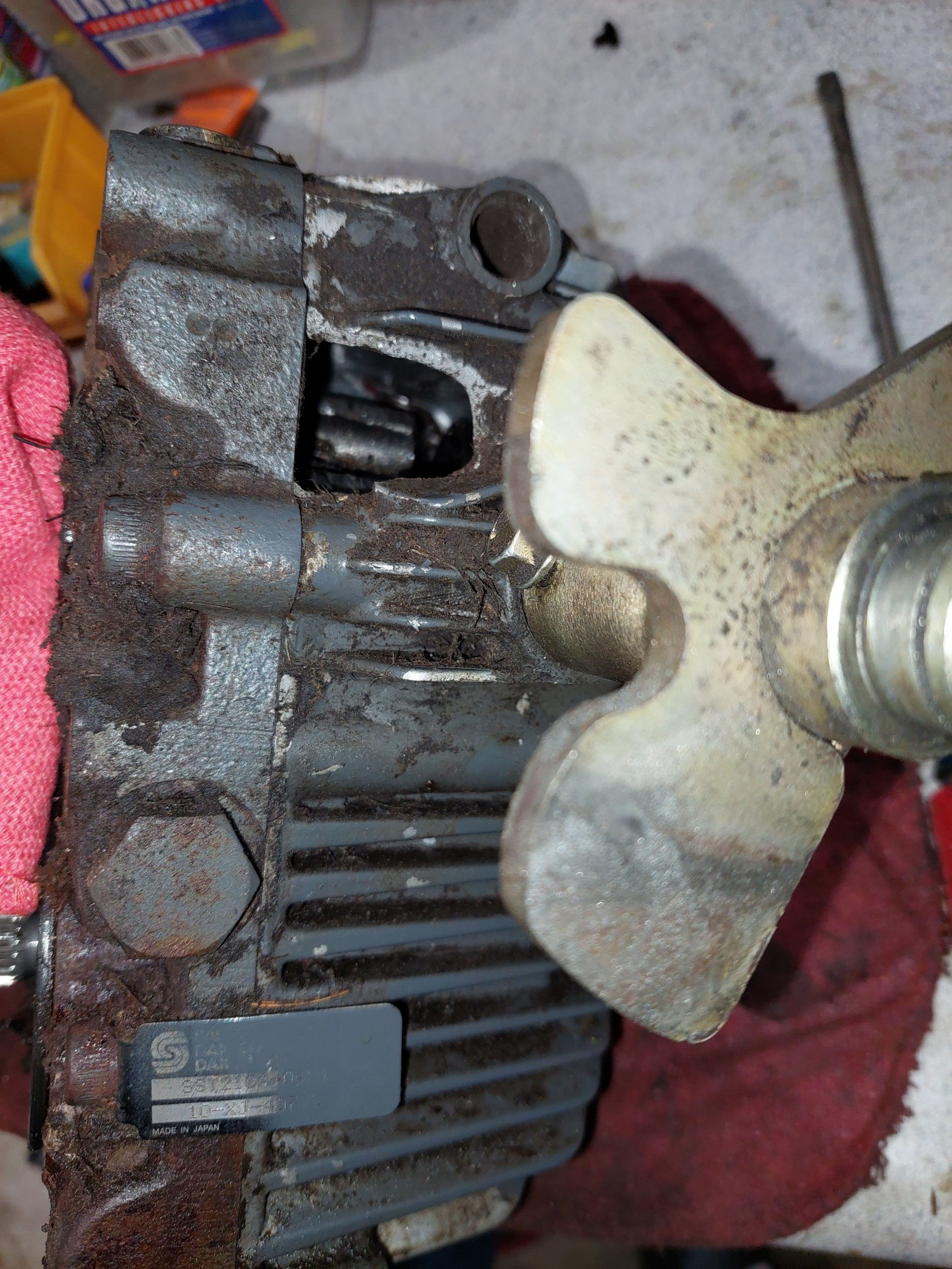

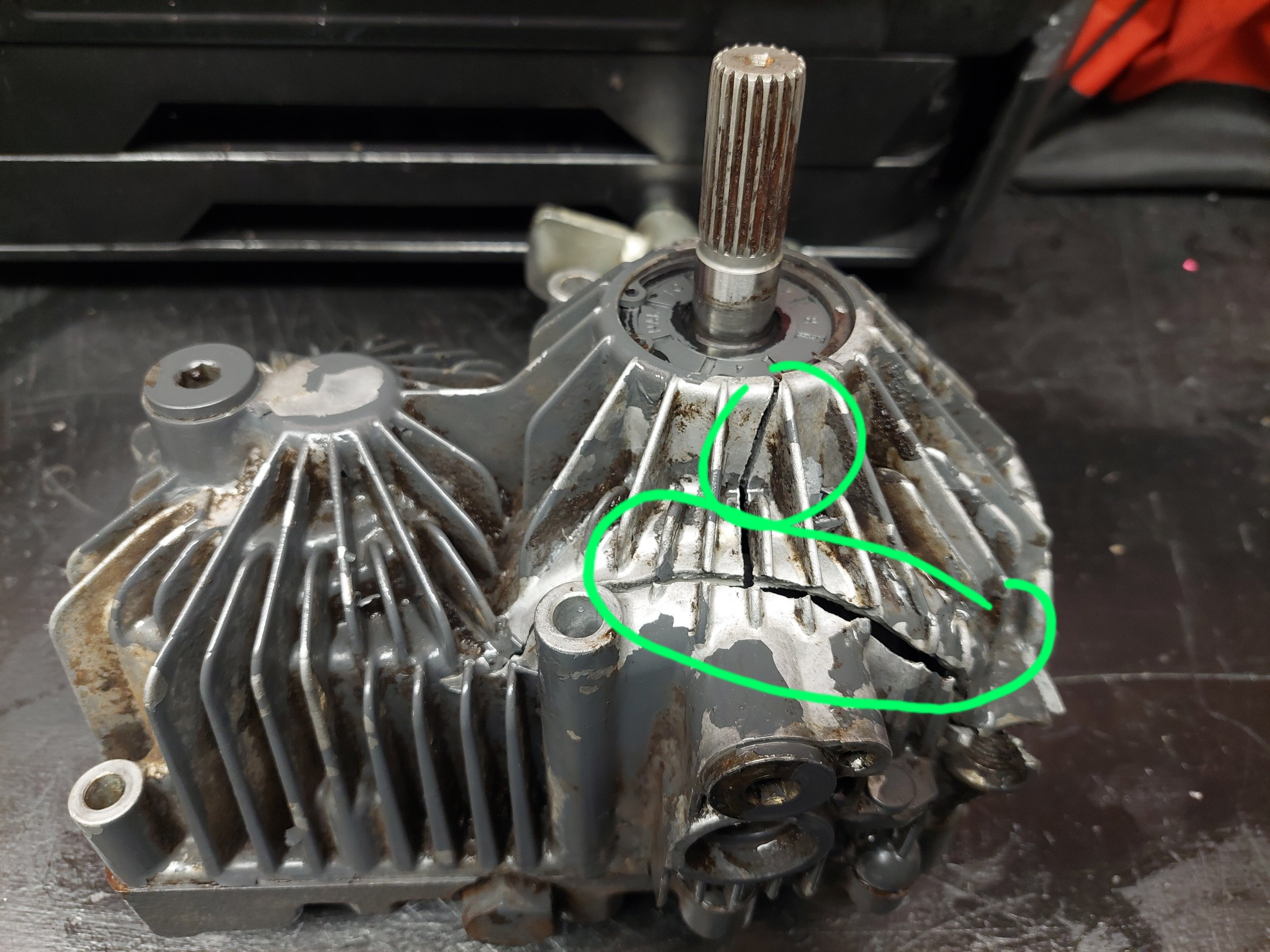

The company surprisingly enough has a used case so with all new parts it would still be a few hundred less then a dealers new one.
I guess it probably wouldn't "technically" be rebuilt then, unless they use the top piston/springs assembly.
Could you share the company you found. I too have a busted HST case on my bx2200 and am having difficulty finding one.
Mine didn't explode quite as spectacularly as yours but the case is busted nonetheless.
