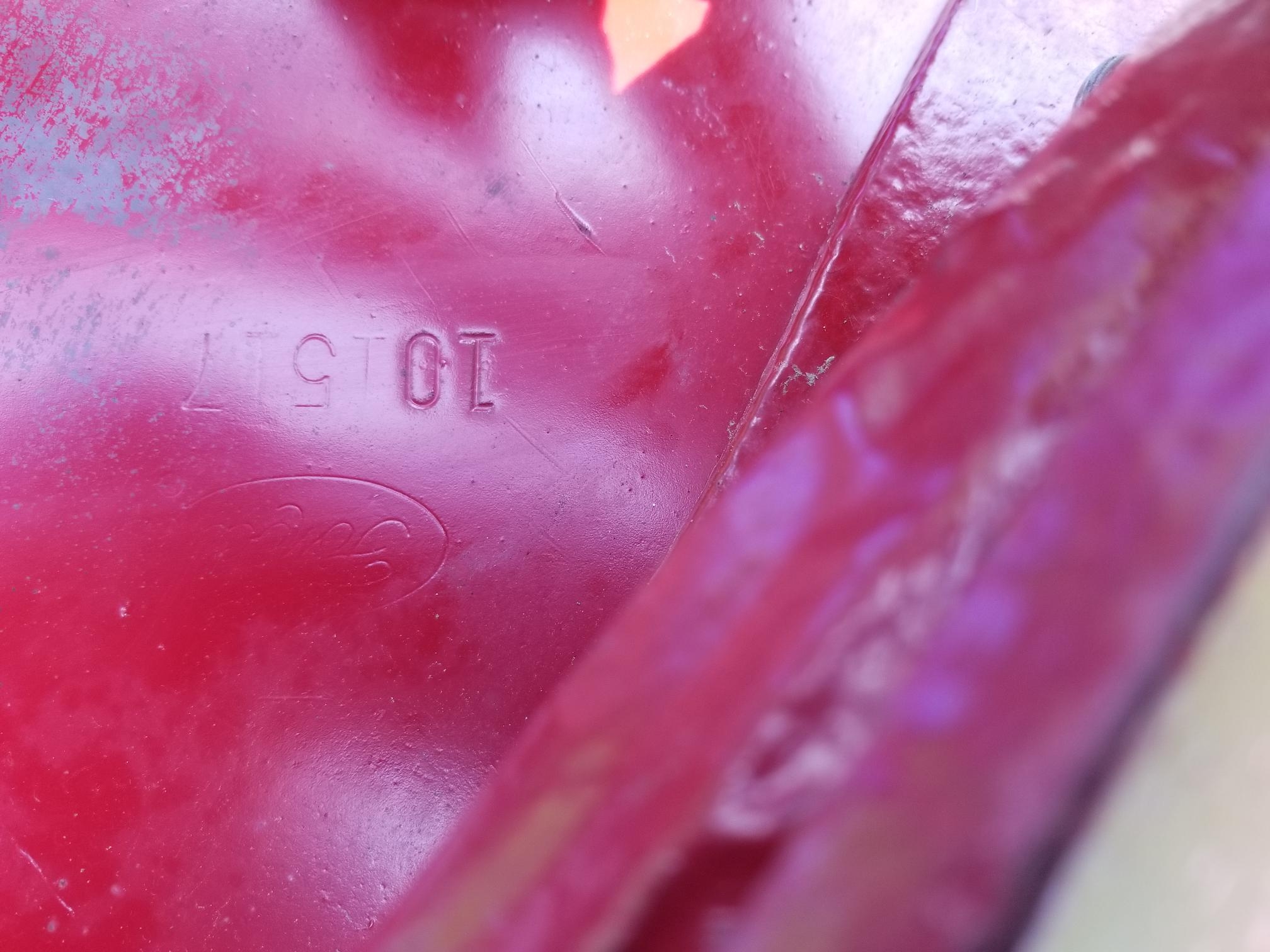

What model Massey do you have and what brand and size plow(2-12 or 2-14 or2-16)?
I have a 2-12" bottom plow. 14" tires. MF451, 52HP, 2WD. Attached are pics. Inside of right tire to center of tractor is close to 23".

Your right side tires, front and back, have to move freely through the last plow furrow created. If your plow is 12" wide, producing a 12" wide furrow, but your rear tires are 15"+ wide, forget a consistent result.
(I speculate this is your problem.)
If your plow is 14" wide, producing a 14" wide furrow, but your rear tires are 15" wide, the weight of the ballasted right rear tire usually will pack moist furrow soil sufficiently so the plow can operate as designed.
A 16" wide plow will allow the rear tires of any COMPACT tractor, including your MF 451, to move freely through the last furrow created.
INFORM US OF THE WIDTH OF YOUR PLOW AND THE WIDTH OF RIGHT REAR TIRE.
I have 14" tires and 12" plows (2-bottom). Inside right tire is close to 23" to center of tractor. Is there anyway to make this work. The furrows are never really defined when I plow.
