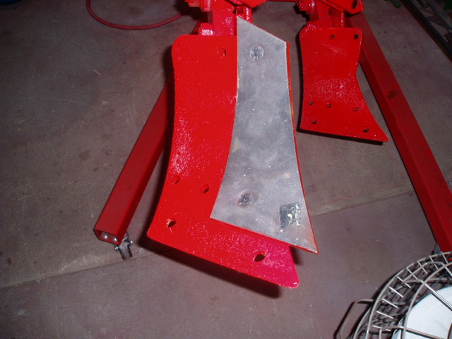

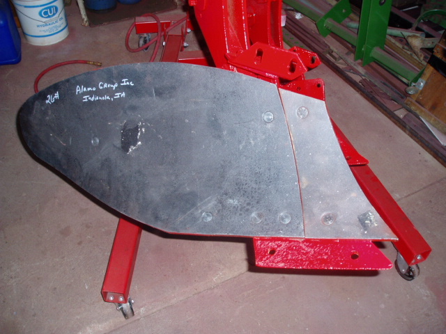

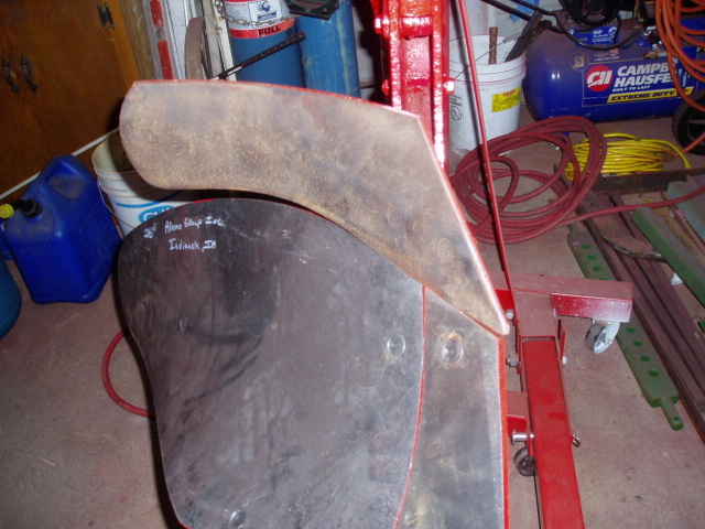

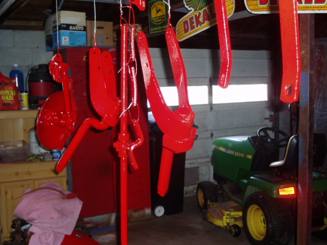

OK, let's go a bit further into landslides, landing, and tailwheels. pic #1 will show the direction that the plow encounters its resistance.....the dirt it's about to roll over. pic #2 shows the line that the just recently non-moving dirt is being moved and deflected. That puts pressure against the moldbord, pushing to the "land" side. (unplowed ground) To counter that force, the plow has a flat side that runs against the furrow wall. That's pic #3.
A flat plate sliding against dirt isn't the most efficient way to reduce power required. A wheel with a roller bearing is a big help. pic #4, that tailwheel again.
Next we'll get in to making the plow follow on it's intended path, moving it right or left to get it there.

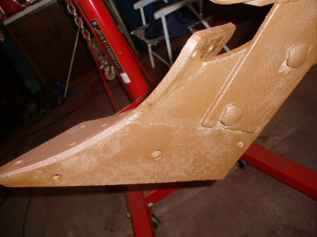

It's about time to hook the plow up to the tractor again. We'll go over some basics on leveling (front/rear and left/right) But a few more things about coulters.
In SOME conditions, and if you have big diameter coulters, you can set them almost to the bottom of the furrow. In most conditions I've ever plowed in, the coulter would serve as a guage wheel of sorts, keeping the plow from full depth. In most conditions, 3" of cut by the coulter is plenty. Also watch for the coulter arms getting close to the ground. They'll tend to catch stalks/weeds/ect

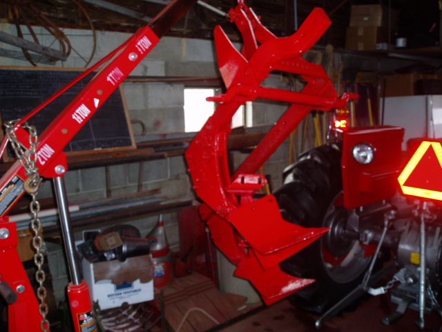

have an old 4 gang plow on the farm that i want to try to use. It is missing the cylinder to raise it but looks otherwise complete. Will I be able to pull it with a 70 hp tractor
/ Plowing new ground. #75
see attached pic, will this plow work??

Junk-that plow is beautiful!
7040-i think that plow should work just fine.
