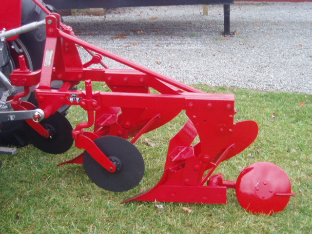

Through the miracle of photo editing, we can demonstrate how to adjust a plow even after it's already done. I'm ready to break this thing in. Just have to wait for a window of opportunity. Living on a hill, we get 5 or 6 days without rain and we can roll over some sod.

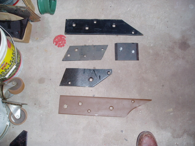

As far as what to shop for.... With most of the more popular brands of 3-point plows, you can still scrounge all the wear parts. Landslides are getting dicey with some models, and moldboards getting RIDICULOUS in price. (near $100each PLUS shipping) Coulters are all but impossible to buy and/or replace. Entire coulter assemblies might mean buying a parts plow if they aren't intact and on the plow you buy. You don't HAVE to have a tailwheel, but they do help a lot. I'd look for a COMPLETE plow, one with all the coulter hardware, decent moldboards being a plus, as well as having good landslides IF it isn't an easy brand to find parts. Your best plow for the buck and easiest to find parts for is the Ford 101. Next would be Massey #66 or #43.

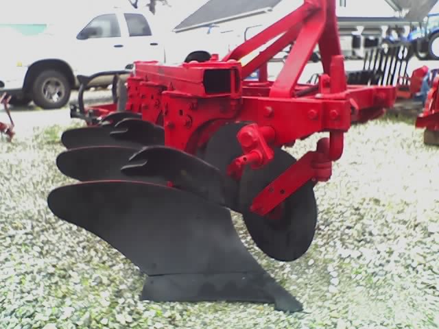

I may have to look again at that plow I saw at Giles farm equipment. International Harvester I think you said it was. It looks in very good shape. Even though the parts are hard to come by, if it's in really good shape I probably would never plow enough to wear it out.

In the next few days I need to call in a parts order to my favorite mail order parts house. While I've got them on the line, I'll "check stock" on a few IH plow parts. I don't know for a fact that parts are scarce. A 3 bottom plow that's in good shape should have a couple hundred acres of life left in them before they're worn out. If you've got 200 acres of plowing needing done, I know where the plow day can be held!

Thanks. That would be great! From looking at the photo of that plow can you tell what kind of shape it is in?

Well, it looks good and red.... Hard to say from the quality of picture my monitor will provide. The frame seems to all be there. All the wear parts still resemble the original, so it isn't worn beyond use. I'd probably change shares and maybe shins before using seriously. Can't really tell about moldboard wear. They'll wear out 3 or 4 sets of shares. It's been years since I last looked at an IH plow up close. Seems to me they have a replaceable "wear pad" on the landslides. Those can be fabricated if not readily available. That will be a HEAVY plow relative to some other brands. That can be good, that can be bad. Generally speaking, most plows you'll see with the box beam frame will be higher trash clearance than truss frame style plows. That's important if you're plowing under stalks or weeds.
