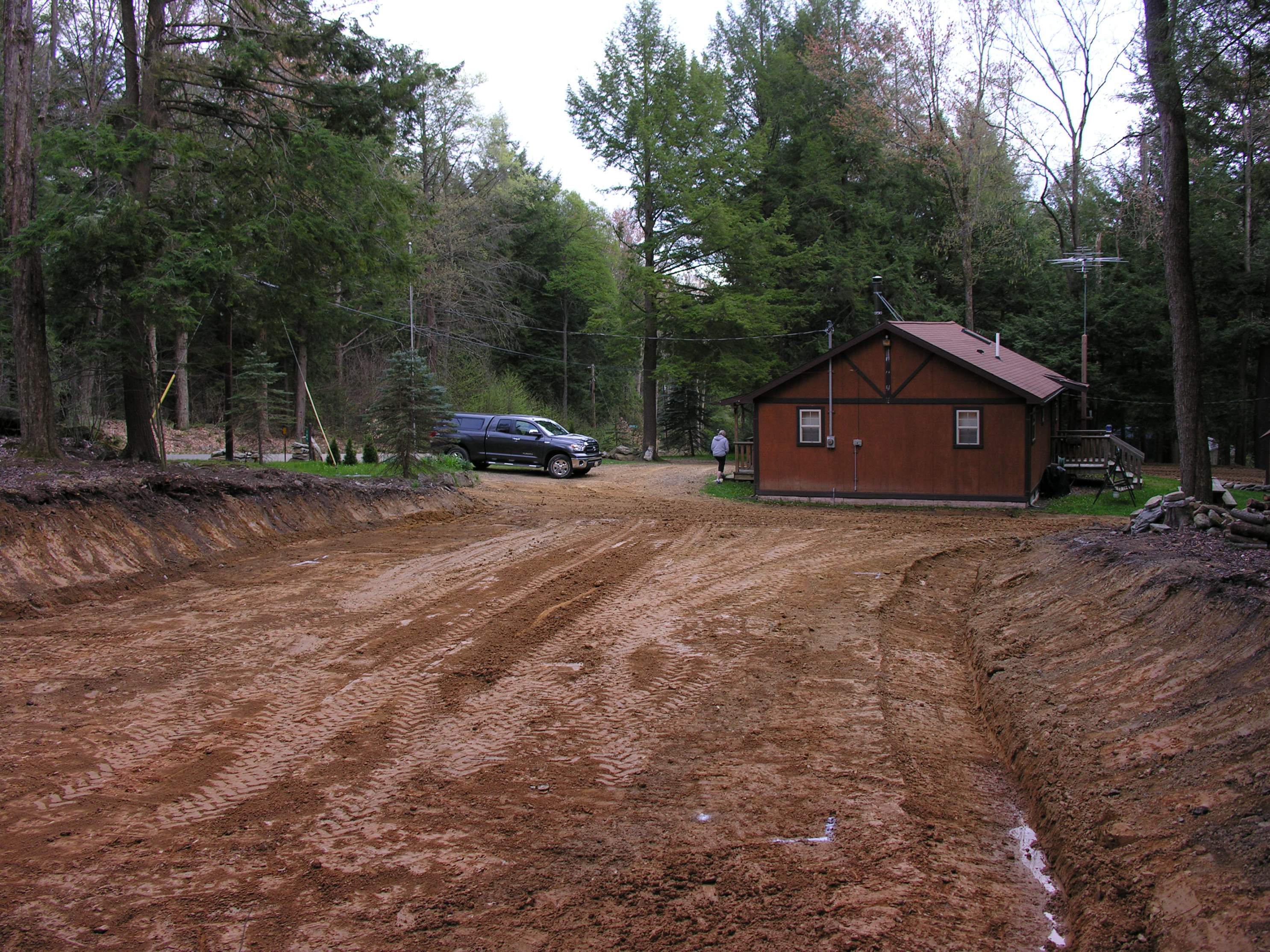

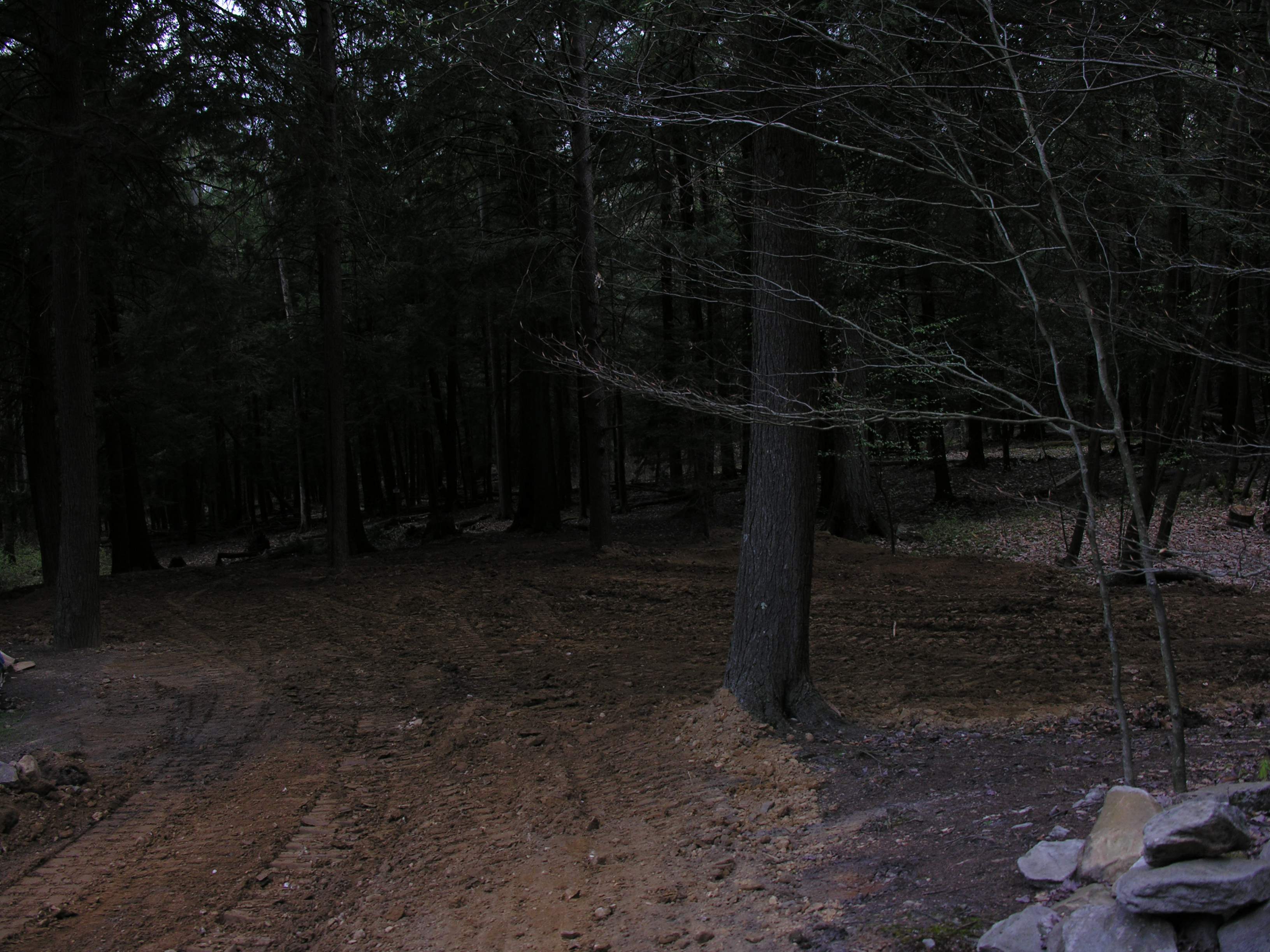

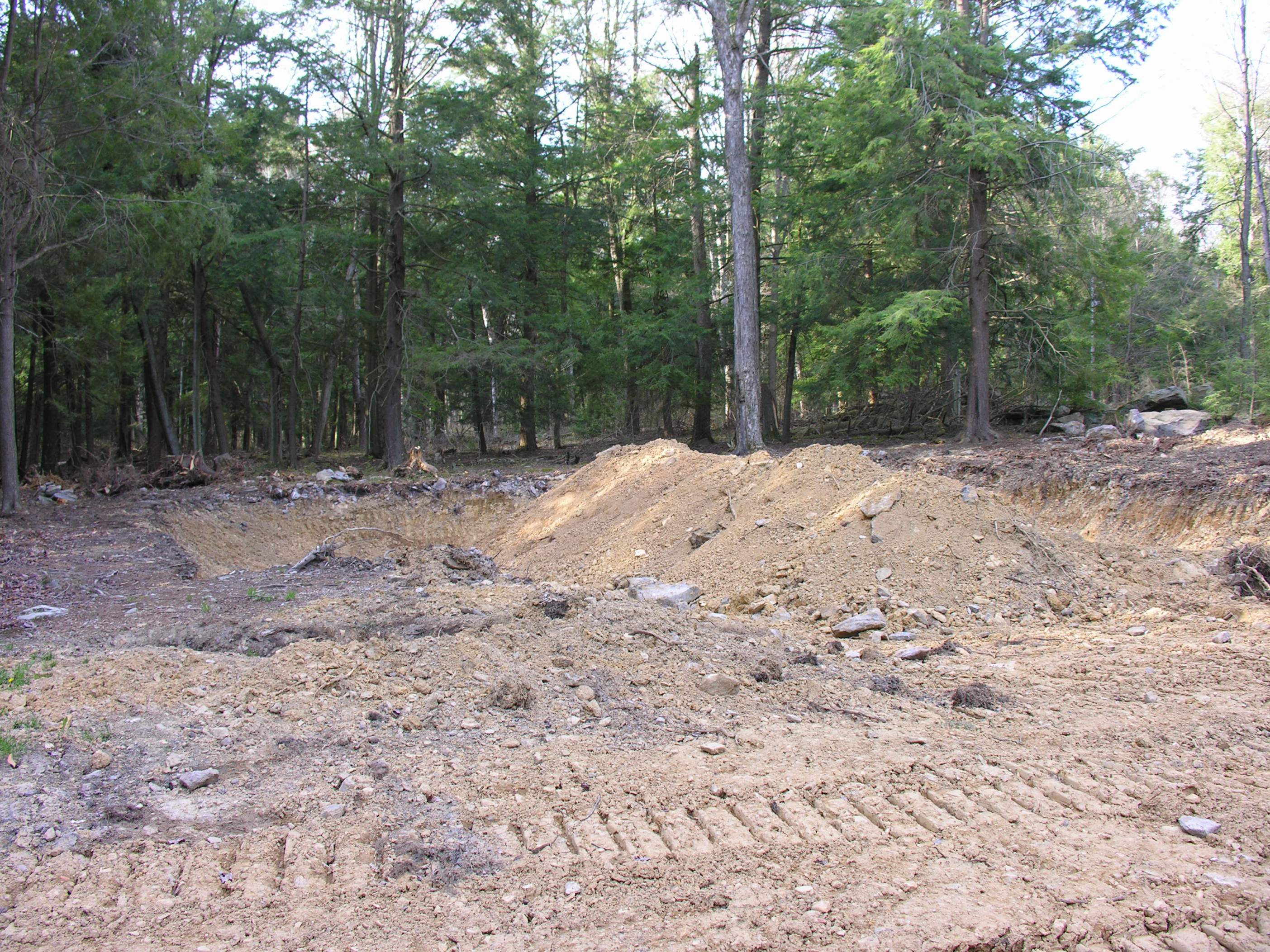

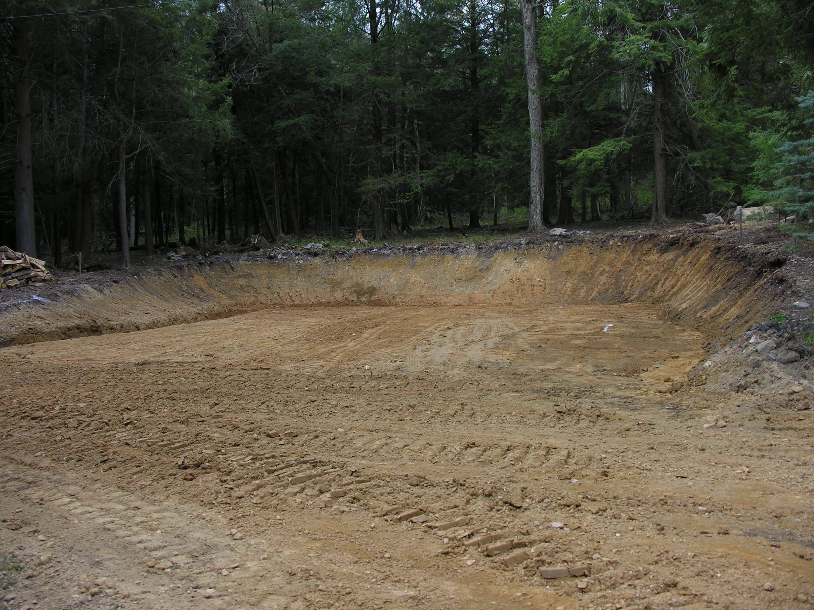

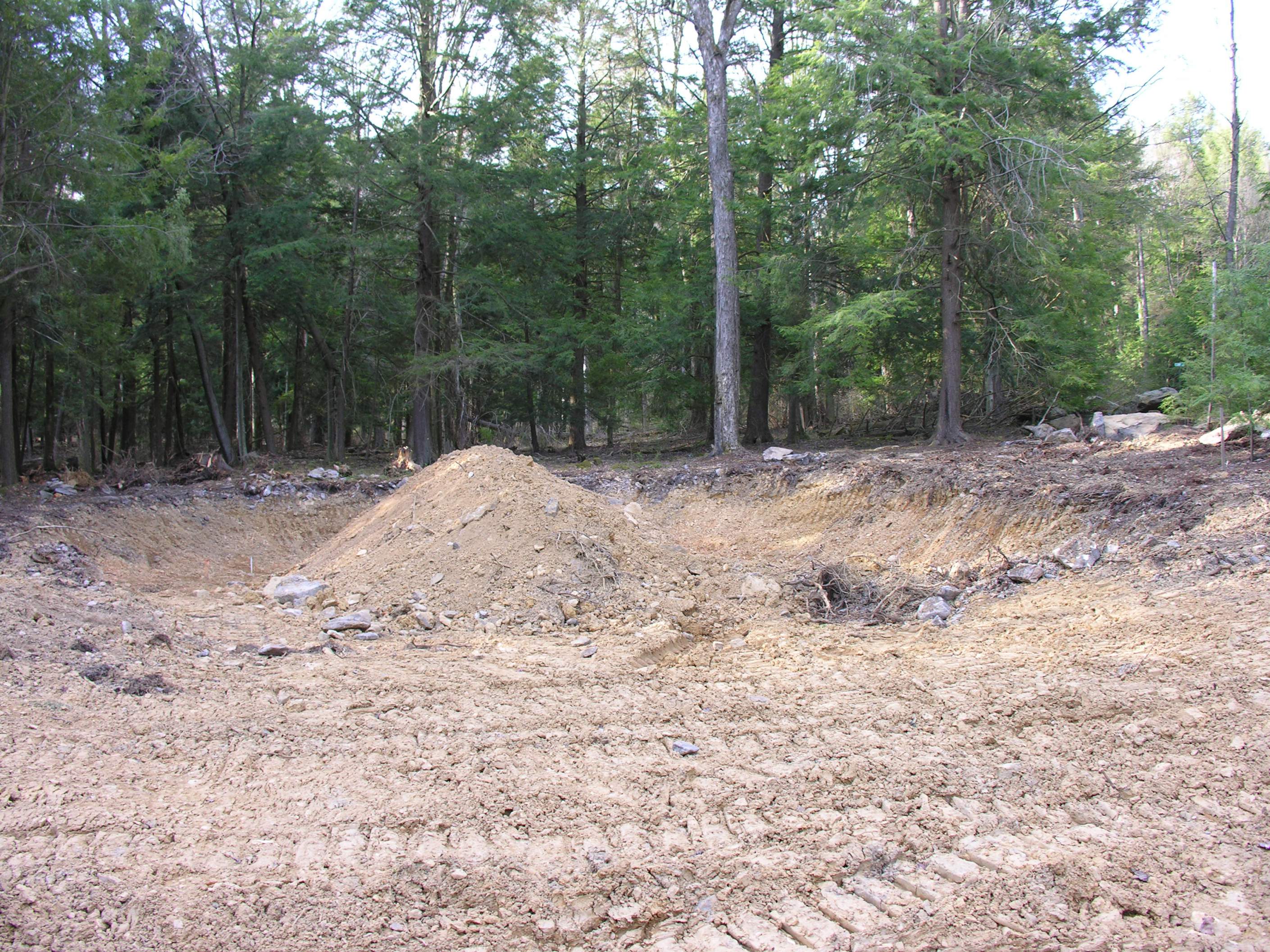

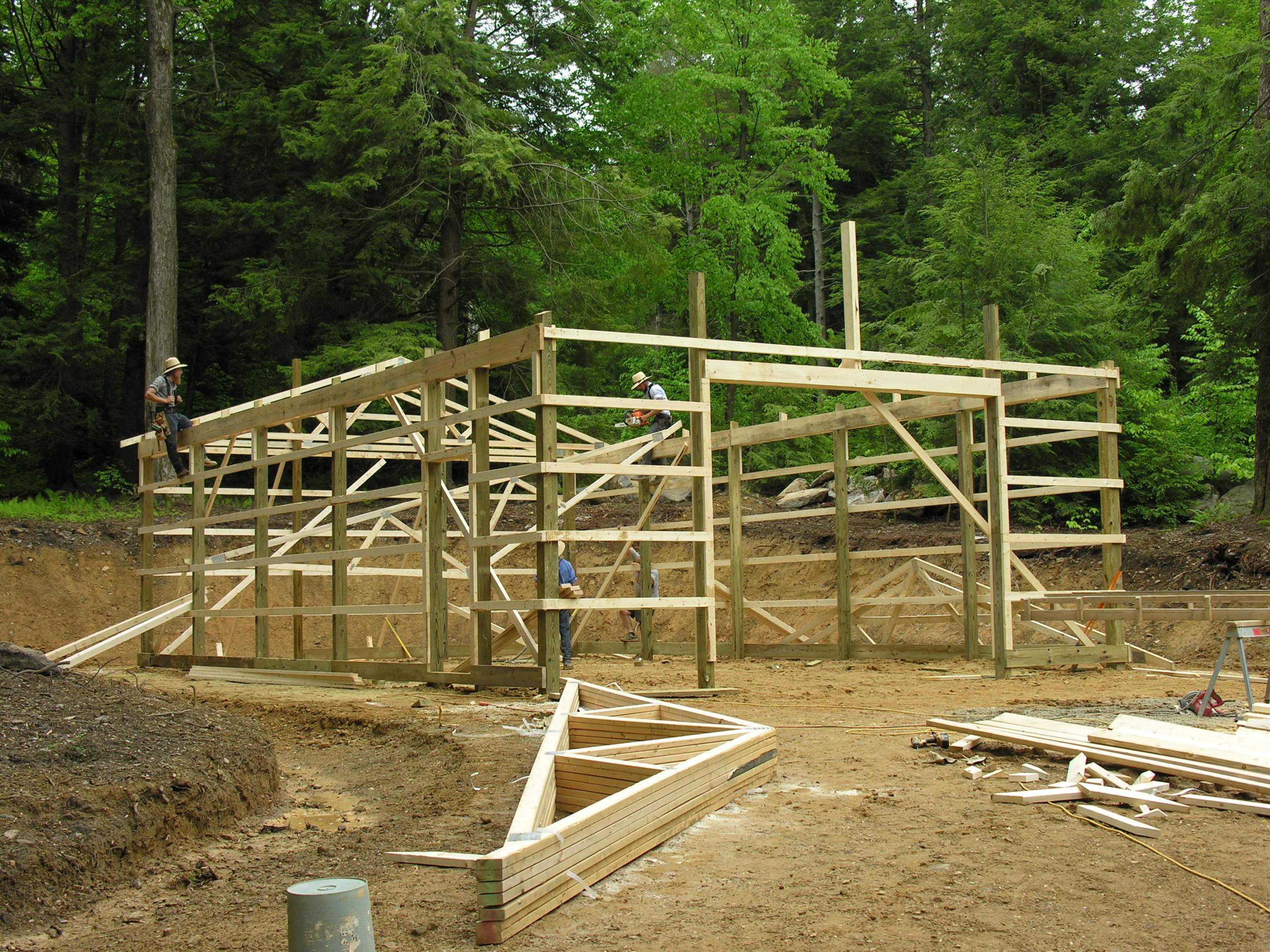

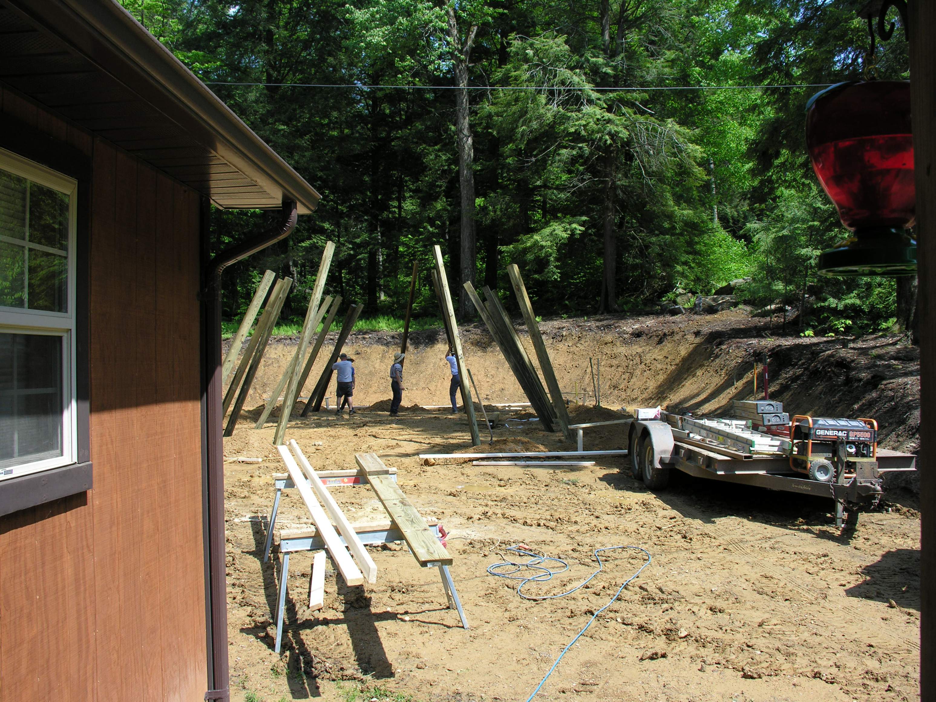

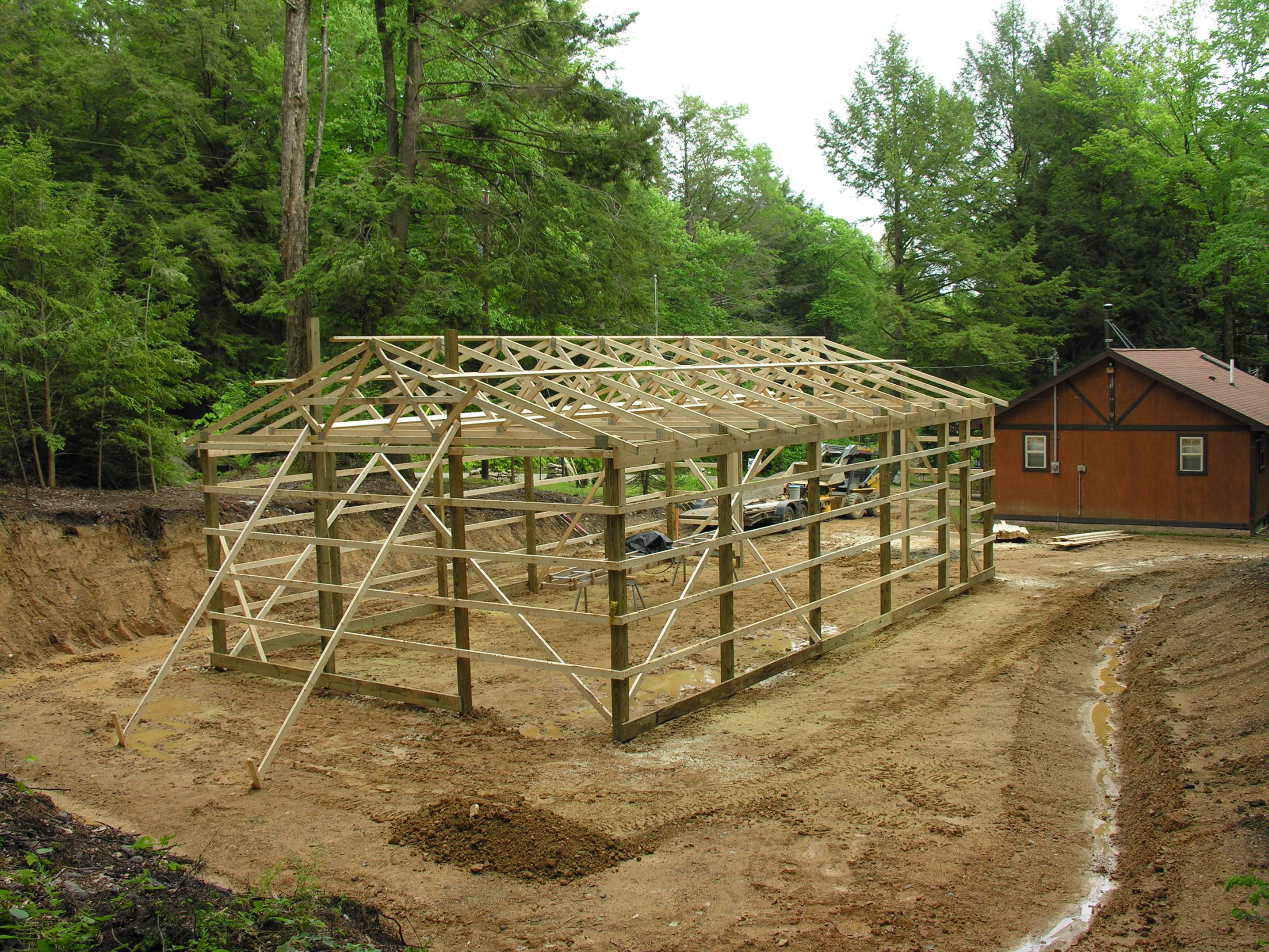

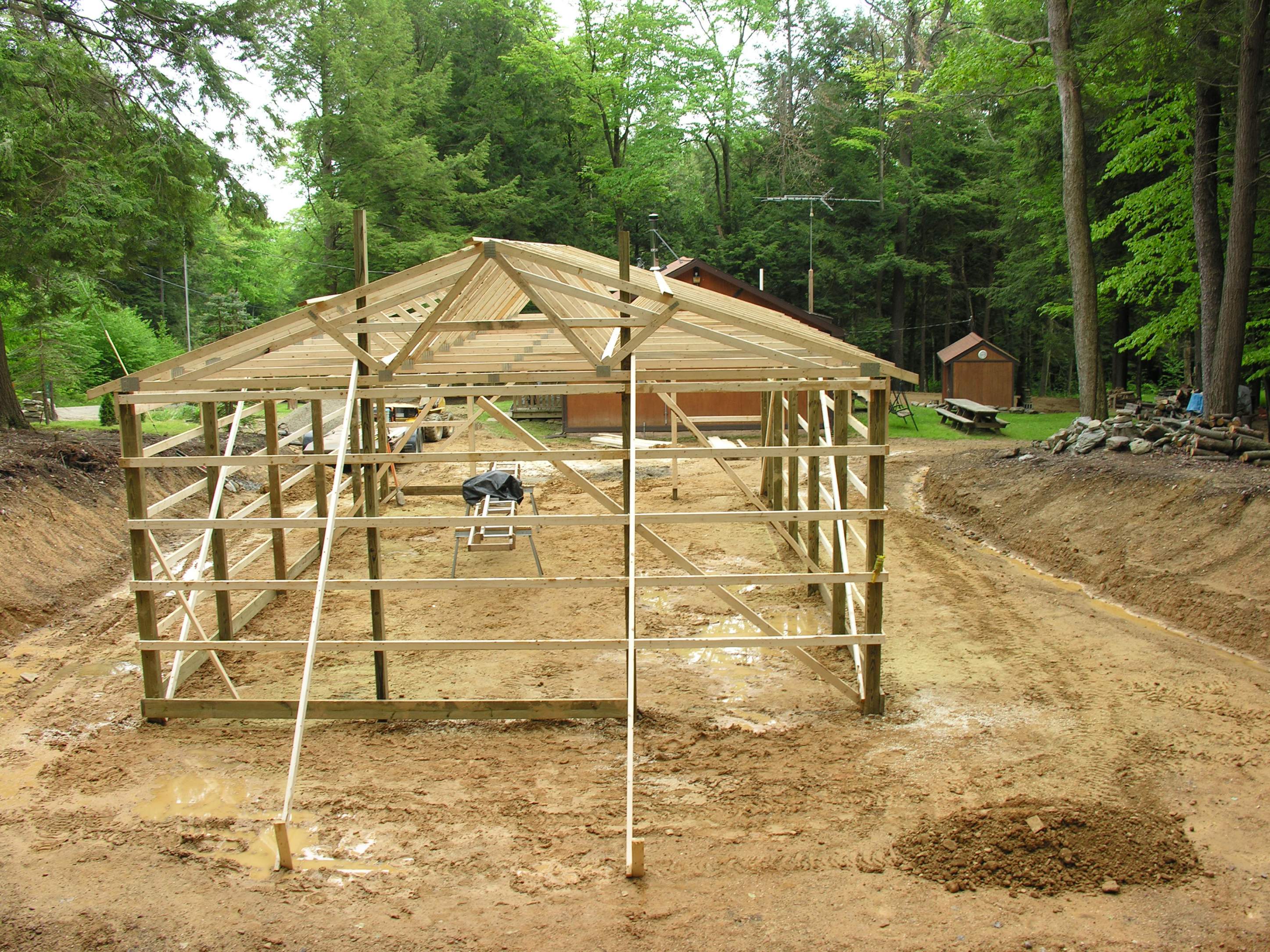

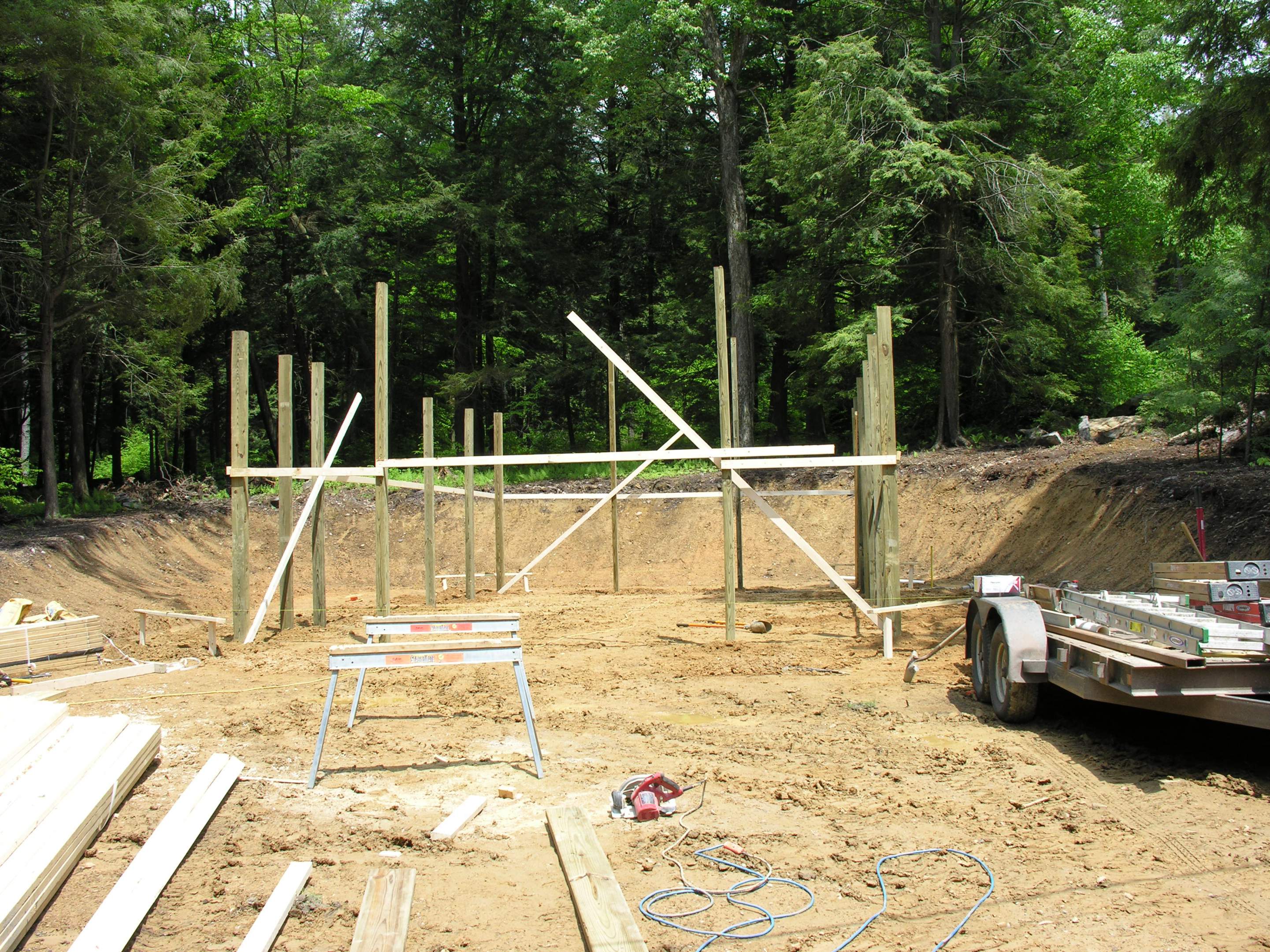

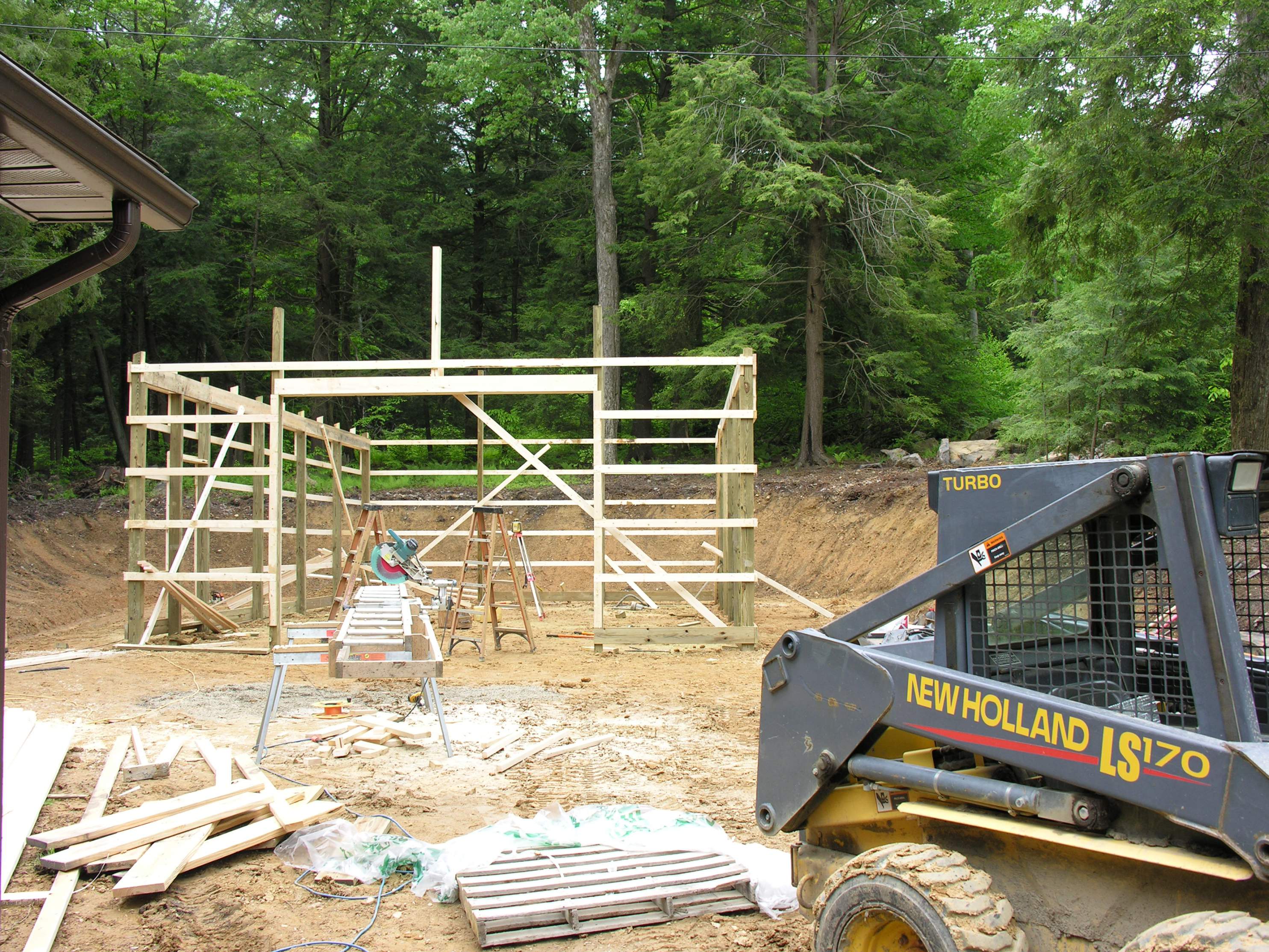

Well the long awaited barn got off to a great start today. What you see was done in about 7 hours. There have been some chnages since this thread was started. It is now 24' X 40' but no-lean to. Adding the lean-to counted toward square footage of the building and by going over 1000 sq. ft. the building permit would have gone from $10.00 to "several hundred" and I would had to file a storm water plan. We will build this now and plan another open shed later instead of the lean-to. Also the overhead door will be 12' X 9'. And Mr. Bear came back and finished off our conical juniper.

Looking great. That's a nice amount of production for a single days work. Keep the pics coming. I should be building about the same size pole barn this summer.
/ Pole Barn Project #23
Thank you for sharing your photos. Just being curious, can you look at the grade stamps on one of the wall framing members (girts) and let me know if they are graded #2 or Std? Even better, if you can shoot a digital photo.

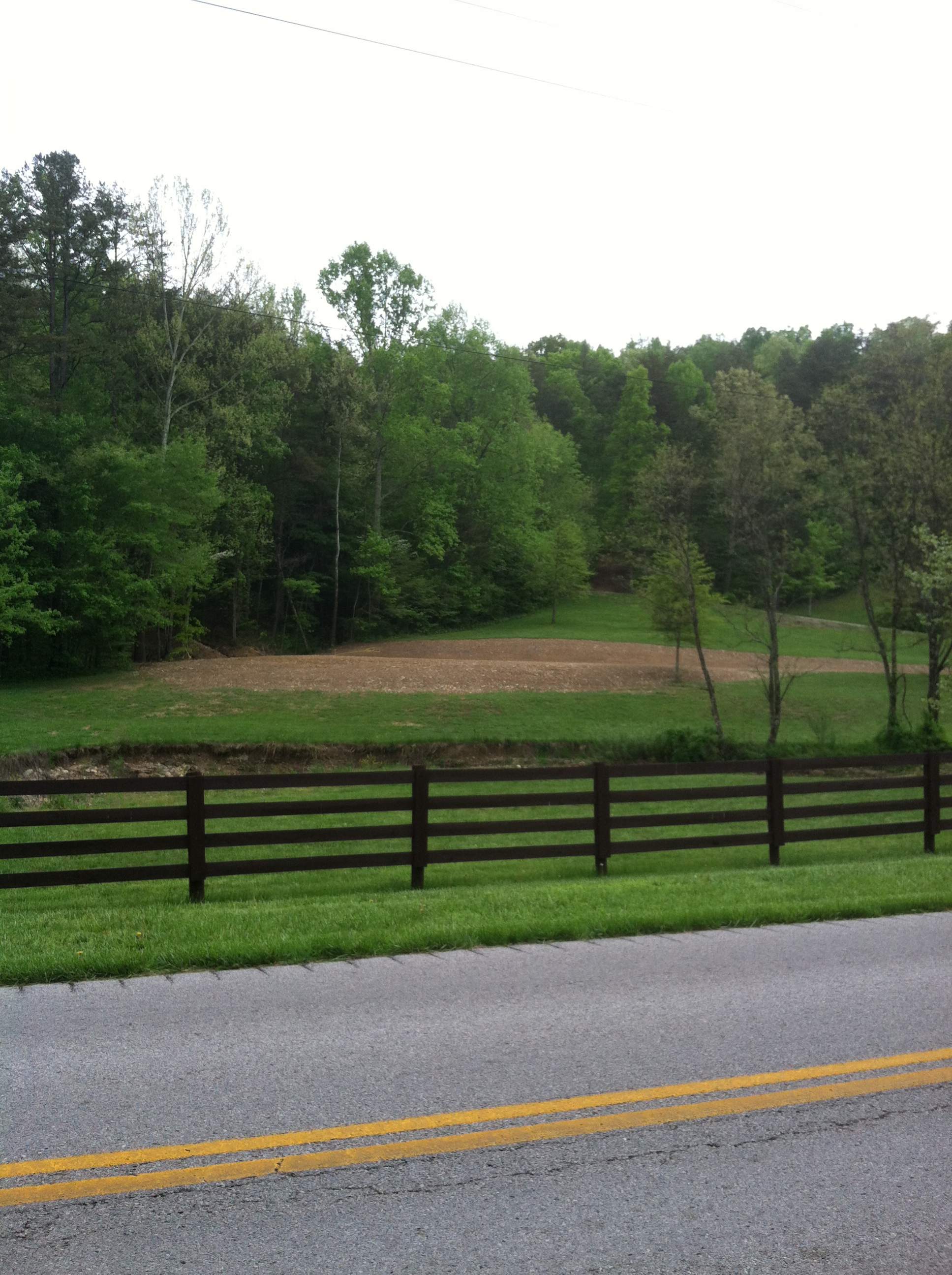

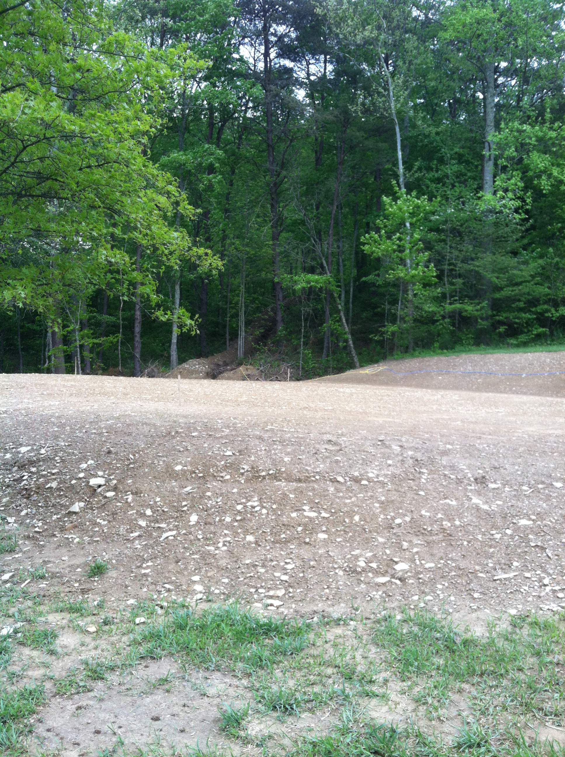

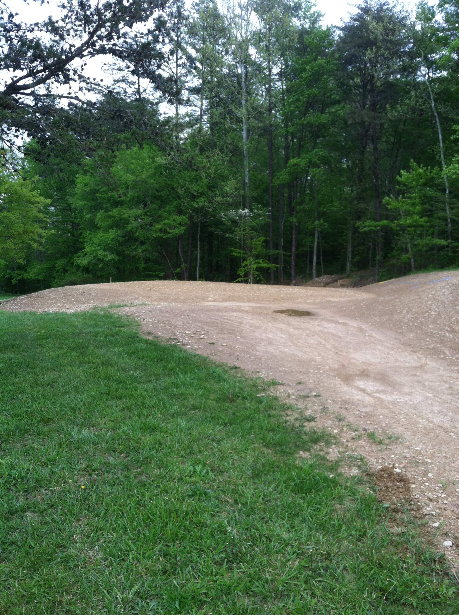

Materials delivered last weds, the crew from National Barn will start putting it up mon. looks like they got a good week of weather to build. Picture 010.jpgPicture 011.jpgPicture 013.jpg

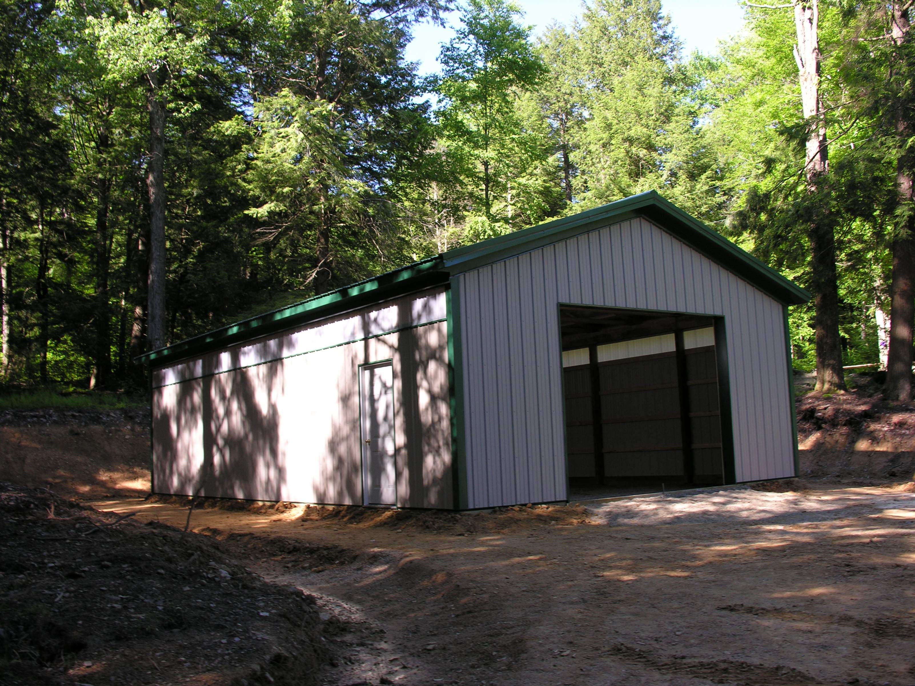

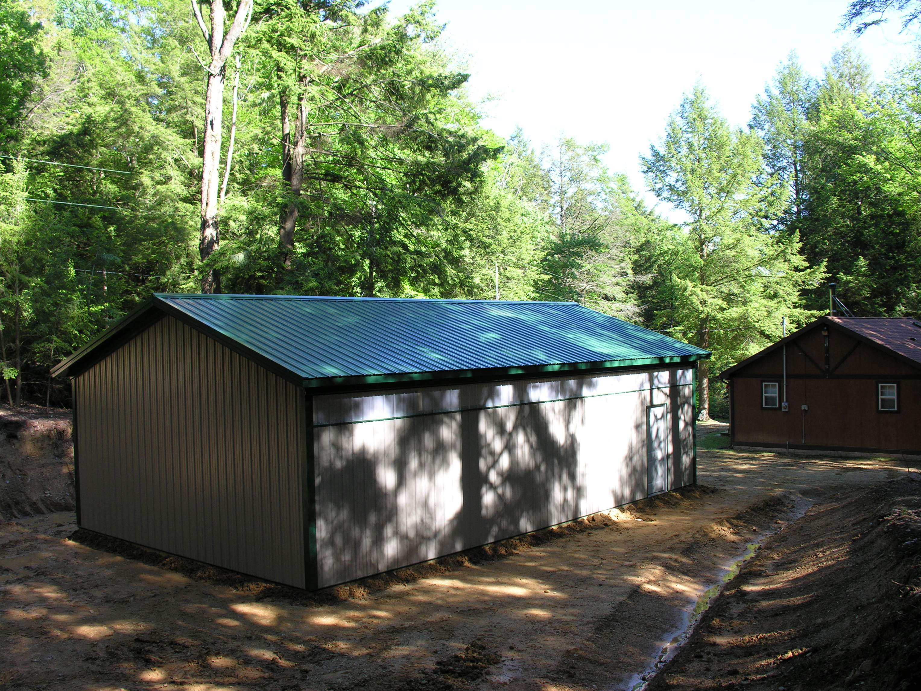

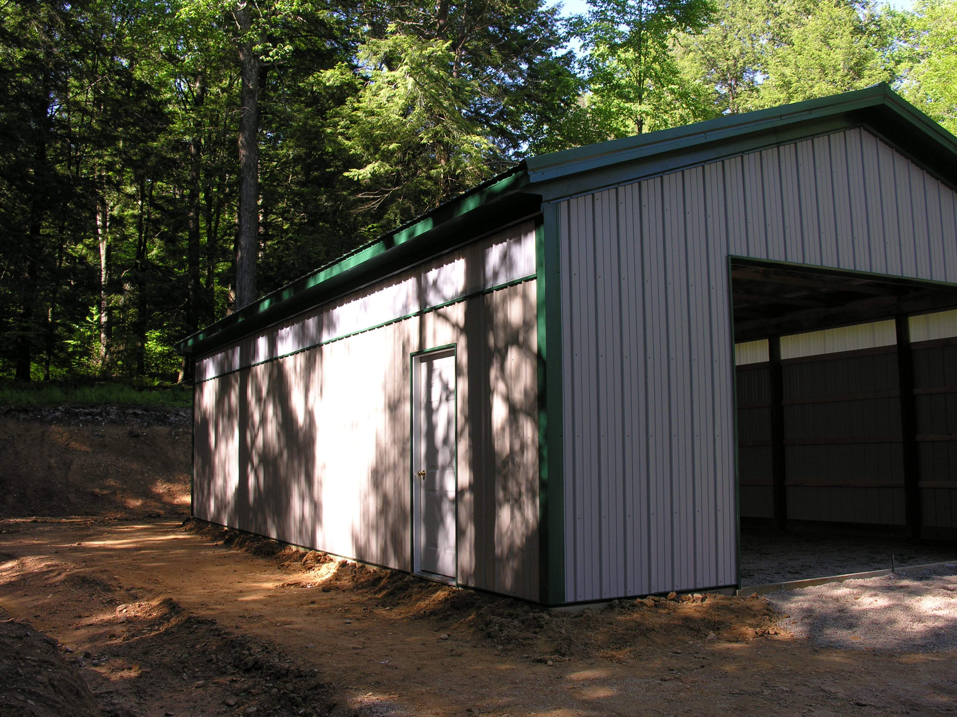

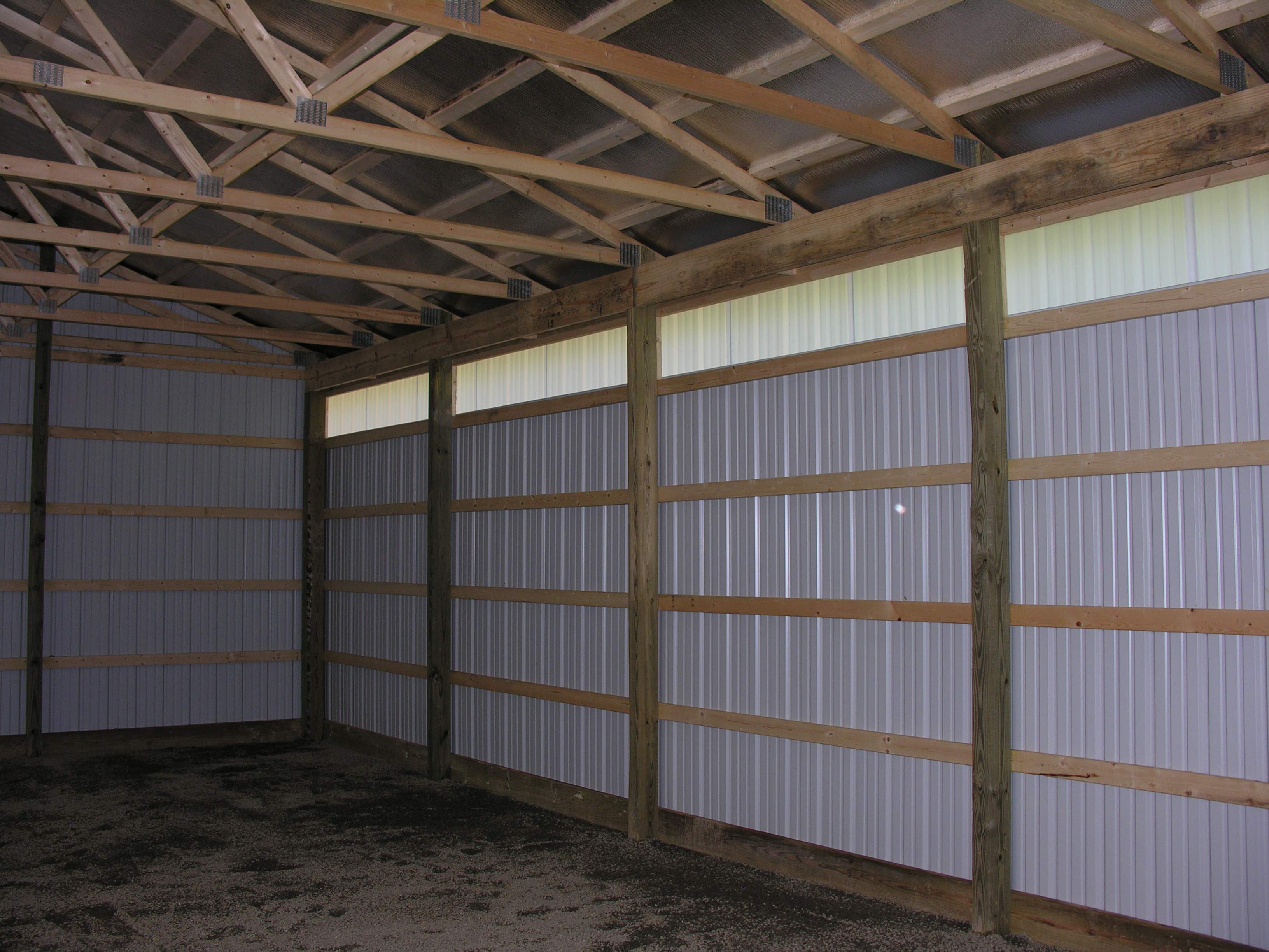

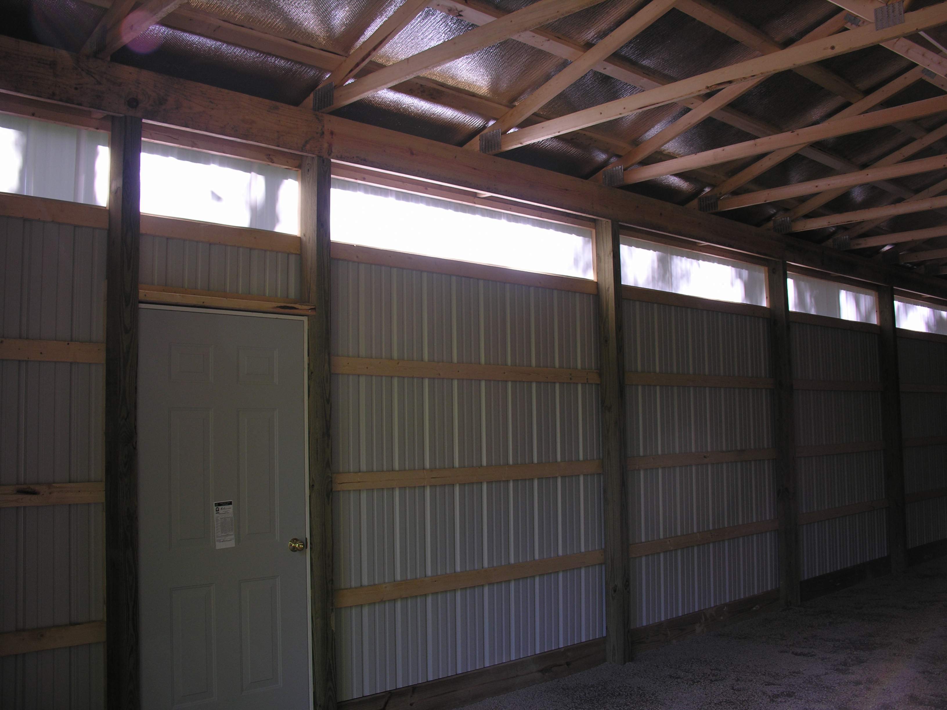

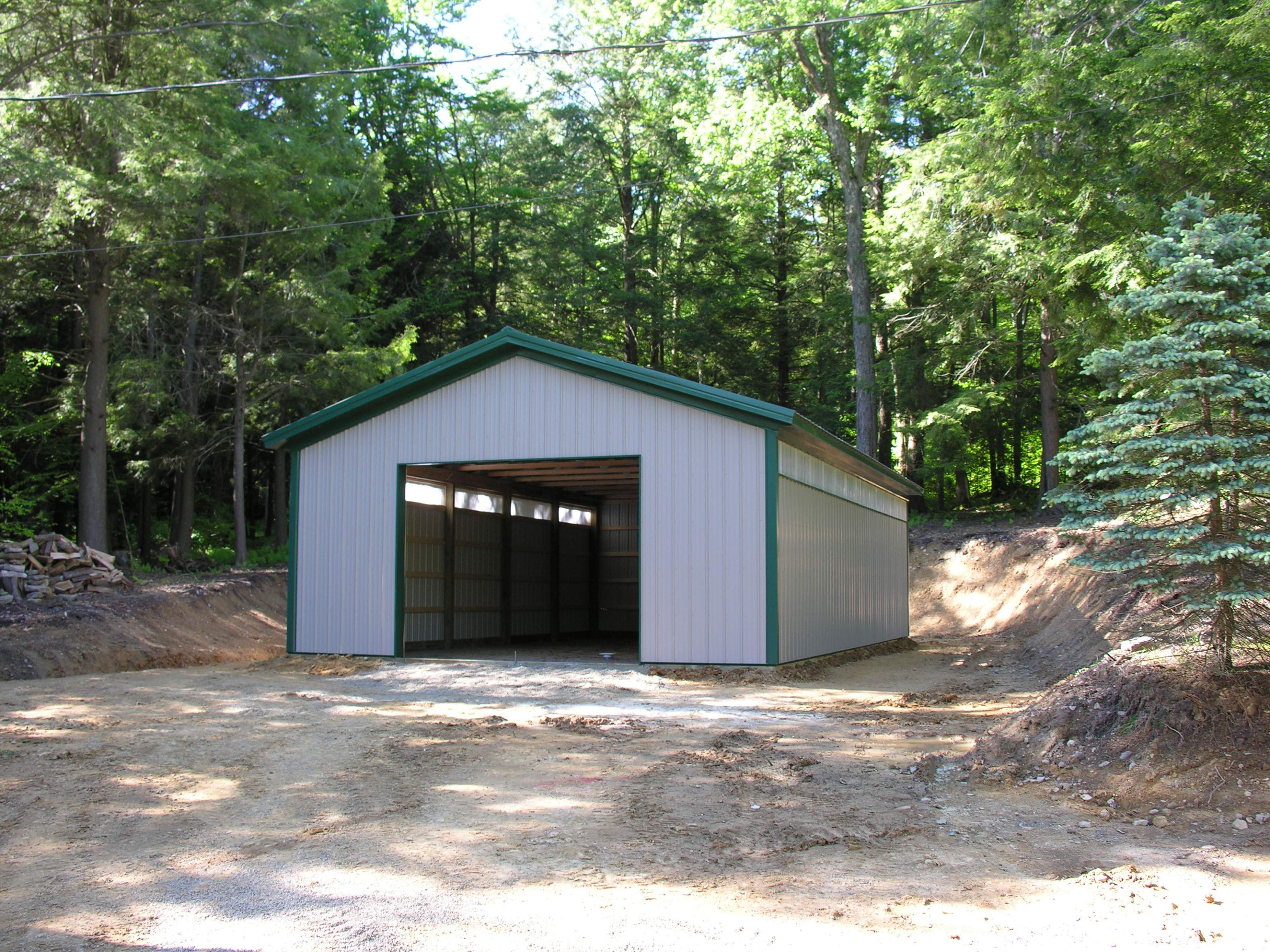

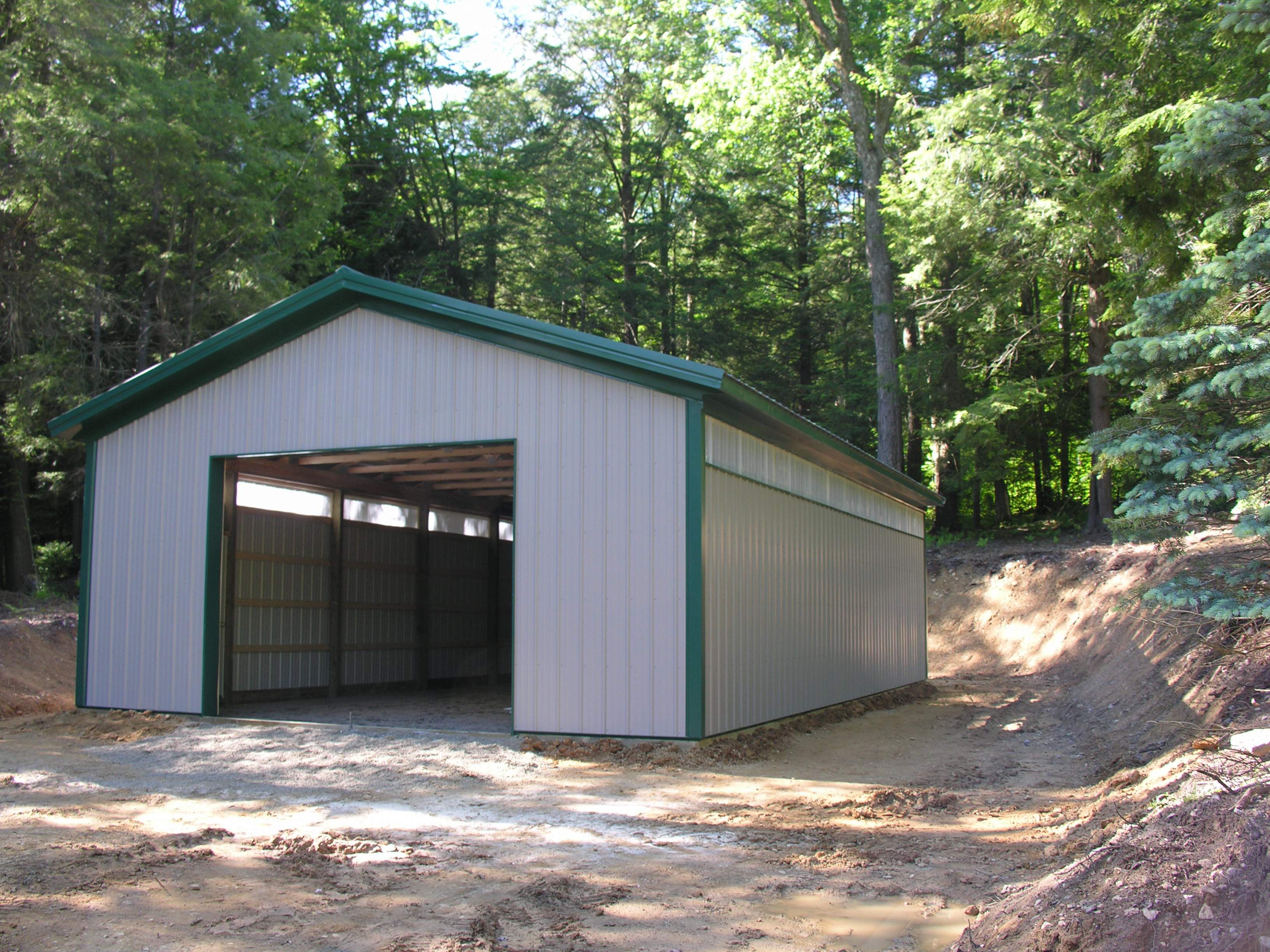

I was out to the site Saturday 6/1/13 and did the rough in for the electrical service. Today, 6/3/13 the contractor finished up the main building, roughed in the floor drain and got the site ready for the floor pour. A sub will pour the concrete floor and another will install the overhead door. Then I will take over to do electrical, finish drain and start setting up the interior. Very happy with our color choices.

If the roof insulation is typical reflective insulation with white vinyl one side, aluminum reflective face on the other side, it should be installed with the reflective side up.
Maybe it is just the angle of the photos, but it appears the bottom chord bracing is missing from the trusses.
The bottom chord truss braces are there! The roof insulation is the more expensive version that has foil on both sides!! Double-Bubble-Insulation

From what I can tell from the photos, looks like the crew did a great job on taping all of the seams on the insulation as well. Takes some skill to get them all tight and have the insulation lay nice and smooth.
Am sure you will get lots of enjoyment from your new building.
/ Pole Barn Project #37
Very nice. I really like the panels on top of the wall to let light in.

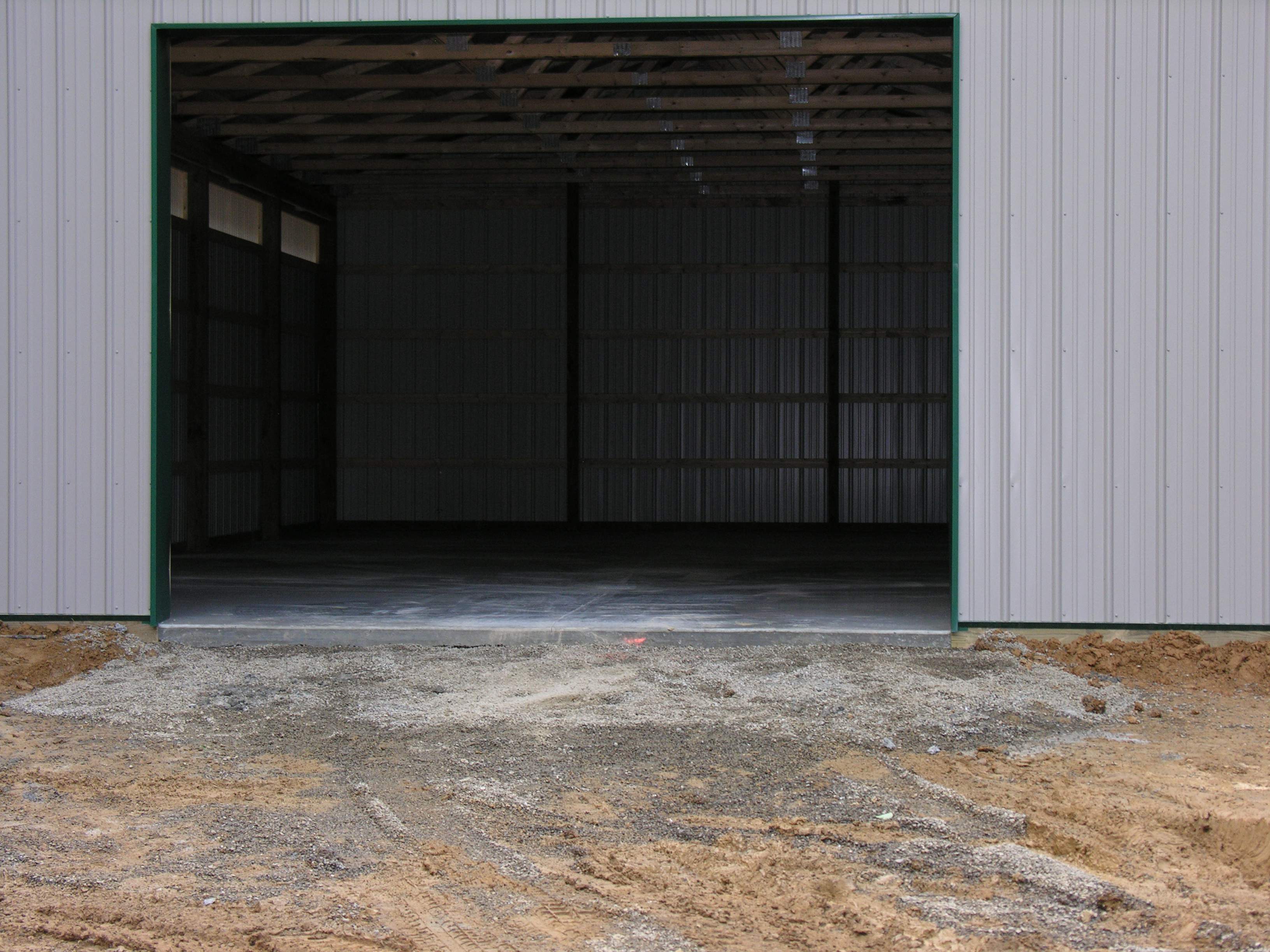

The floor has been poured. Now I just need the overhead door installed and then the rest is up to me. Up first is electrical, apron and finish grading.
