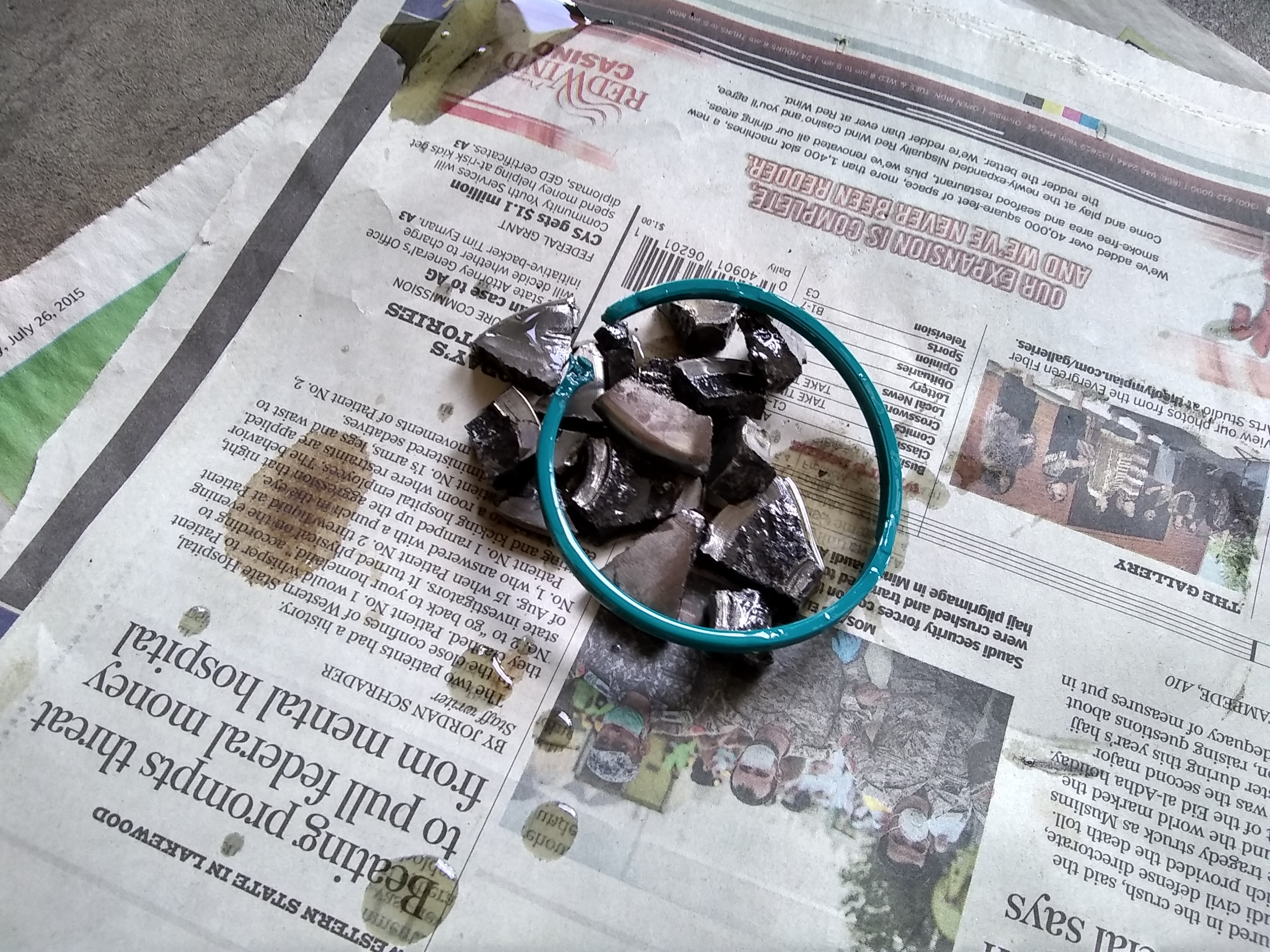

I think the piston has come loose.

Here's what was inside. Parts on order!
   / Pop in FEL Curl Cylinder in my BX25D - Bucket uncurls on own weight #39
Broke Piston.....yea that will do it.
   / Pop in FEL Curl Cylinder in my BX25D - Bucket uncurls on own weight #40
A little JB weld and you should be back up and running :thumbsup: Seriously, was there any scoring on the inside of the cylinder? I would do a very close inspection. If that part failure raised any burrs in the cylinder bore it could tear up any seals you put in.
