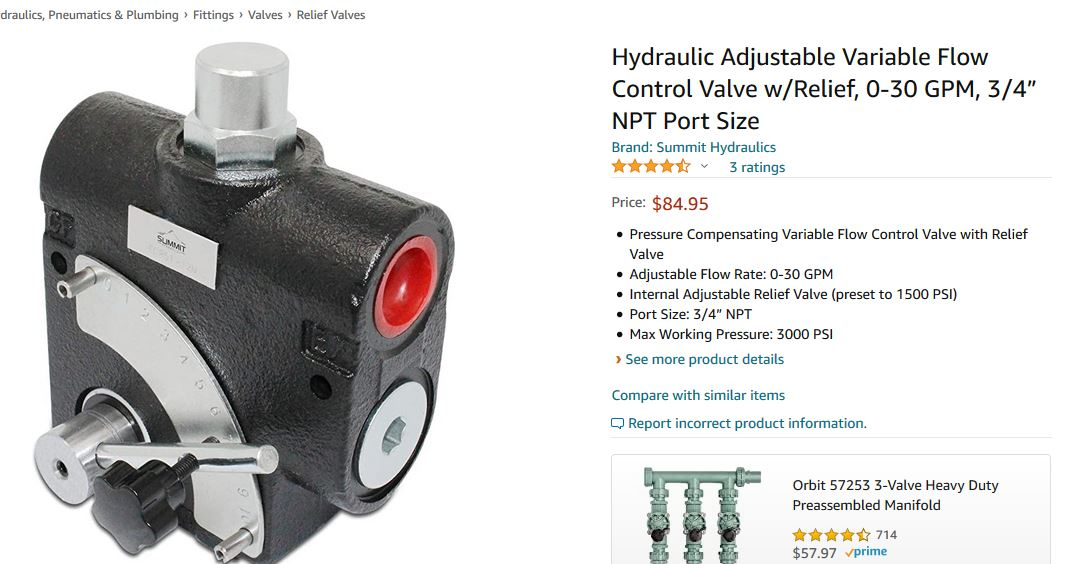

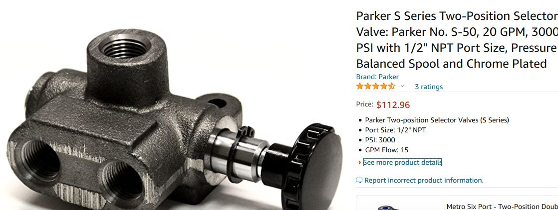

Anyone know if this type value would allow me to run 3pt and pounder? I'm running pounder at very low RPM as it only raised the slammer. I haven't seen one in a 1/4 size but plenty 1/2 or 3/4 to step down.
   / Post Driver on BX25 #4
No. You want a selector valve.

Roger...something like this guy?
