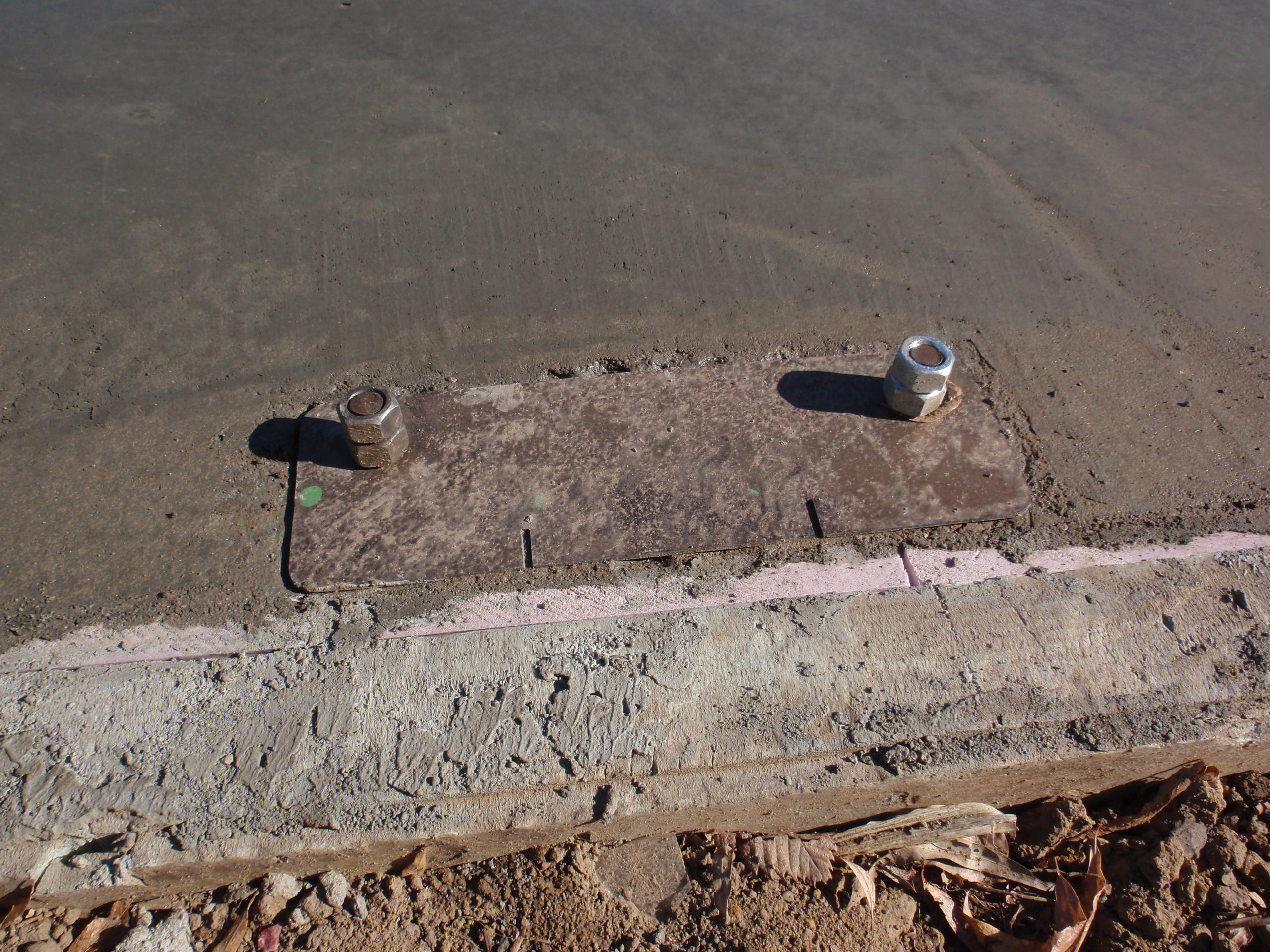

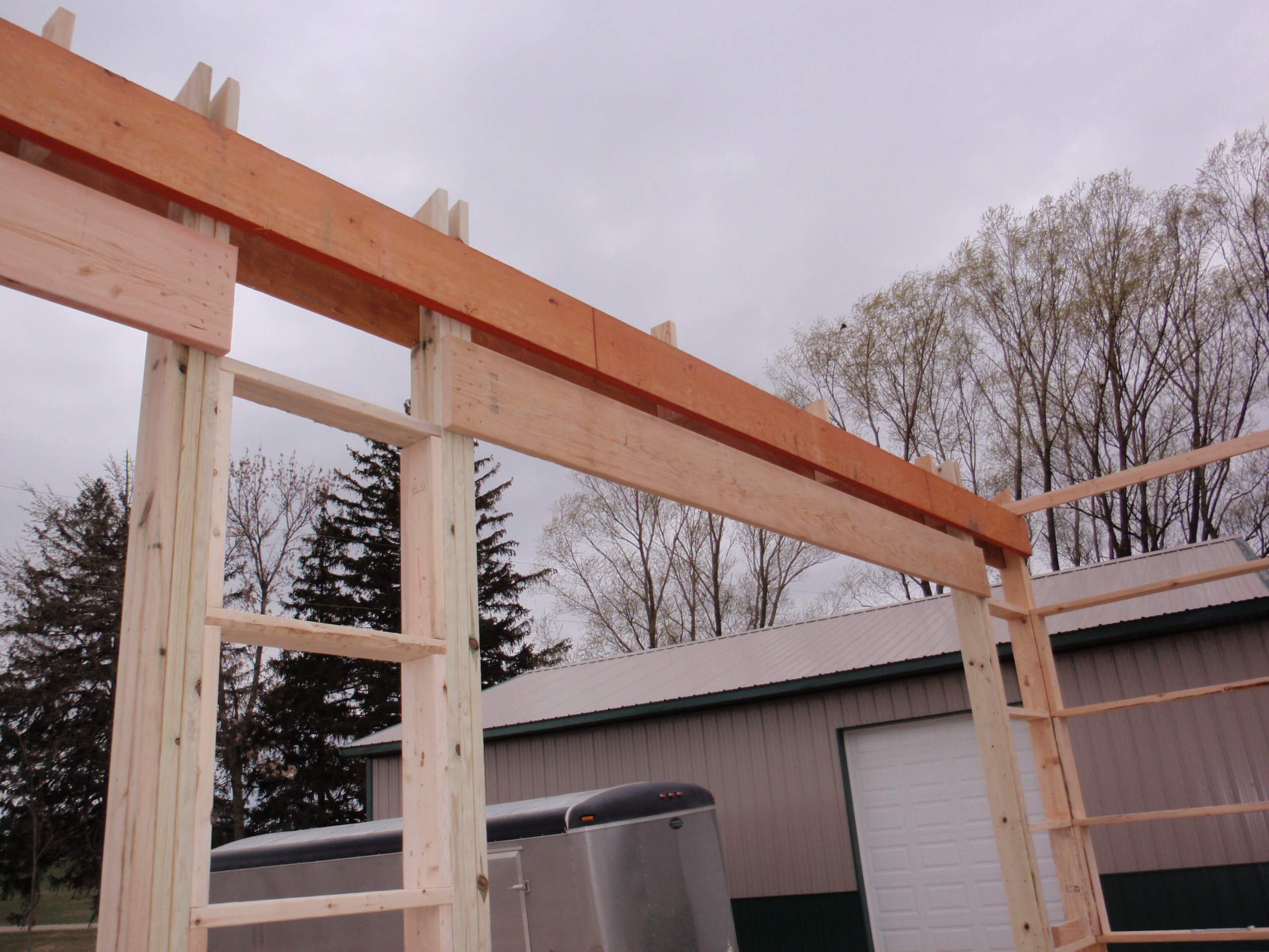

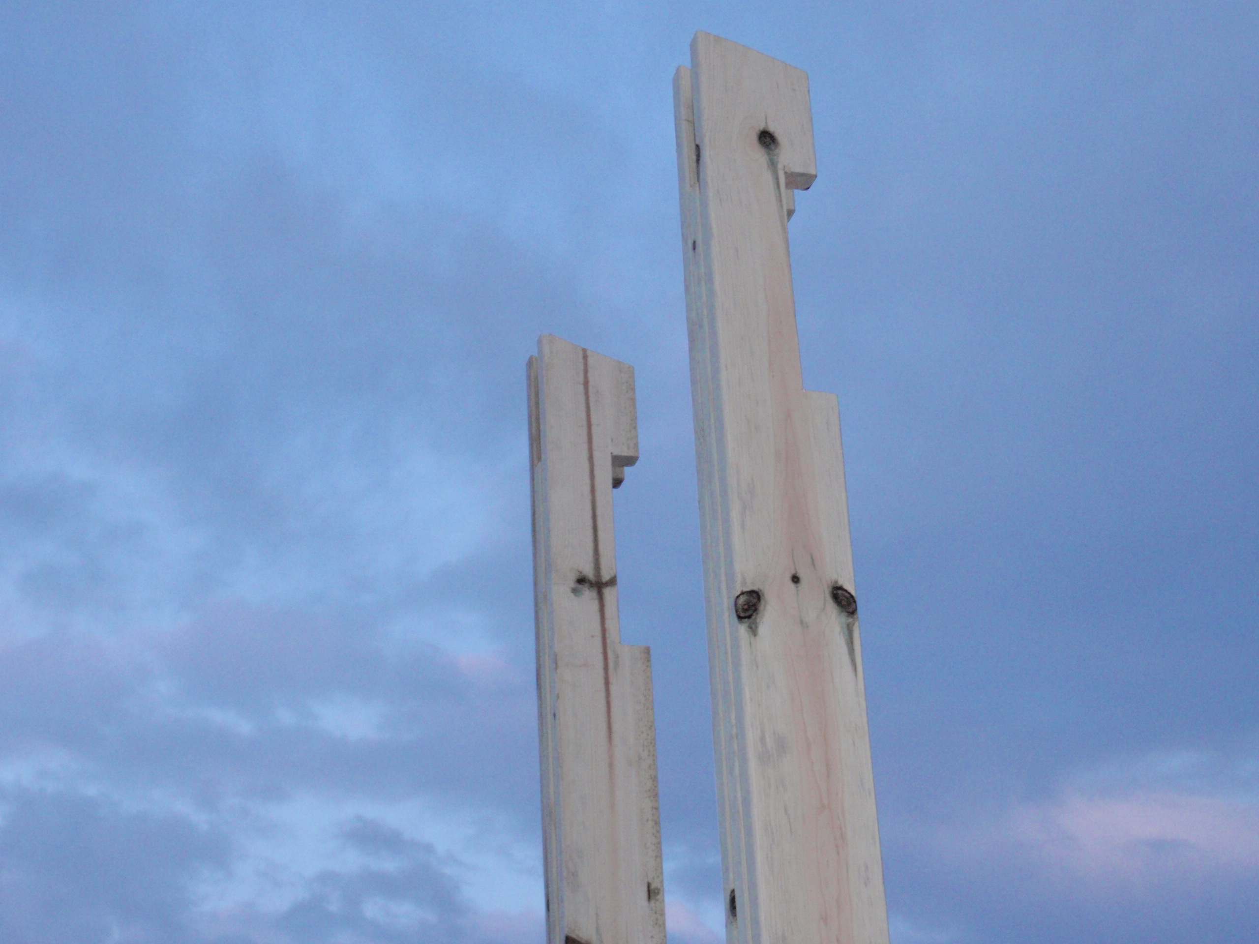

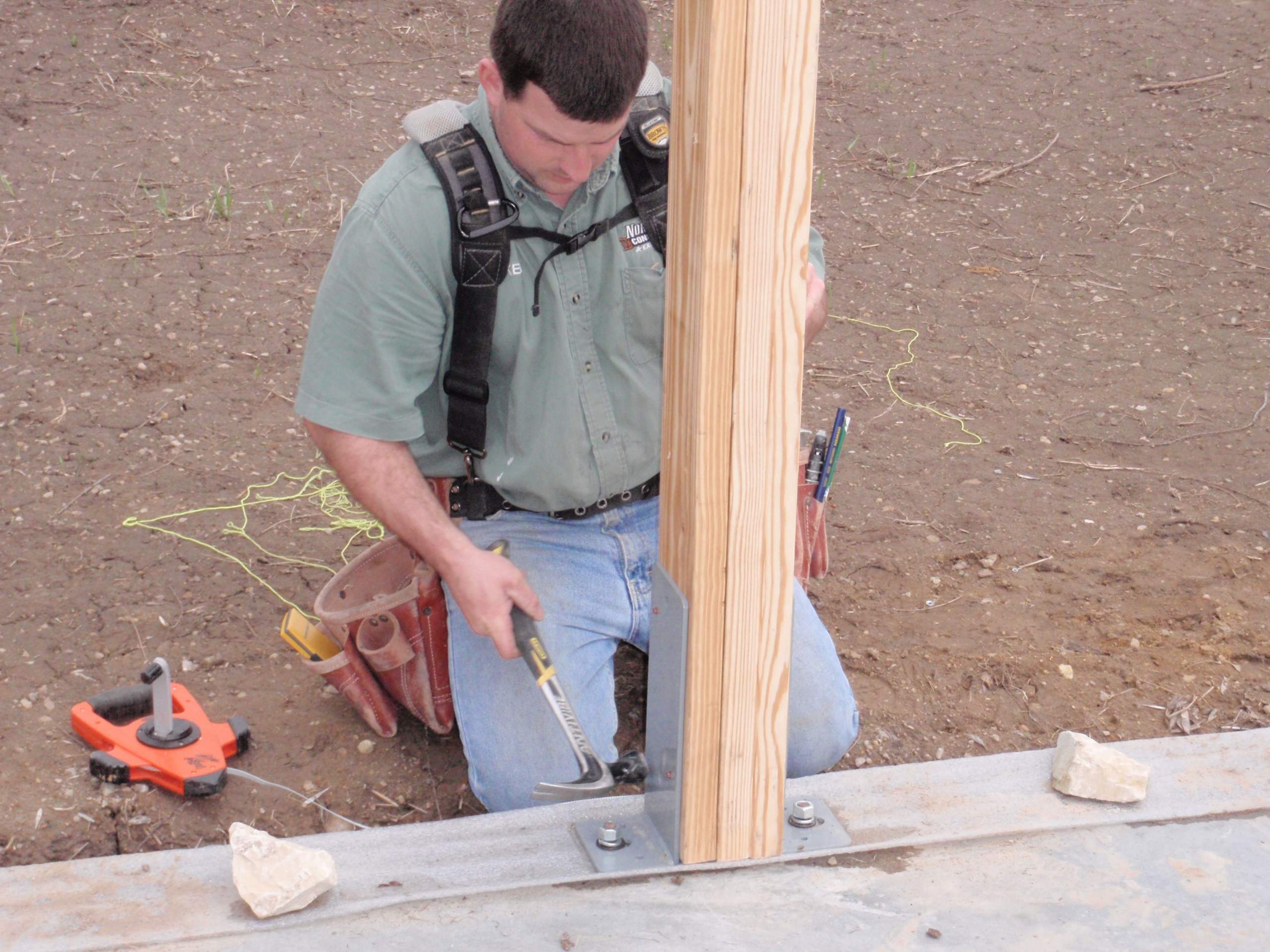

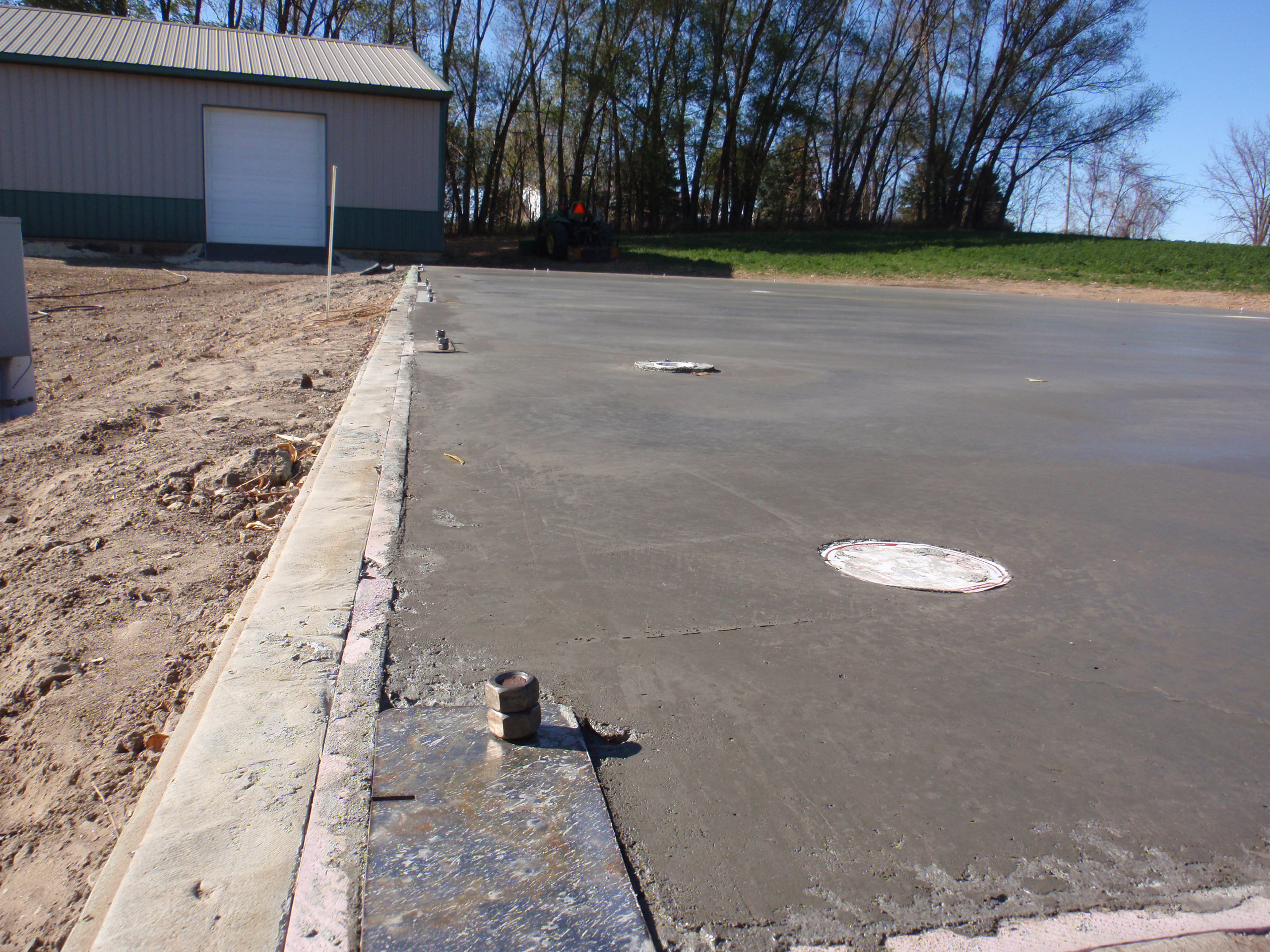

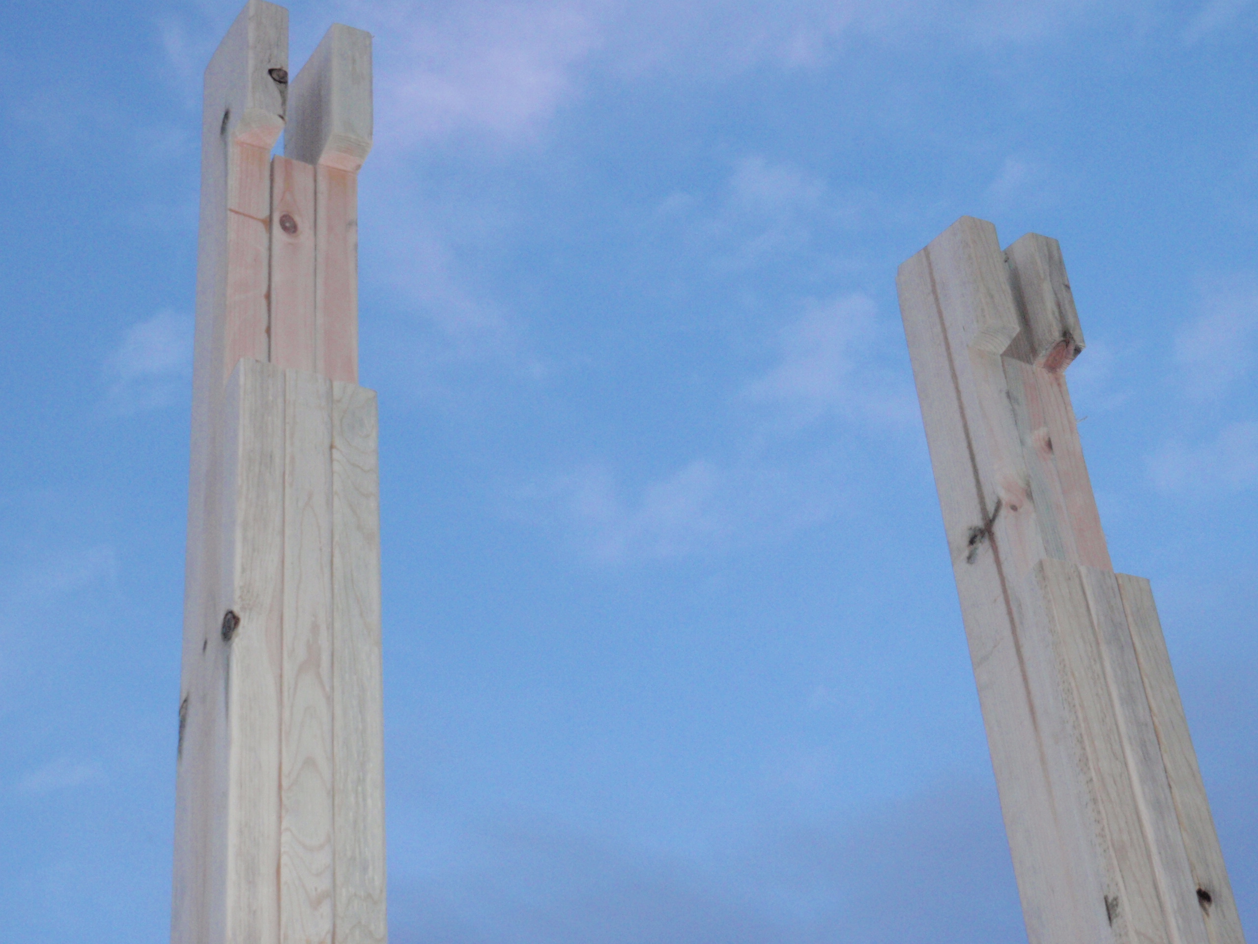

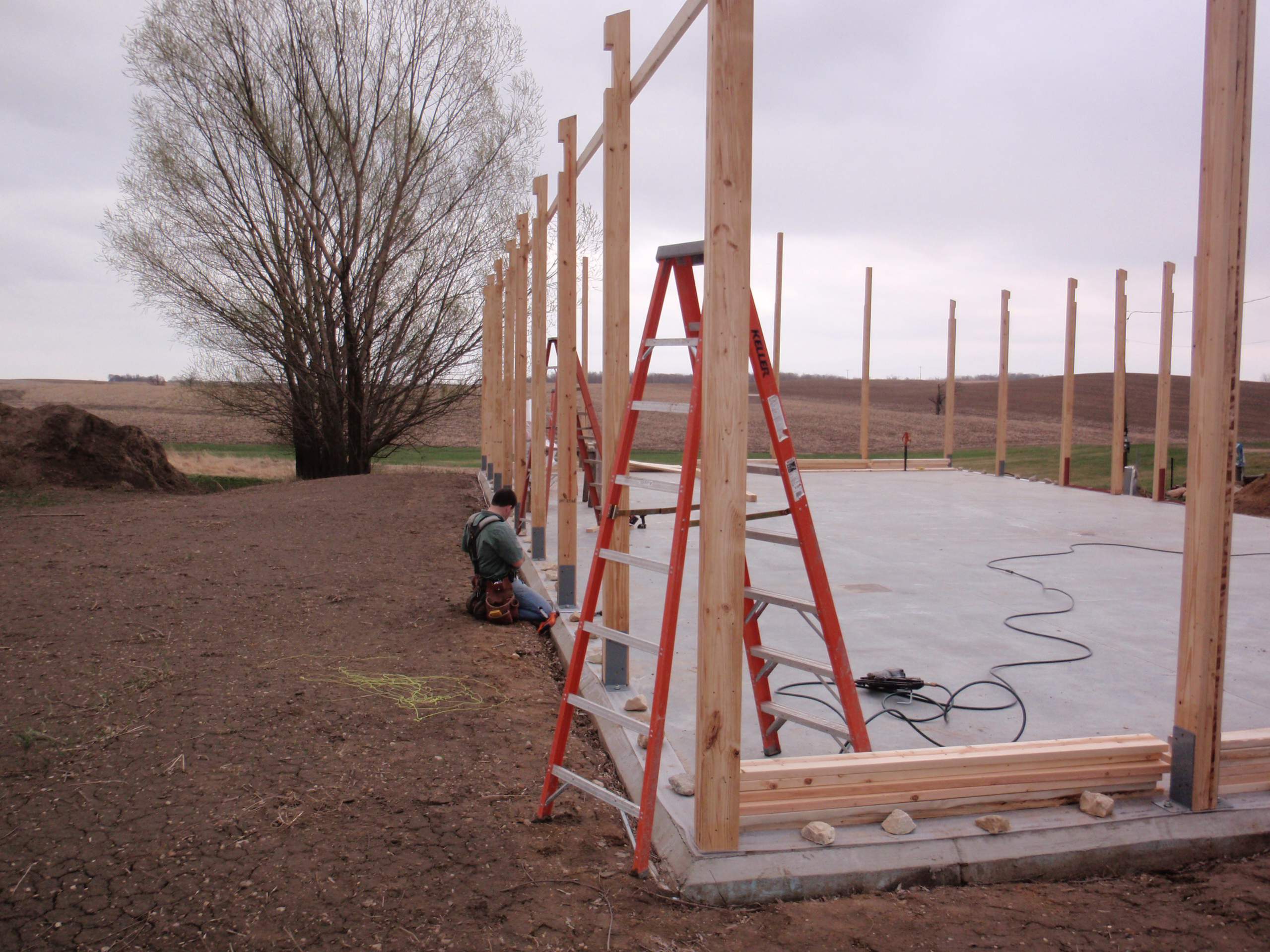

PA200526.JPGPA200529.JPGP3210718.jpgP3200700.jpgP3200701.jpgP3200705.JPGP3200706.JPGHey there, just noticed the discussion flaring up again. I used the Sturdiwall brackets on about 7.5 foot centers. I used the three 2x6 variety, and my builder built the 2x6 poast assemblies on-site with pine. This allowed him to cut the center one to the ceiling height exactly before assembling the posts, so the truss sets in there later just mint. Note, I used the "Drill set" brackets Perma-Column | Sturdi-Wall | Drill Set Models
but instead of driling I wet-set huge J-bolts during the pour, using templates I plasma cut. the j-bolts were 5/8" X 10 I think. Two of them per bracket of course. I remember paying about $17 per bracket. They are 1/4" thick steel, nicely fabircated and welded, and powder coated.
I might as well post a link to a thread I have been keeping up, with the full story of the build, with some great photos too. Its a long thread, but you get the idea just scanning all the photos. http://www.workshopaddict.com/forum/layout-design/146-35x60-shop-design-minnesota.html

View attachment 283009View attachment 283010View attachment 283004View attachment 283005View attachment 283006View attachment 283007View attachment 283008Hey there, just noticed the discussion flaring up again. I used the Sturdiwall brackets on about 7.5 foot centers. I used the three 2x6 variety, and my builder built the 2x6 poast assemblies on-site with pine. This allowed him to cut the center one to the ceiling height exactly before assembling the posts, so the truss sets in there later just mint. Note, I used the "Drill set" brackets Perma-Column | Sturdi-Wall | Drill Set Models
I might as well post a link to a thread I have been keeping up, with the full story of the build, with some great photos too. Its a long thread, but you get the idea just scanning all the photos. 35X60 shop design in Minnesota
Thanks for weighing in. :) Lovely work, by the way.
