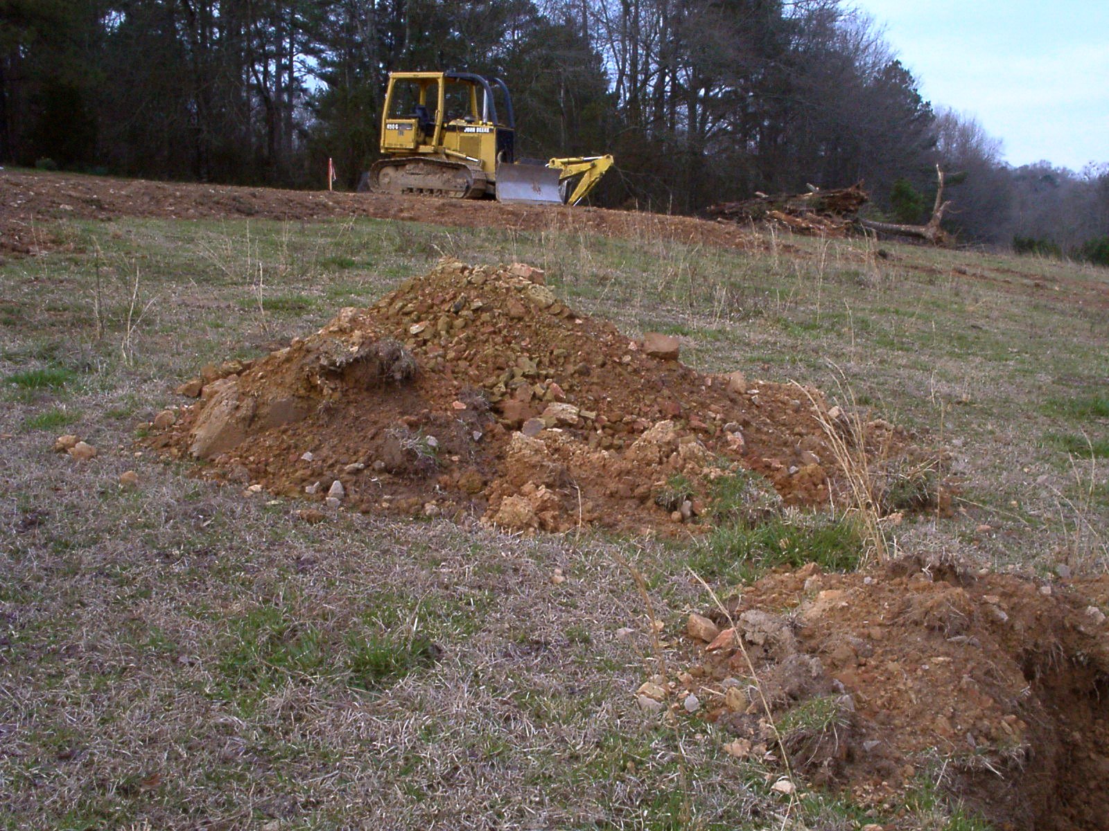

I have a few rocks in my Arkansas dirt also, luckily most of them are below post hole level, but there is a lot of small rectangular rocks 1-3" long that the PHD goes thru fairly easily but there are the occassional ones like the photos that you just have to do something different. The perk test photo is pretty typical of what you find when digging with the occassional super rocks encountered.

I agree. Dug many post holes here in rocky soil of CT. You need to have a good digging bar and a clamshell post hole digger to clear those pesky rocks out of your hole so the auger will penetrate further. Some holes you can dig right down no prob. Others you need to stop and clear out maybe two or three times. It's a crap shoot, but it can be done.

And JohninCT has the answer to rocks in the way of an auger. Pick them out and move further down with the hole.
