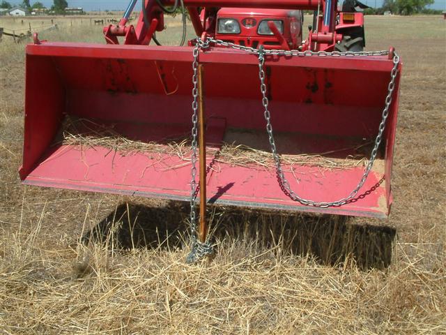

Be careful. You need to make sure that you're pulling line is centered on the bucket side-to-side so you don't end up twisting the torque tube between the FEL arms. Sometimes one of those old posts can be really tough to pull and the hydraulics on your FEL are strong enough to really mess up the FEL arms and bend the bucket sheet metal if you're not careful.
Here's the setup I used a few months ago to remove a bunch of T-posts
My FEL bucket has grab hooks on the outside and a D-ring slip hook in the middle. My tractor is a 2008 Mahindra 5525 that weighs about 6000 lb with the ML250 FEL that has 2960 lb lift capacity at the bucket pivots. Several of those T-post were bent underground and really challenged the pulling power of my FEL.
