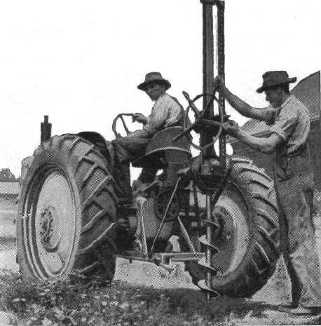

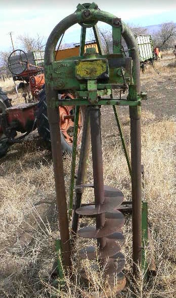

I've often thought the old style would be better for more precise work. It's more like a drill press and less like a hand drill on a stick.
Bruce
   / Post Hole Digger on a Sub-compact Tractor #10
View attachment 532085 View attachment 532086
Bruce
I'm considering building one of those; when I put in a new privacy fence a couple of years ago, the auger went everywhere (clay and rocks). It would be pretty simple, I have the steel. I would use a hydraulic cylinder for downfeed and lift, and have "feet" that contact the ground so that pulling out the auger bit doesn't rely on the 3-point. First to install "top'n'tilt", which would greatly increase the utility of the "dirt press".
