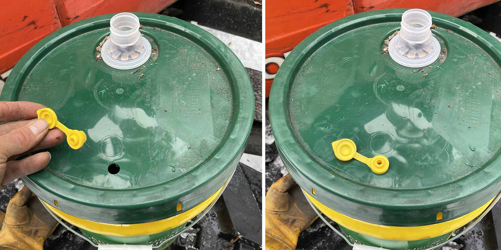

Drill a 1/2" hole and snap this vent in first thing, before you pour the first gallon.
These yellow vents are all over the internet, search "fuel can vent".
I got 10 for $9.
If you're gonna pour all 5 gallons out, then maybe you just drill or punch a hole & don't have to bother with the snap-in vent.

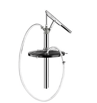

Drill pump for hydraulic oil:
Hand pump for gear oil:
My back thanks me every time for spending that $50 for the pair of these.
