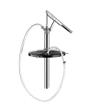

I used to lift one 5 gal bucket under each arm but then I bought this:
yes to this, works perfectly for me. why lift, pour, & spill when you can do this?
@15 gal hyd change, only way to go. in addition just purchased a 12v transfer fuel pump that i may consider next change as well

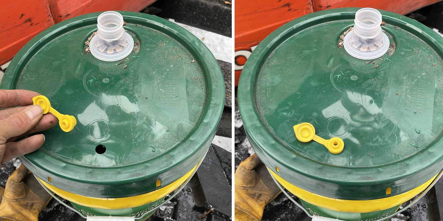

Drill a 1/2" hole and snap this vent in first thing, before you pour the first gallon.
These yellow vents are all over the internet, search "fuel can vent".
I got 10 for $9.
If you're gonna pour all 5 gallons out, then maybe you just drill or punch a hole & don't have to bother with the snap-in vent.
never thought of those. think i will order some. just ordered some of the screw in ones for gas cans, the kind you pull through with a wire and have a screw on cap.
at being a really old age it seems like anything you do now when poring is a chore.

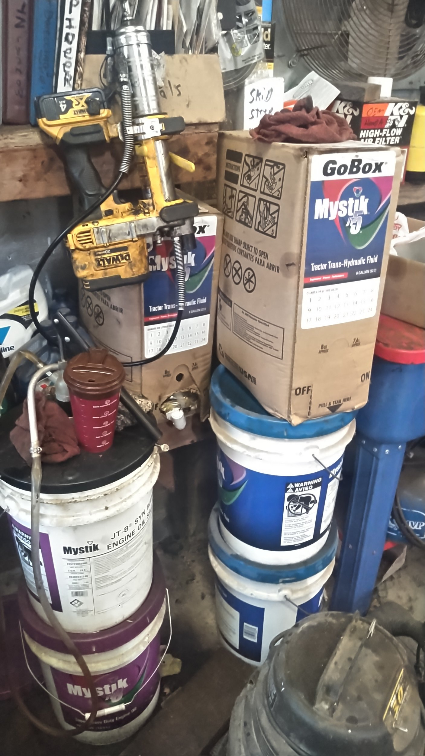

Mystic oil was offering these 6gal containers for hydro trans oil, when they went on discontinued clearance at Blain's I bought them out. Ive been using mystic hydro and engine oil for over 5 yrs and in my experience with it both my Kubotas seem to like it. The "go box's" are so nice and my boxes or spouts have not leaked,I have no idea why they discontinued them?? Back to pail pump when I run out.
