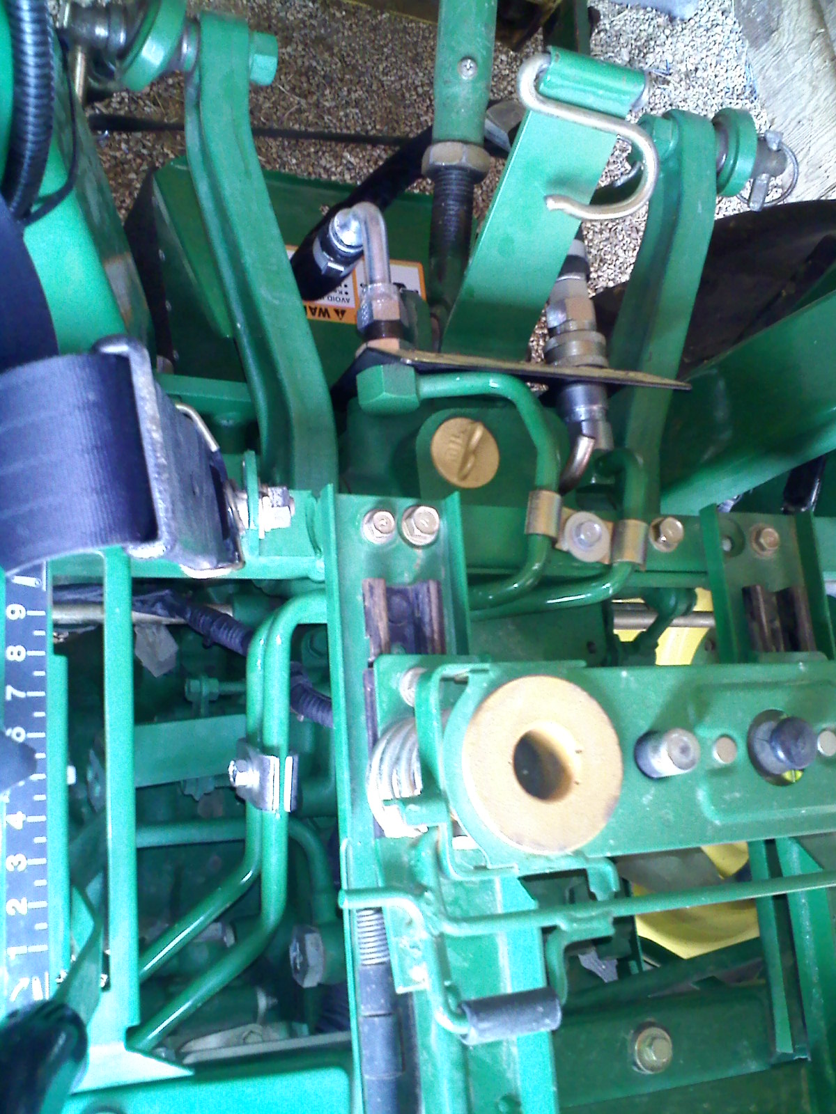

I got home and had a look at my tractor. UN-fortunately, I cannot see a thing with the cover in place under the seat (it's off in the photos you posted). Let me know how badly you need the info, it looks like I could pop that cover off pretty easily if you want.

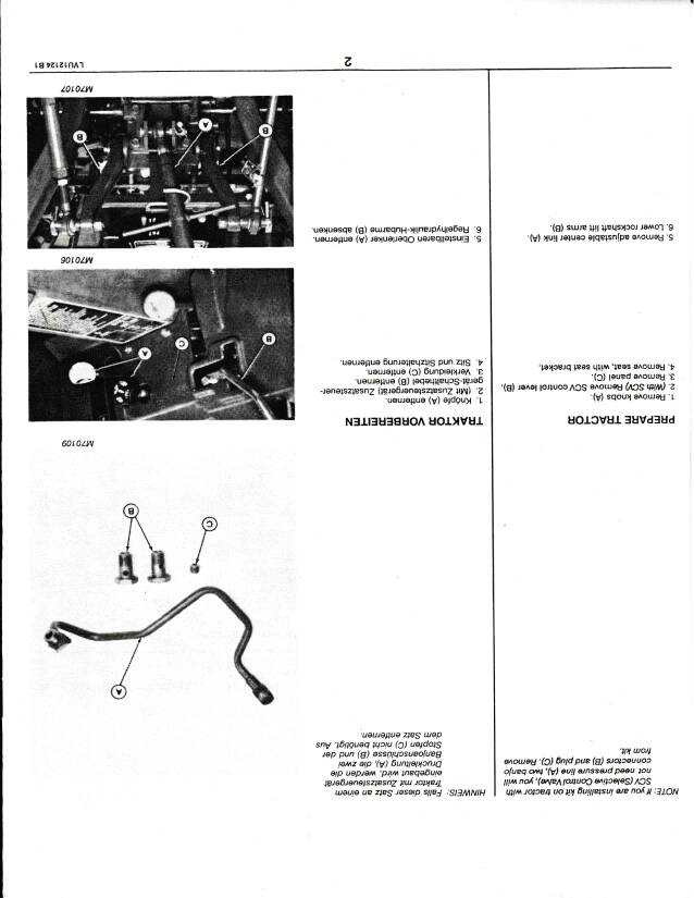

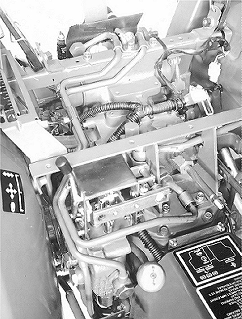

And I have the parts catalogs for the 7 and 790. There is an exploded view of the PB kit but it's not very clear where each connection attaches. There are 3 solid lines shown but one must be for tractors without the DSCV control. Assuming you have the DSCV for your loader, it appears that both lines tie in there and not the rockshaft cover.
Rob,
It looks like jd110 has a copy of the instructions, so no need to pop the cover off of yours, but thanks for offering. I too have seen the exploded view from the parts catalog, and I agree it is not very clear in the picture as to where the lines connect. The best photos that I have seen are this one
and this one
you are correct, I do have a DSCV for my loader. If I can get the directions from jd110, then I will try and find a way to post the directions here for all to use.

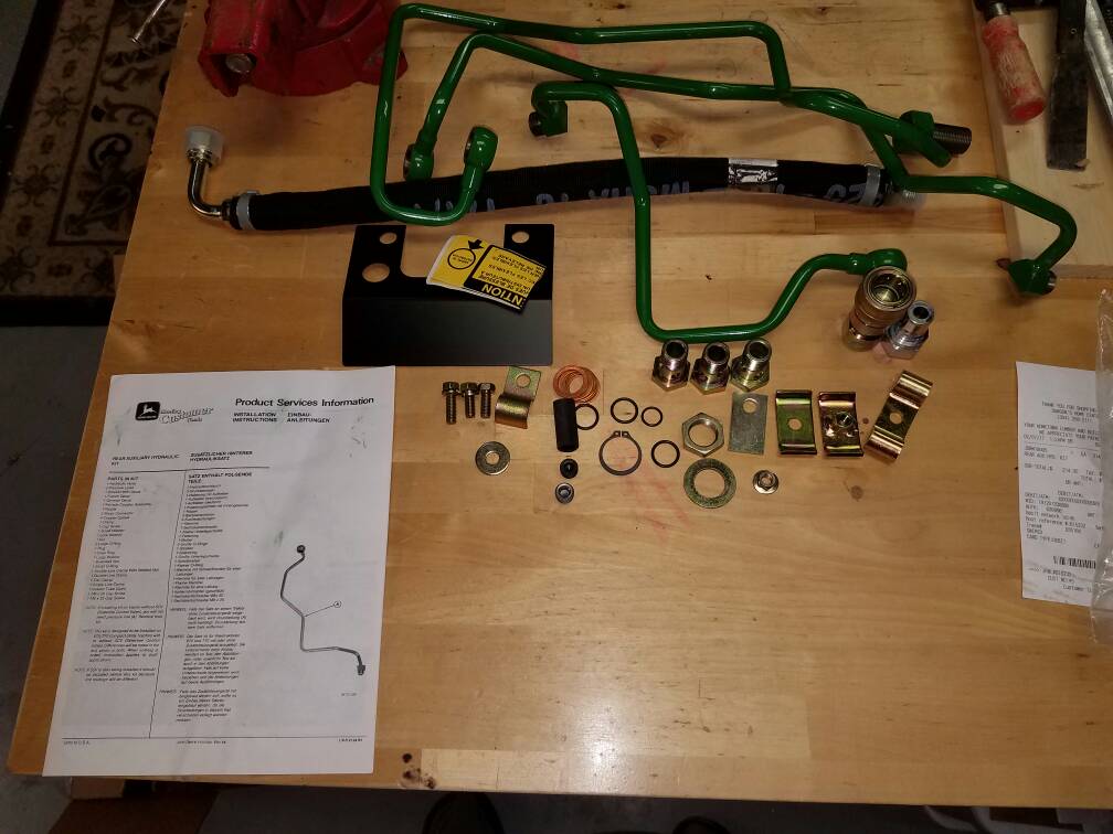

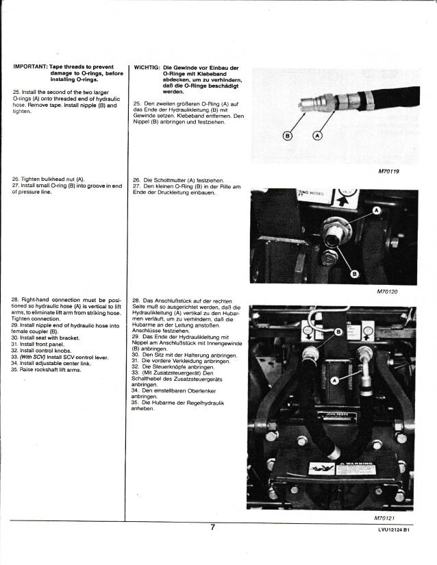

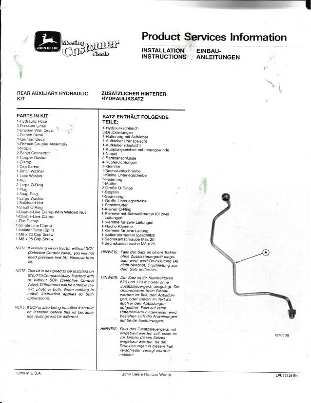

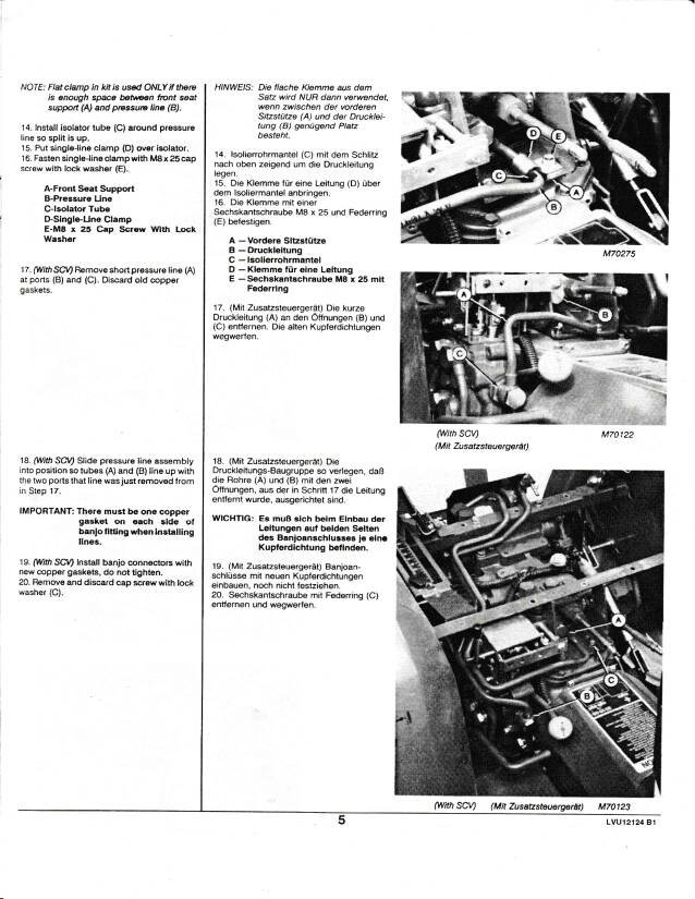

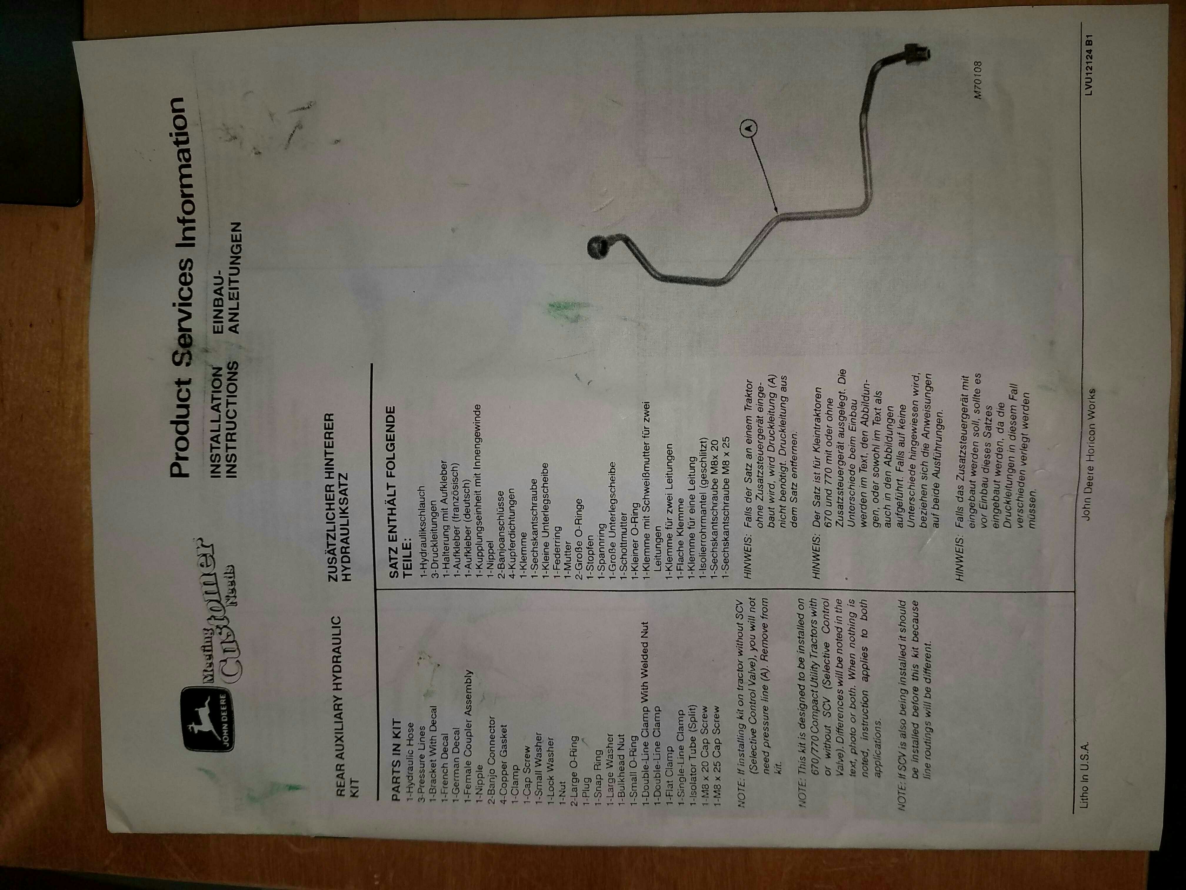

I just picked up a complete kit from my local dealer with lots of dust on it. I was shocked when the parts guy said "Yep we have one in stock". Any who I will start the bidding at one million dollars If anyone needs the instructions let me know I will try to get them uploaded to Google tonight. Here are a few pictures of this rare gem.20170207_172142.jpg20170207_171552.jpg1486506629340.jpeg

I just picked up a complete kit from my local dealer with lots of dust on it. I was shocked when the parts guy said "Yep we have one in stock". Any who I will start the bidding at one million dollars If anyone needs the instructions let me know I will try to get them uploaded to Google tonight. Here are a few pictures of this rare gem.View attachment 497976View attachment 497977View attachment 497978
Wow!!! you appear to have found the needle in the haystack! can you e-mail me the directions? Jeffreymerritt2003@yahoo.com
Much appreciated!
   / Power Beyond - JD 790 #24
I believe the op said that he was going to post the directions.
To the op: You lucked out just like I did when I bought a mid pto kit for my 4410. I found it on Kijiji about 2 hours away. $250 cash for a $1500 kit was a deal I couldn't pass on. Glad you were able to find something.
   / Power Beyond - JD 790 #25

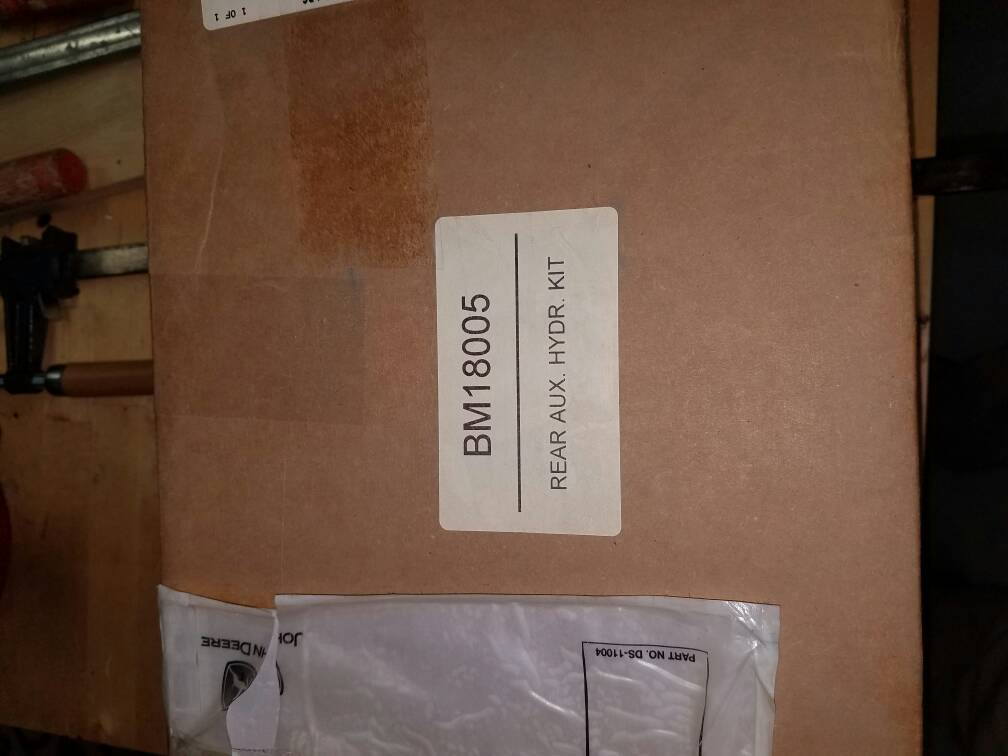

Do you mind saying what you paid for it? I have a line on a BM18005 kit for just over $300. I'm wondering if I should get it even though I might never be able to find a #7 or a Woods BH70 for my 790.
