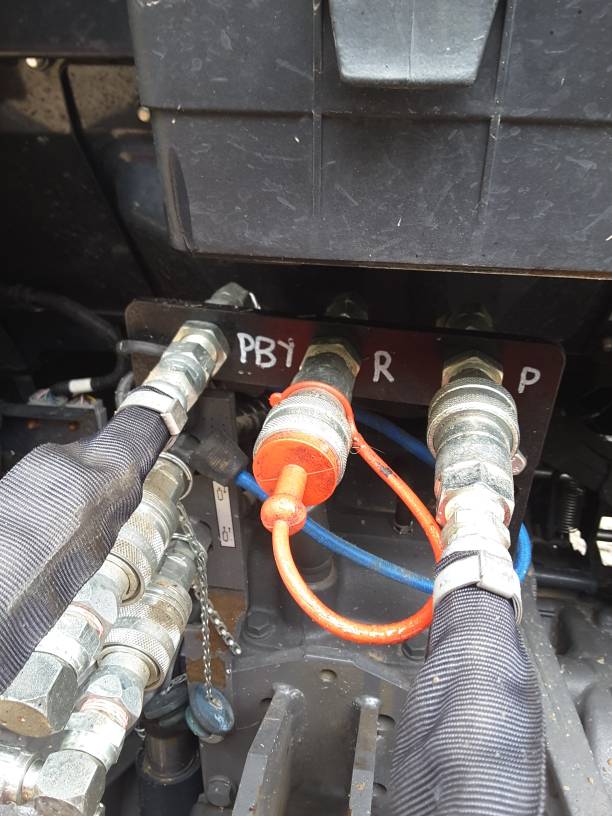

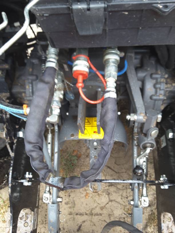

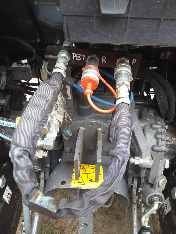

The backhoe has two lines and they plug into the pressure and return lines and I was told that to operate the loader or drive the tractor you have to disconnect them and loop the short power beyond hose into the pressure line otherwise damage would result.
It just doesn't make sense to me that it would be such a time consuming hassle to have to switch the lines every time you want to get off the back hoe and move the tractor or use the loader and go back to the hoe.
I am in Montana this week the tractor and all of my manuals are in Nebraska I don't recall seeing a hydraulic circuit diagram but I can double-check there might be. 20200910_124305.jpg20200910_124234.jpg20200910_124258.jpg

You don't have to. It actually makes no sense at all. I don't know why the dealer came up with it.
I've already answer this before. There is some misunderstanding between you and the dealer.
If you have the backhoe attached to the tractor, lines connected. You can use the tractor and loader just fine without messing the lines.
Once you take the backhoe off the tractor, you must close the loop again between P and PBY in the back. Then you're good to use the tractor and loader as you please.
You don't need to mess with the hoses every time you use the loader.

I think maybe didn't accurately clarify what I was trying to do, and why. I'll add some further info.
The bypass I'm envisioning (hydraulic rated ball valve or something similar) is for when the backhoe is still connected to the tractor.
What I want to do is essentially be able to dig with the backhoe, jump in the cab, drive the tractor and use the loader to move dirt and get back on the backhoe and dig some more holes. That's the scenario in a pretty package so to speak.
The problem is this....
The Agco tech, service manager and the afixed warning labels are telling me that when you are using the power beyond, whether for a hoe, log splitter, ect that you have to disconnect the attachment and loop it back before you can use the loader or drive the tractor (except for creeping forward IE digging a ditch.
That is a huge pain in the **s when you are doing a job that requires using the hoe and loader back and forth.
Because of this i was thinking making a circuit with tees and valves to switch back and forth without having to turn off, relieve pressure, disconnect, reconnect over and over in a day.

On my tractor (JD 5055E) without the backhoe, there are 3 hydraulic lines. Power, return (which is also a power beyond line), & tank. The pump goes to the FEL, the output of that (return w/PB) goes back into the transmission to operate the 3PH lift. The tank line from the FEL goes back to the tank as a drain line.
When I put my BH on, it is inserted between the FEL and 3PH lift. The BH valve does not have a PB port, the output of the valve goes back to the tank as a drain line. Therefore the 3PH lift does not work when I have the BH on since there is no fluid to it. If I were to connect the output of the backhoe to the input of the 3PH lift it will move up and down, but not recommended for several reasons and no room for 3PH implements.
Now, 1 more thing. Since I am inserting the BH between the FEL and 3PH, when I take the BH out of the circuit I have to connect the FEL return line (PB line) to the input to the 3PH which is essentially bypassing the BH circuit. I do not have to do this to use the FEL or move the tractor when the BH is mounted and connected. Essentially when I remove the BH, I'm "breaking" the hydraulic line and have to reconnect the ends together.
