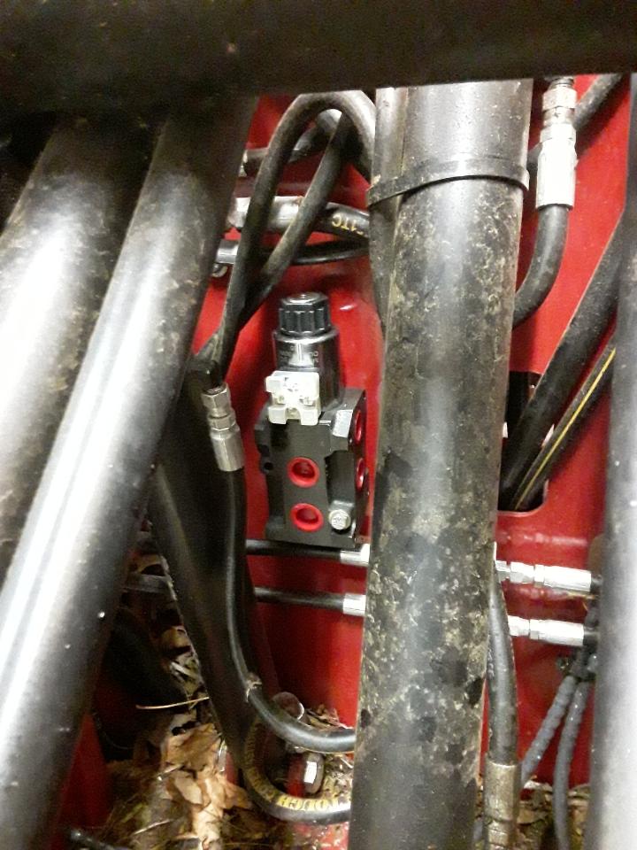

Re: PowerTrac Specific Modifications JOY STICK 3RD VALVE
Finally started to install a electric joystick operated 3rd valve option on my PT1430. I dislike having to disconnect the quick attach hoses every time I change the implement and reconnect to the implement (that and having to take my hand off the control lever and find the PT 3rd valve by my knee, then back up to control lever). I purchased "Hydraulic solenoid operated selector diverter valve 12 volt DC", part number "DSV0812VDC" off ebay. (The one sold by Summit has a 7th port for a drain, that I didn't like)
The valve was the first part to come in the mail, so I engineered a good spot for it on the tractor.
I changed the quick attach hoses over to a new location and install new holders. I figured the original location worked good for attaching the implement hoses that will now come from the diverter valve.
Now waiting for fittings and the joystick to come in the mail.
More to follow as work progresses.

Mine would not fit there so I put them on the bottom ledge. I added two valves so I could add an additional circuit for things like the v-plow or the swinging mini hoe.
Ken

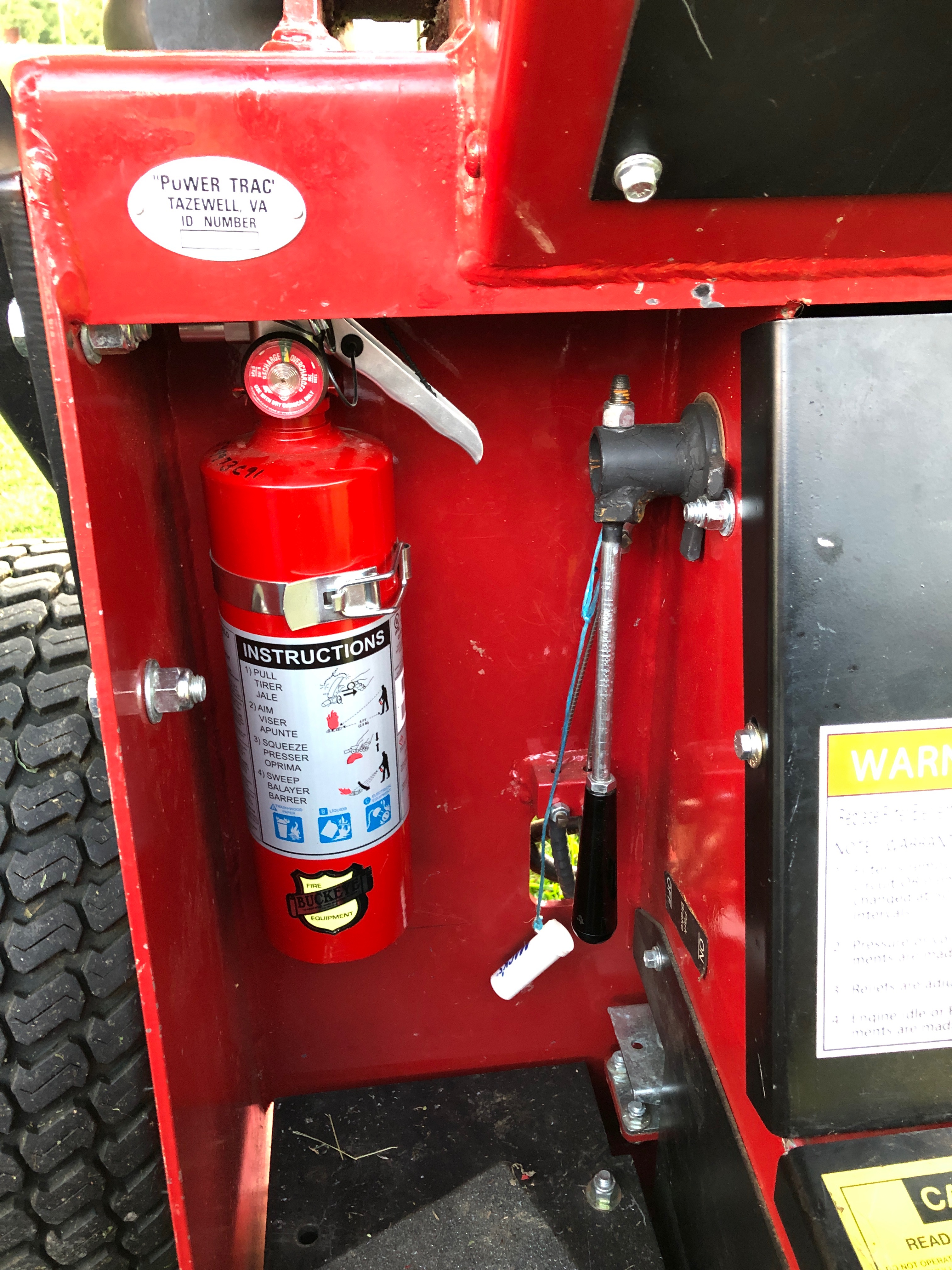

After seeing several people say they left the key in the on position
I decided to add a keychain.
And start removing the key every time I shut down for the day
Feels like back 20+ years ago, when I was a forklift operator, and we had to remove the key anytime we left the machine.
