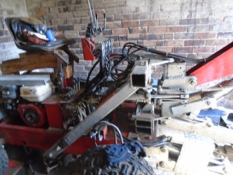

I do have a towable I am working on but it has been butchered by a past owner in the swing area, destroying its balance. I have at last got together the info/measurements for the missing part to convert back, Have made full scale wooden 3D mock up of kingpost & boom area to prove success. Should look like this at bottom of page when finished, machine owned by Shaun is closest

Hopefully Pic of machine - the swing system of a cat 2 3pt Twose hoe was fitted - bringing the swing post 20'' forward. This means the rear wheels barely stay on ground - I have the original underfloor swing cyls & chain. Also the driver no longer swings behind the hoe as a 'living counterweight'
The Deere 310 looks a nice machine, about on a par with a Case 580? Deere used to manufacture in Mannheim Germany - but no longer sell construction range at all in Europe - pity

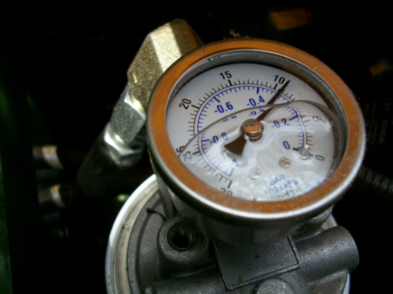

PT180 Hyd filter change, rest gauge
It is 2 weeks before the 1 year anniversary for my PT180 and it came up to the 50 hr filter change. While I was at it, I installed a restriction gauge to monitor the filter health. This time I used a better fluid filled gauge. No pretty red/yellow/green but the needle holds nice and steady. When I finished it was a cold start at 70 deg ambient temp. The first pick shows restriction with new filter at idle, 2nd pic shows at high idle. Interesting the 3rd pic shows the restriction after 1 hour use and the oil temp at 160 deg. I would have thought it would have been lower then the cold start.
Just figure I would mention again, but I pulled the magnet I tether to the filler cap and wiped it off with a clean paper-towel, see what the pic showed of debris collected on the magnet.
Also I pulled the spark plugs out to assist with bleeding the tram (so the starter doesn't have to overcome the compression). I found it somewhat concerning that the threads seemed to have carbon deposits indicating the plug projects into the cylinder. Can that be? I would have thought they should be flush. Anyway, I put some neversieze on the plugs and buttoned it up for the next 50 hrs.

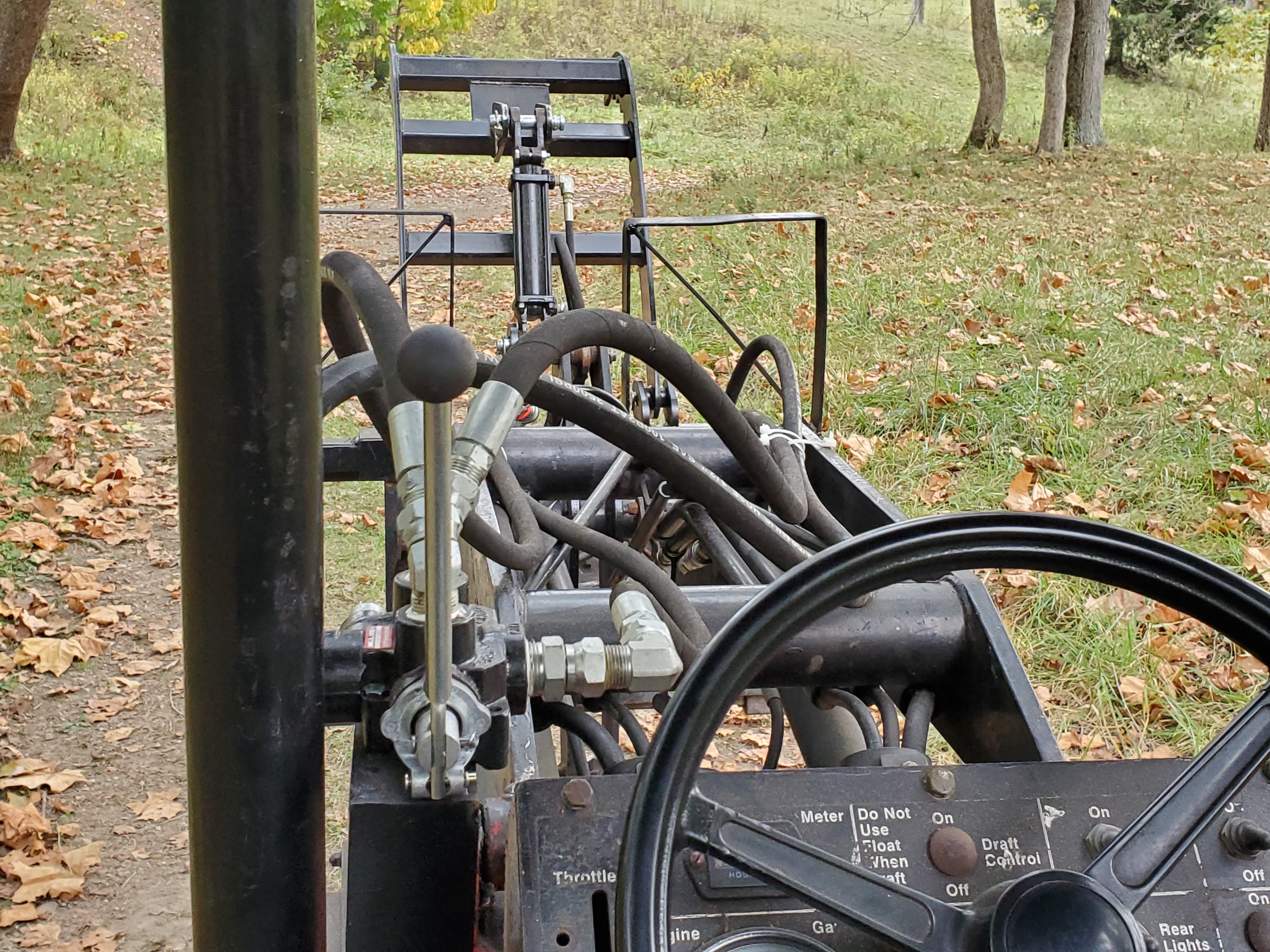

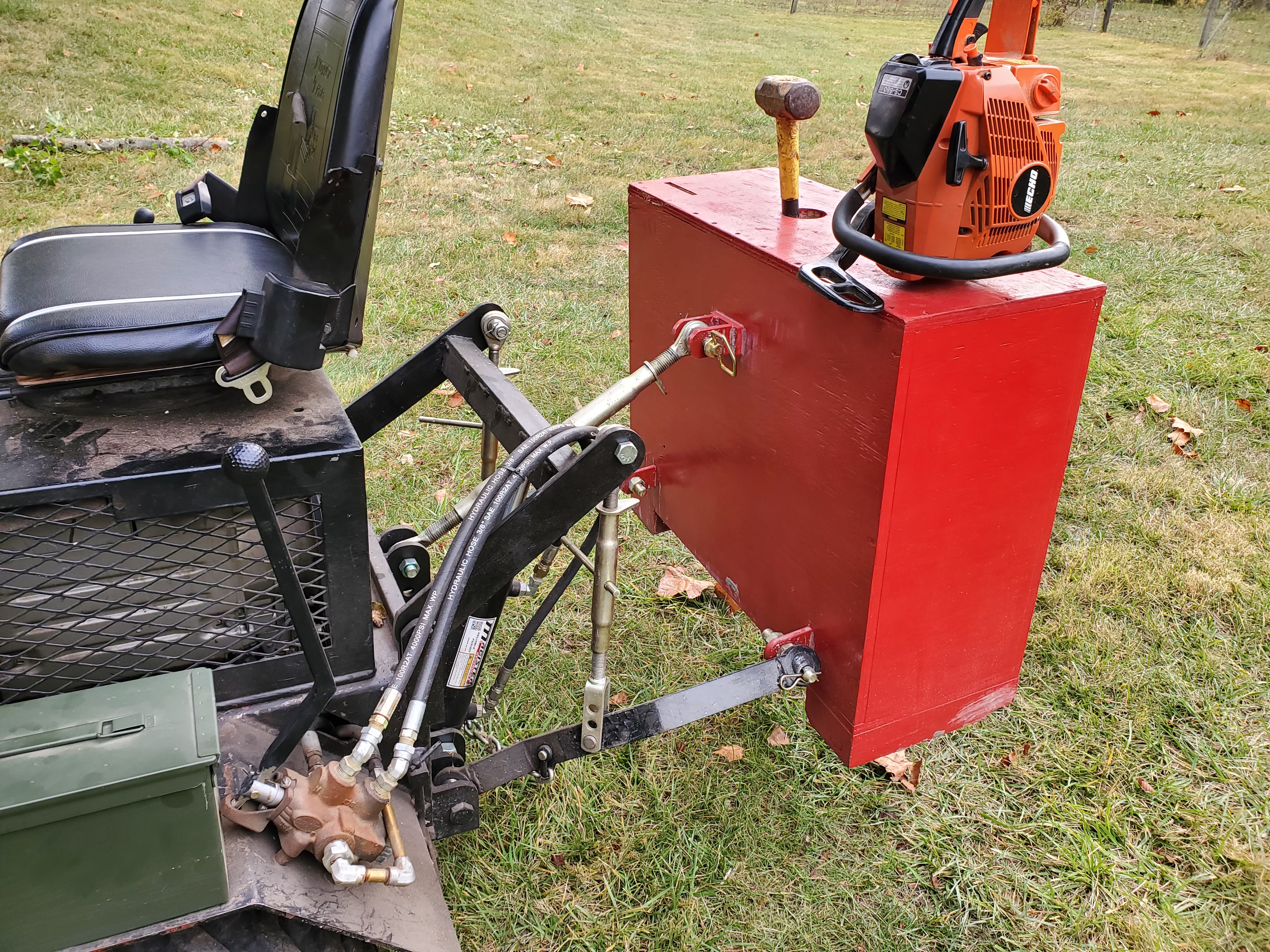

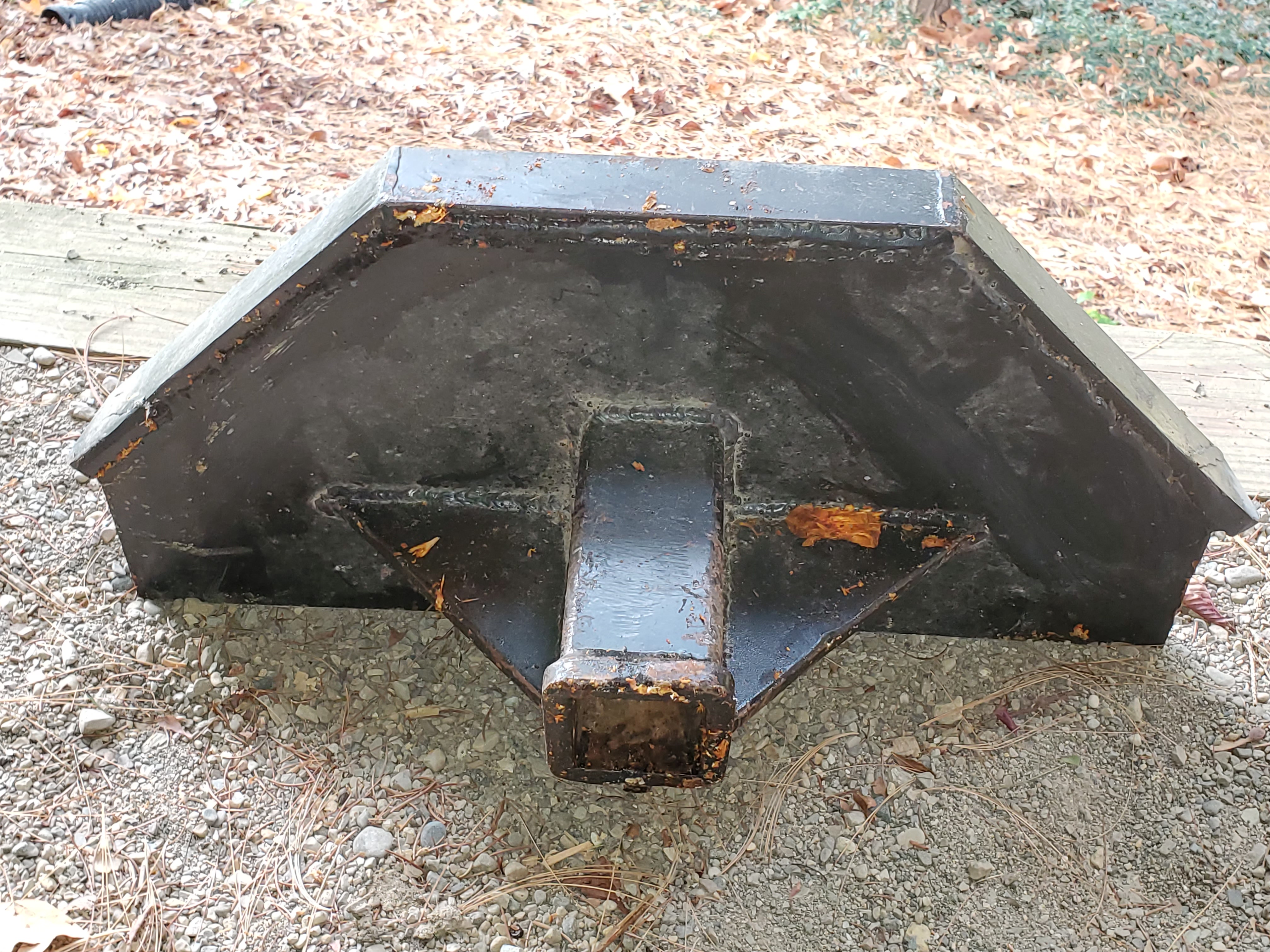

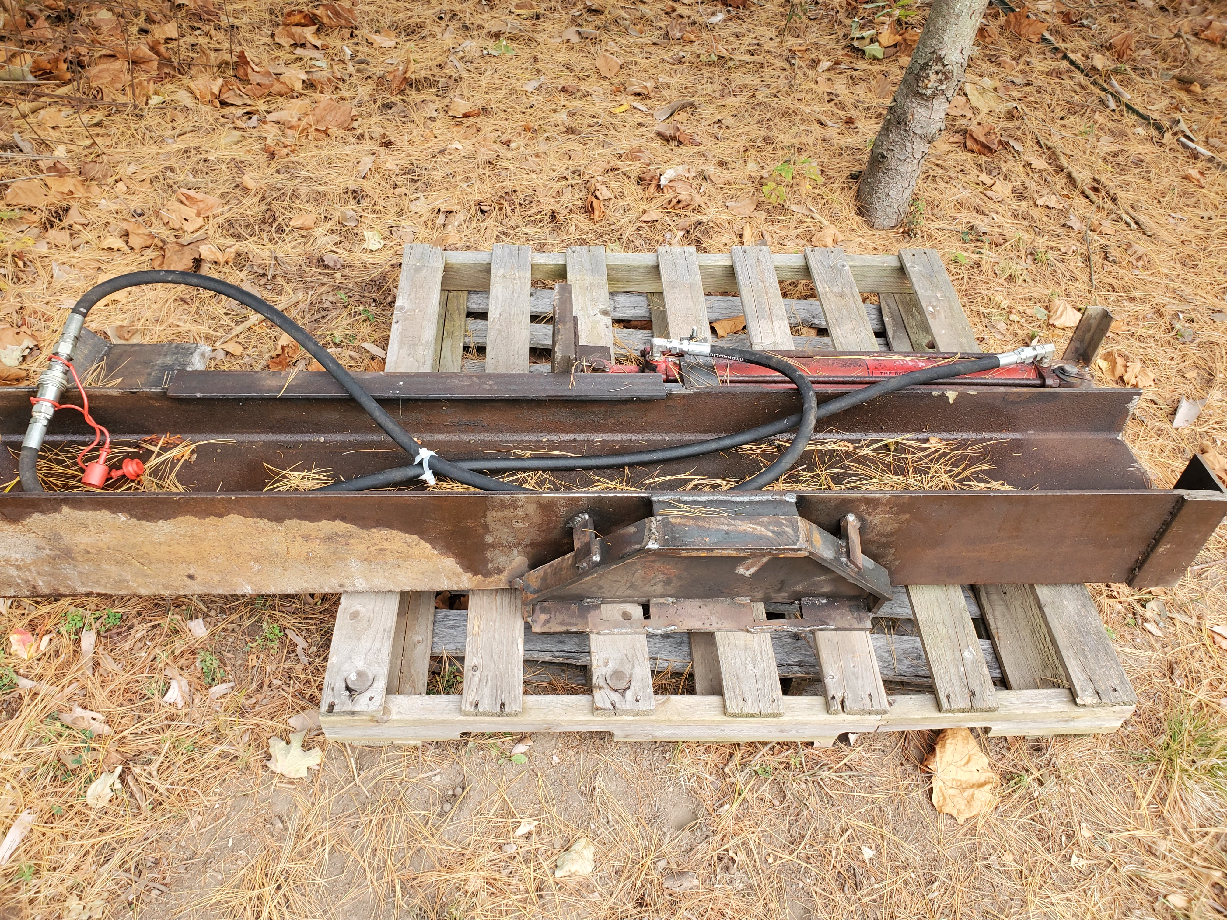

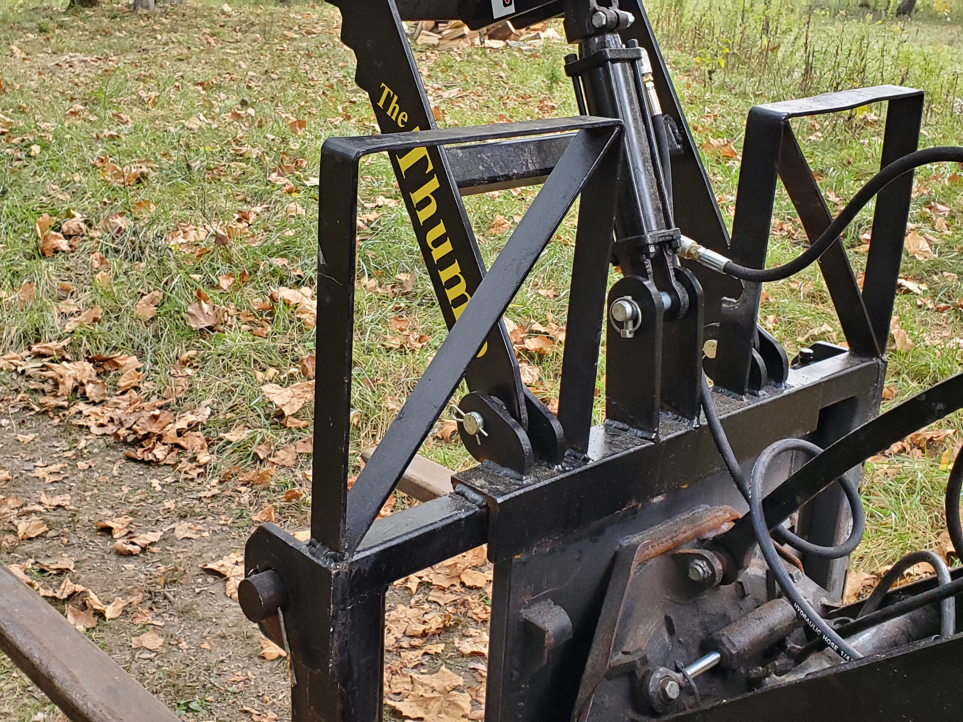

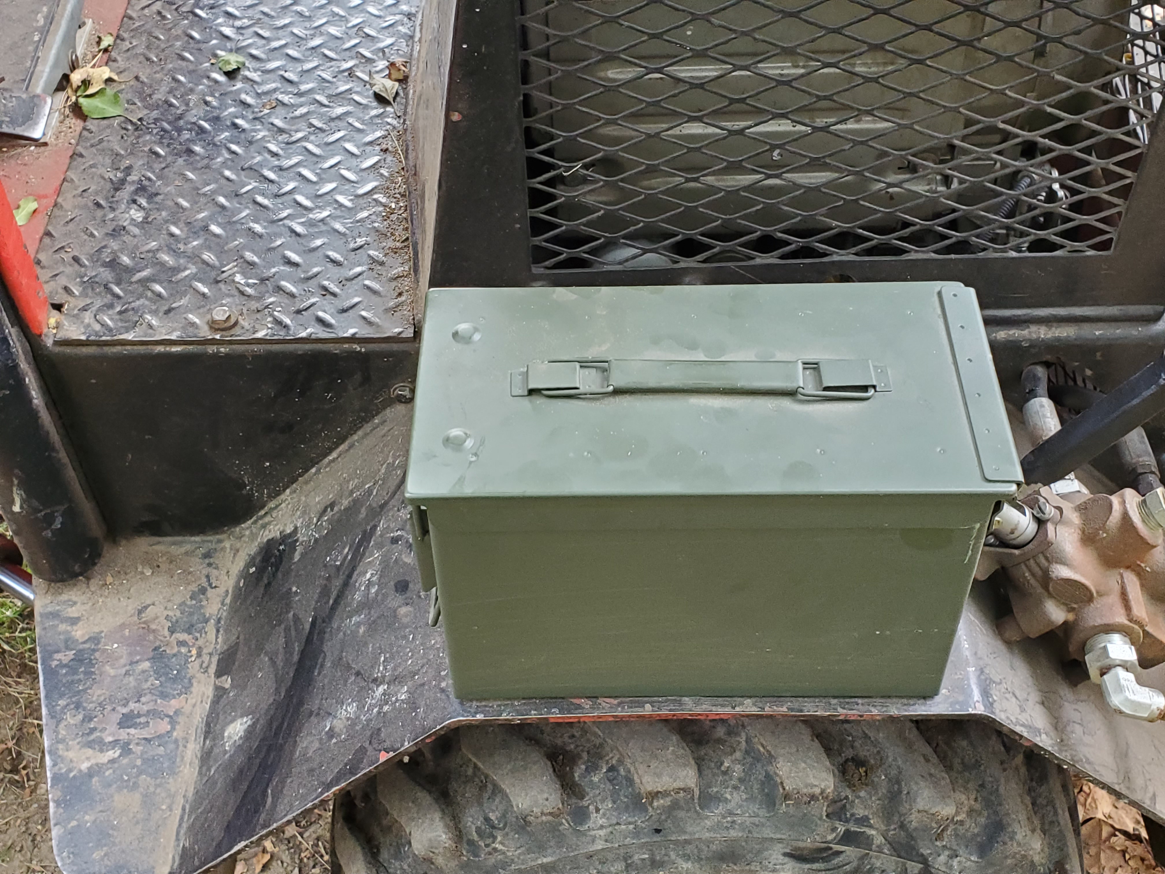

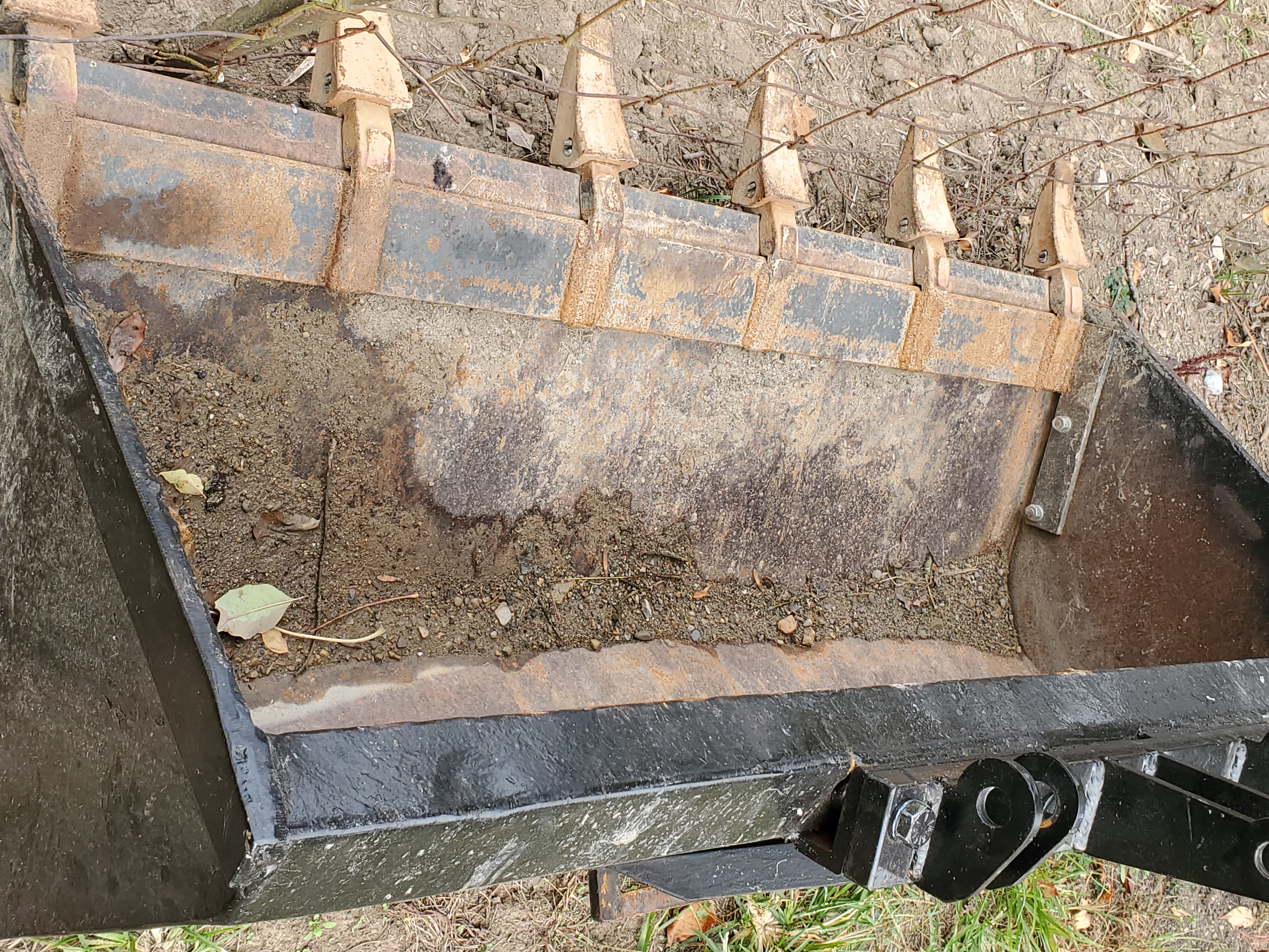

I have been lurking on this forum for about 1 year waiting for an opportunity to buy a used PT. This past spring I finally found a 2005 PT2430 without a backhoe and as soon as I got it home I started making some minor modifications for the uses I had for it based upon ideas I gleaned from the wisdom of this group. This PT came with the light material bucket but I wanted to be able to dig with it so I cut about 10" off the front of the bucket, reinforced it and added a homemade toothbar. Then I purchased a grapple from greens machine and added it to the bucket. It worked so well I decided to make mounts for the forks as well so I could move the grapple from the bucket to the forks. I then found that without the backhoe the rear end would lift off the ground with a full bucket so I tapped into the hydraulics and made a rear 3 point hitch and a weight box that can also haul my chainsaws, mauls and etc. I also added a harbor freight water proof ammo box to use as a tool box for chains, splitting wedges and etc. We heat our house with wood so I then made a log splitter to attach to the fel and plumbed the pto through a valve to run it. It works well for splitting the large pieces that are too hard to wrestle under my tow behind vertical splitter.
front bucket with tooth bar.jpeg front bucket with grapple.jpg 3 point hitch with weight box.jpegForks with grapple.jpeg Log splitter control valve.jpeg FEL log splitter.jpeg HF ammo box.jpeg Trailer hitch receiver.jpeg

But what did you do in your spare time? :laughing:
Nice find and good job on the modifications.
