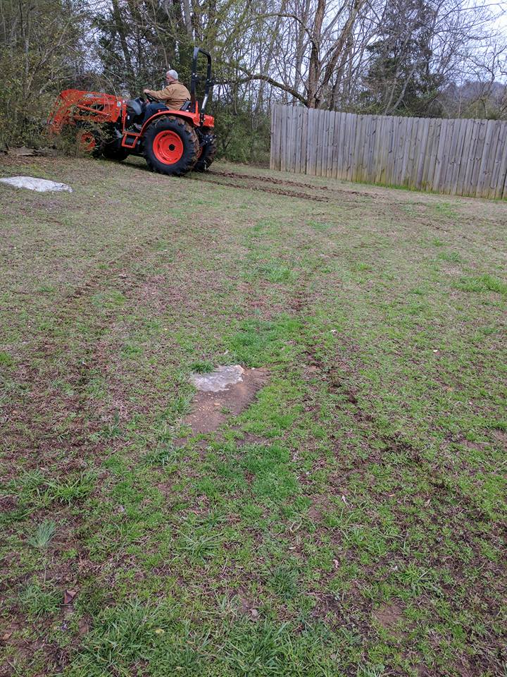

I decided to go with the NX4510, telescoping 3point, filled wheels, 2 rear hydraulics and third function, up front.
Next: Grapple, PHD and hoe.
Upon delivery, I decided to make a new start to a path up the mountain for absolutely no reason.
