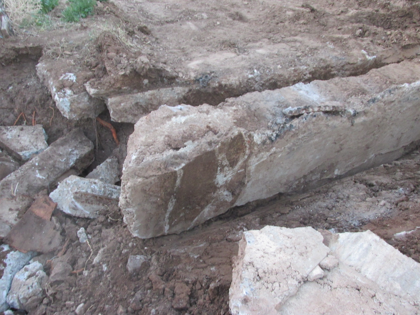

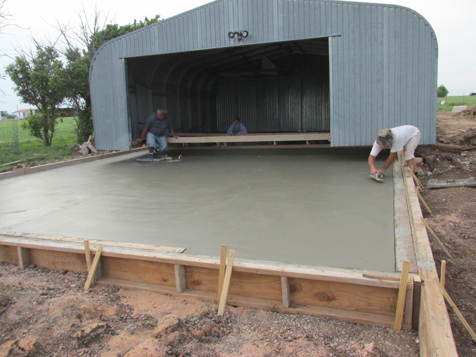

I have the concrete for the floor poured(Friday). Wet it a few times over the weekend, light rain Friday night.
My planes is to move the building up on the floor and anchor it down.

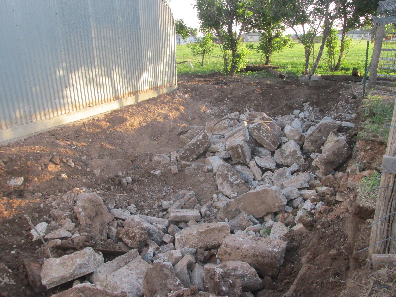

I am open to suggestions for the best way to accomplish this. I would rather not put any heavy equipment on the floor for fear of damage. The back half of the building will have to cross over the hole where the buried container was collapsed. this hole is about 3 to 4' deep 12' front to back and the full width across.
Also can not work from the sides with equipment due to trees on one side and part of the hole on the other side.
Any and all Suggestions would be appreciated.

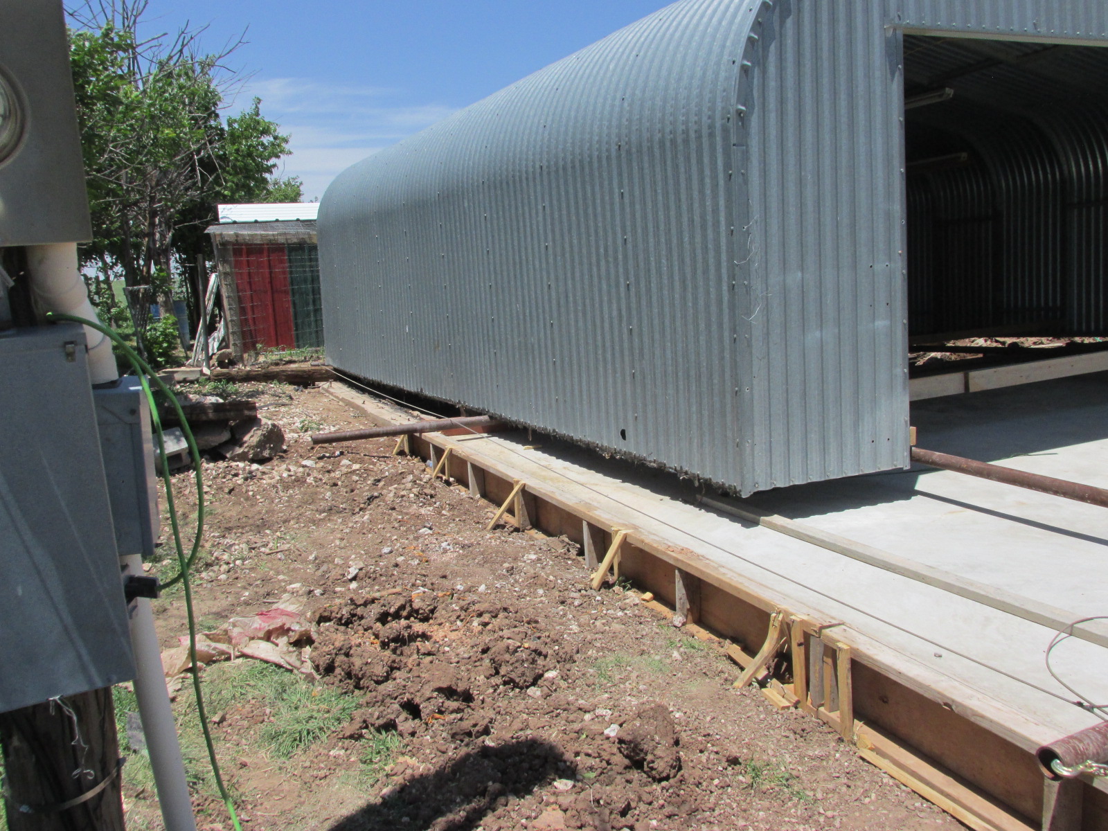

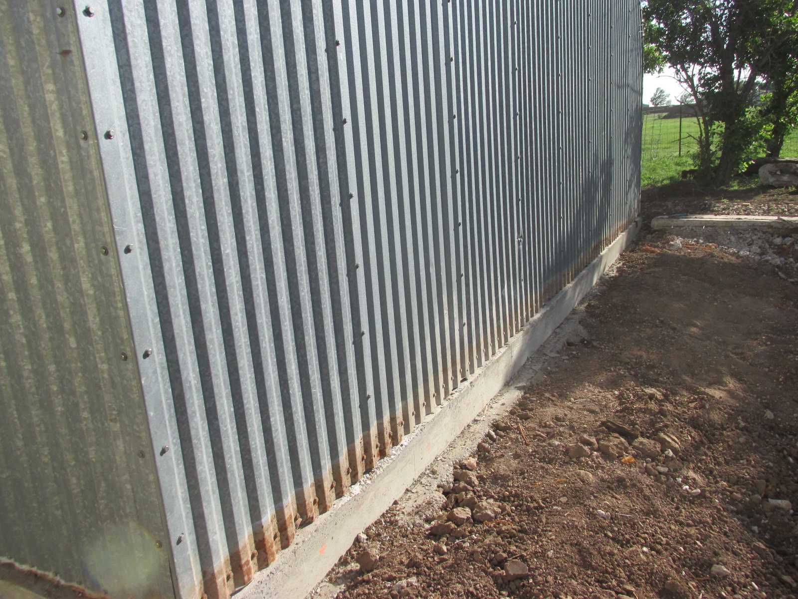

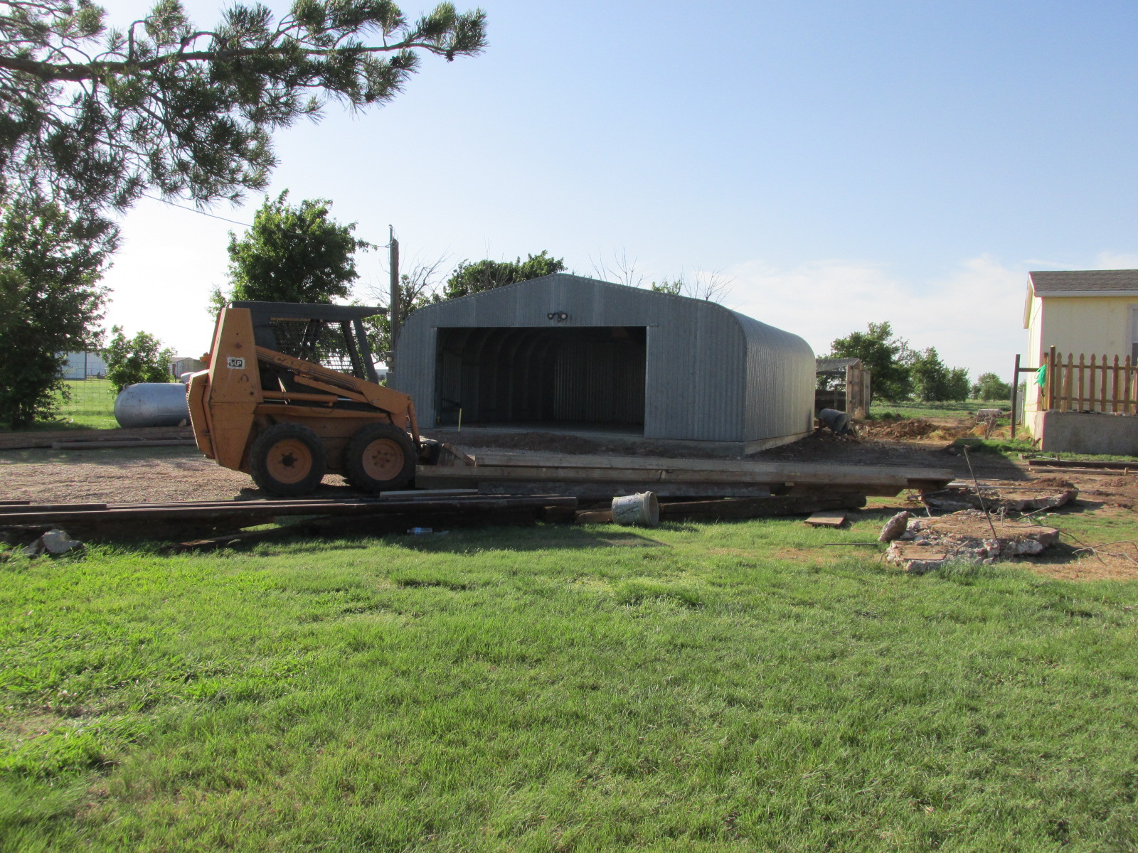

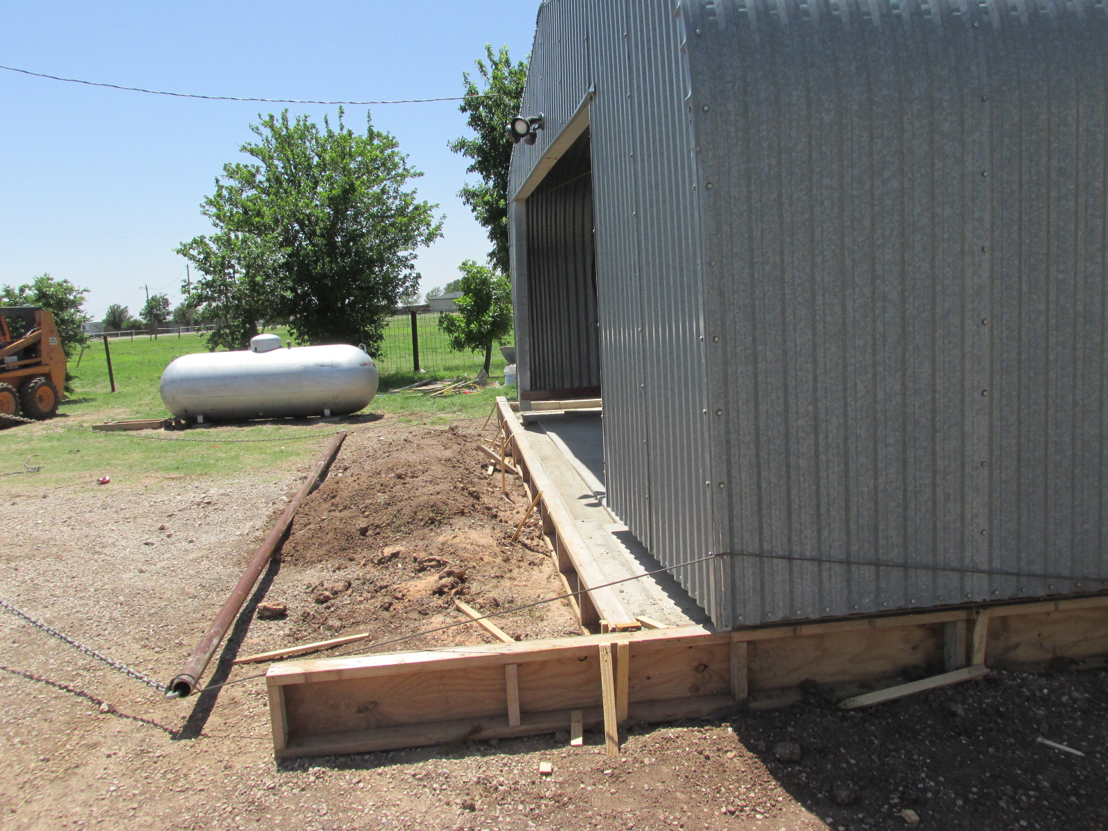

After a long day, I have the building moved onto the new floor.
Almost there

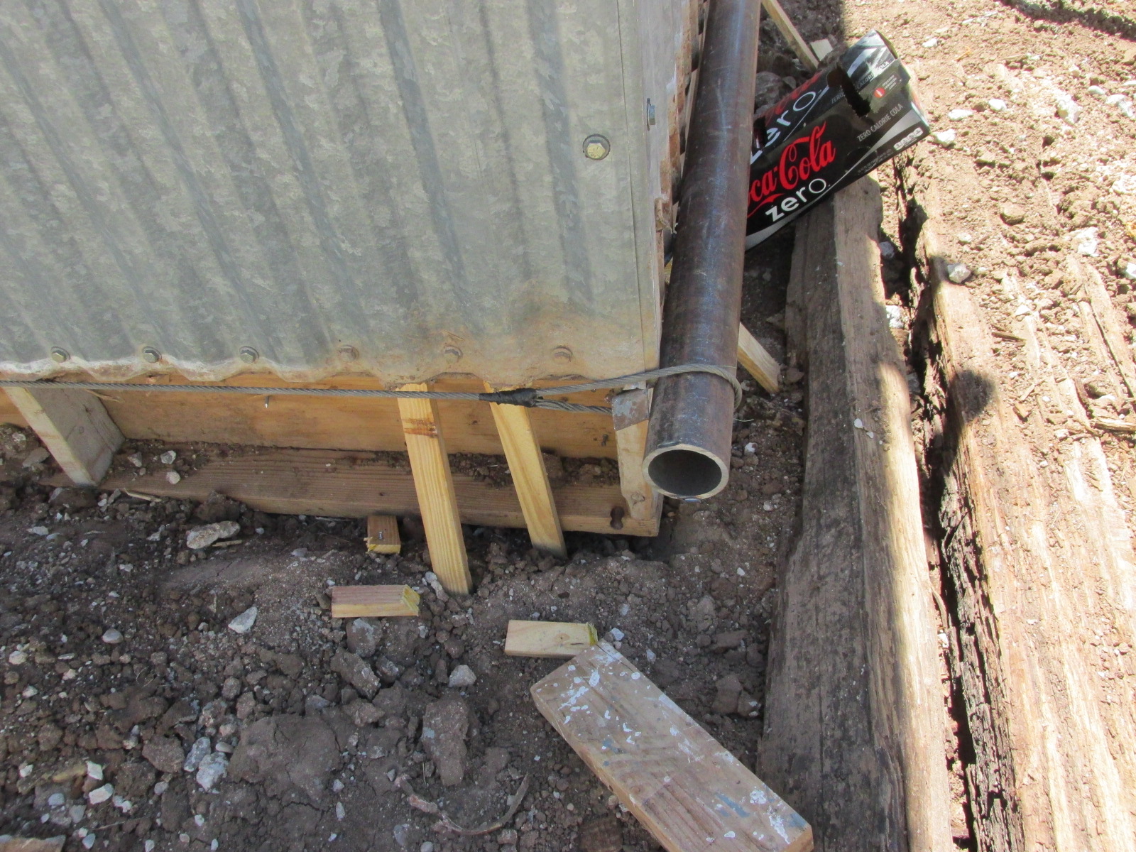

Here is the way we, myself and 2 men, moved the building.
Cut the form retaining stakes off even with the top of the forms. We placed 1 3"diameter pipe , has 1/4" walls, and was long enough to reach from one form across to the other side with a couple of feet to spare.
I came up with this idea to pull the building.
Backside
Front side
side view
This method allowed me to have a even pull with all the stress on the side plates
All of the weight was on the out side forms. No equipment was ever on the floor.

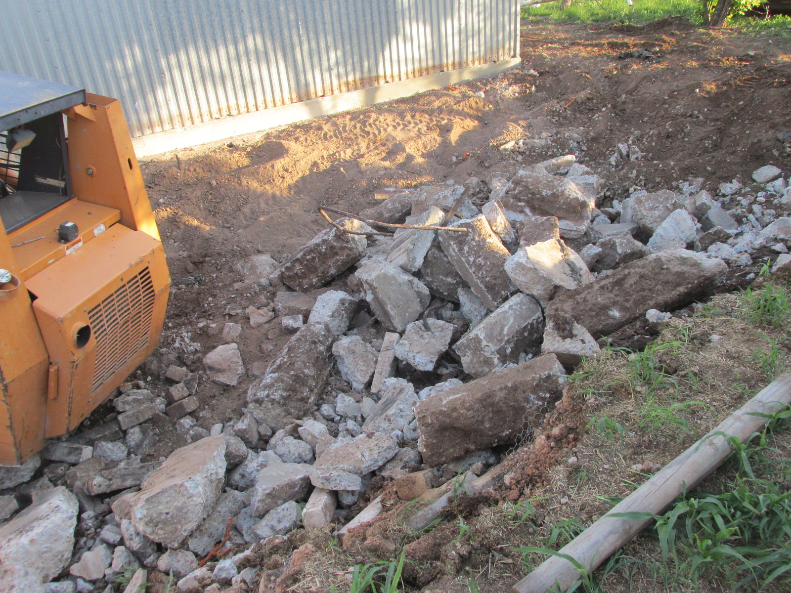

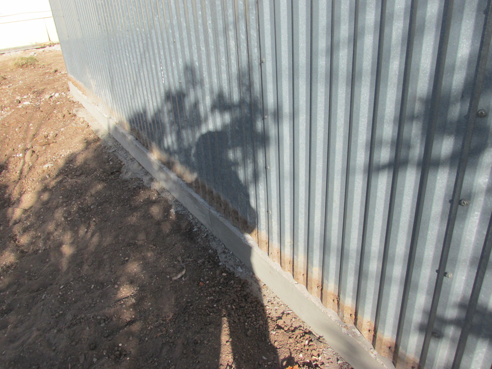

Building is in place and anchored down.
Putting concrete in hole.
Having a little bit of a problem moving this into the hole.
I will have to get a friend to bring his tractor over and we will double up and use a long 1/2" cable and pull from across the hole.
About all that is left to do is cap the concrete with a couple feet of dirt.
Has been an interesting project..
