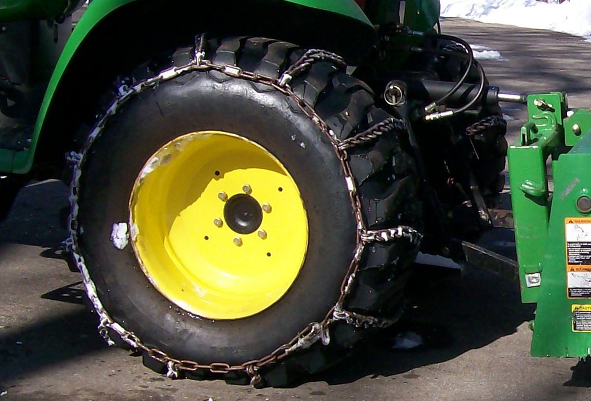

I found a pic of my custom chains that have side chains that stay in the dip at the lug ends. If my chains ran along the sidewalls, I'm afraid they would also be much too close (for comfort) to clearing with the tractor parts.
Not sure if your (1972) custom chains run that high, or are on the sidewalls.

I see what you mean now. No, while I have not had my chains on yet (afraid to do it until I have clearance) I would think mine will come about half way the side wall, or perhaps a bit more. I know they will go down further than what you show.

As for the chains, I've attached a picture of them. They are an "H" pattern with the welded "V-lug" cross piece. Good chains, although I was disappointed in the way they made them up with the quick links to attach the tails as you see in the picture. That has since been corrected. I have to have them custom made up because none of the JD dealerships in this part of the country sell chains. Which is another reason why they don't know much about them I guess.
