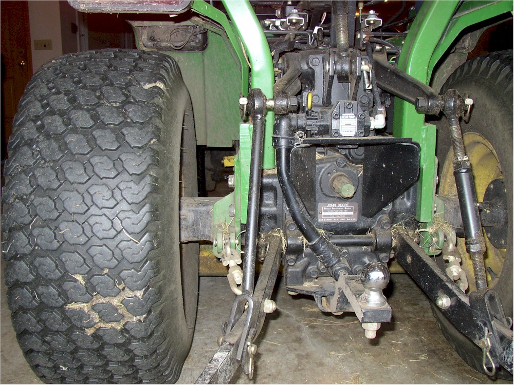

3/4" might even be tight if those chains flop around a bit. Haven't installed mine yet, but after reversing the wheels, I expect to have 1 1/2" (clearance between the chains and fenders) or so.
Don't forget to tighten those chains up after some running (tirechains.com says to tighten them after a quarter mile).
As far as your last statement "...some of the tractor makers have so little clearance between the tire and fender", I doubt if chains are a big priority for most manufacturers. Deere, at least with some models and tire types, does allow for some adjustability. I don't own a Kubota, so I don't know about them...but I have seen Kubotas with chains.

3/4" of clearance isn't near as much as I would like. Kubota could have done better. I had to make sure the chain links are twisted just the right direction so that the cam locks on the chains didn't swing and hit the fender. The chain does adjust tightly on the tire and I have the tirechains.com spring chain tensioner just in case. I did OK all these years also until last winter. We had 19" of snow in one week and 4 days of 25 MPH winds. This land is flat as a pancake for miles and I would push snow for three or four hours and when I got done it looked the same as when I started on the 25 MPH wind days. The 4WD Kubota with R4's spent more time sliding sideways than forward or reverse. Very frustrating. So I went to tire chains and a ballast box this year. When I expressed my disappointment with tractors not having clearance for chains I did not mean to bash a particular brand. I was comparing the modern tractors with my previous 1964 Massey MF135. It had plenty of clearance and adjustable tread width on top of that. When I buy a new tractor that is 46 years newer that has less features that aggravates me. I put my new ballast box on yesterday and filled it with gravel. I did some dirt moving with the loader with the ballast box on . I really like the ballast box.

I have never used chains on my 755, and never been stuck. Now there's a statement that probably guarantees I'll get stuck next time out. So sometimes I think about getting chains just to see what difference they would make. Seeing all these clearance problems on other tractors, I do appreciate my minimum clearance of at least 3 1/2 inches.

I think we all feel the same way, at least I do. I'm not bashing anything, especially "my baby", but one does have to wonder why they don't see to allow for a bit more clearance today in regards to chains and such. Cosmetics I guess. Those low slung and narrow fenders look "cool".
Ah well, there is always a way to overcome the problem. I'm going to go with either spacers or custom rims, AND, I think I'm going to buy new chains. These were custom made for these wheels, but they are pretty heavy chain. I may go to something lighter to cut down on the profile so there is more clearance.

There is a possibility that the mouting hubs on your 2320 are the same as those on a 2305. If that is the case, JD makes a set of spacers for the X700 series that will work. I would check with your dealer about that since he seems pretty helpful.
