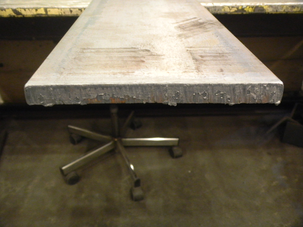

I think propane makes some really nice cuts:cool:. Just takes longer to preheat:( before starting the cut is all.

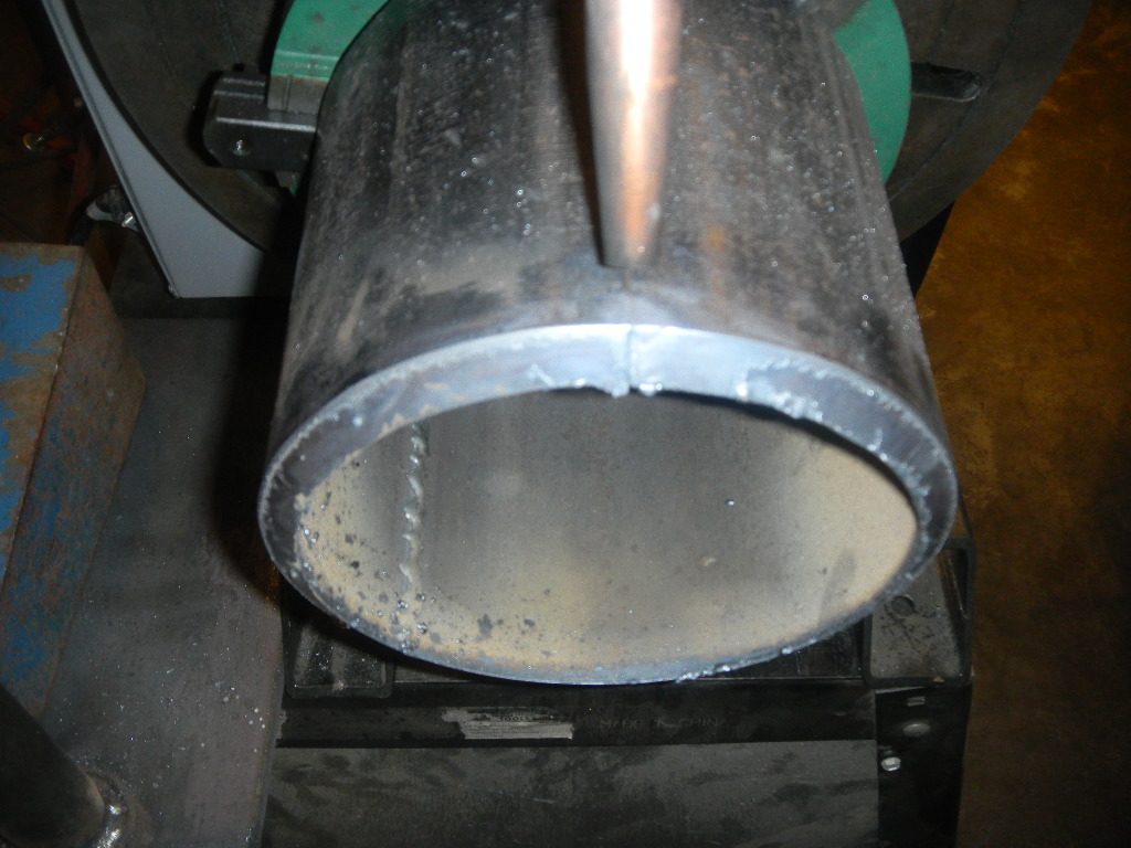

Cutting a 37 1/2 degree bevels on 6-inch schedule 80 pipe.
Those that are willing to come to my shop, I help them with their welding. ;)

Very nice cuts you made there !!!
Did you use a device/guide to make that bevelled edge on that pipe ?
/ propane torch set up #19

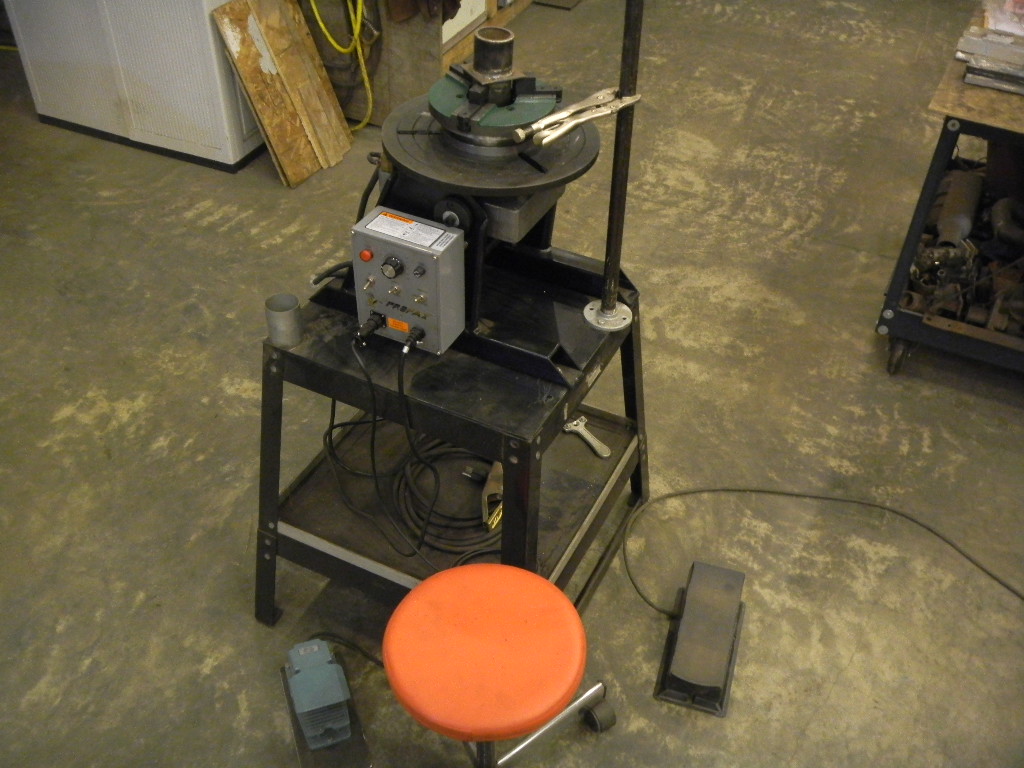

I converted my machine torch from my tractor torch, to work with my weld positioner.

Very nice, thanks for the extra info & pictures.
