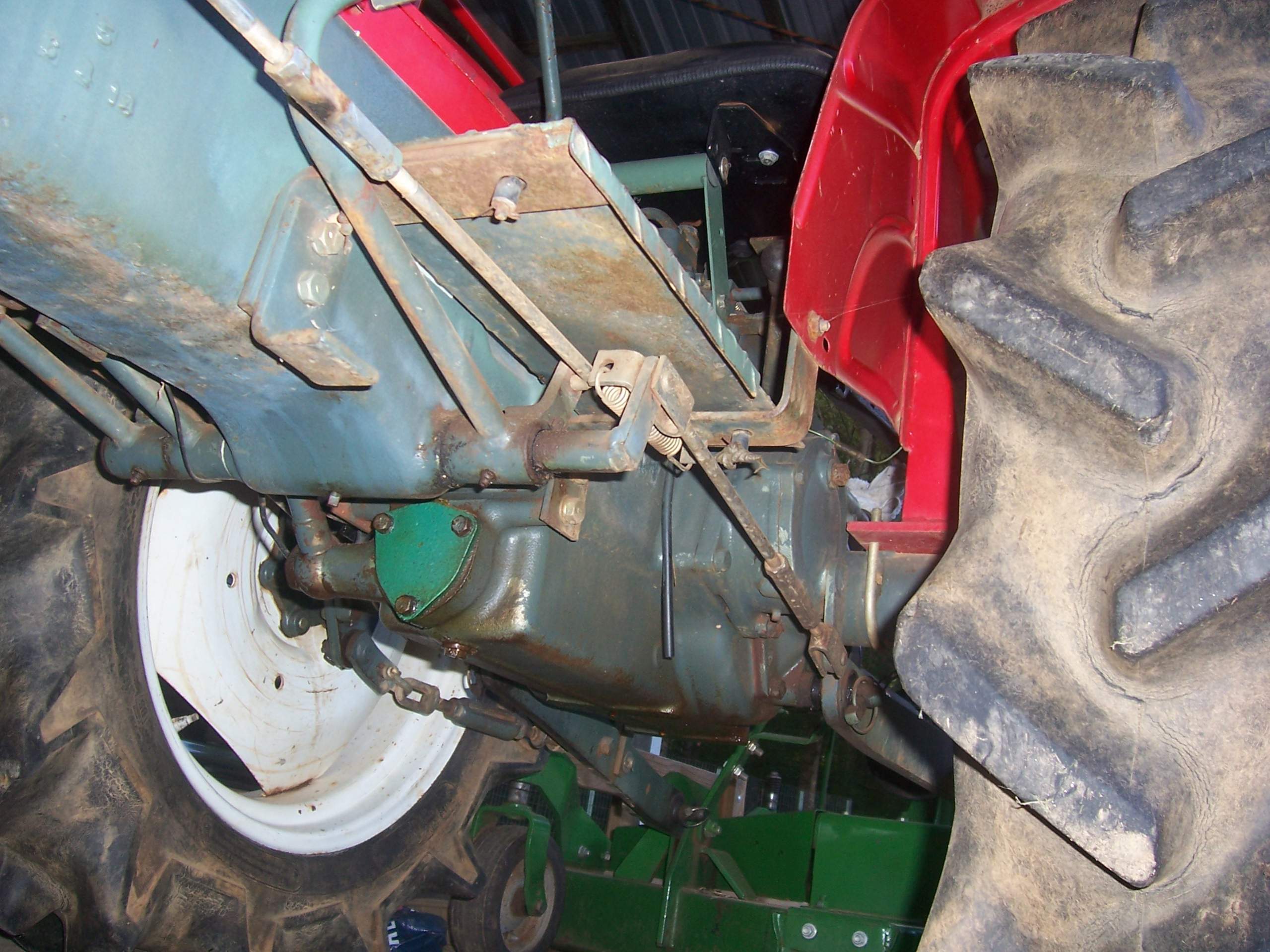

IMHO the price may sound slightly high from your discription and for my area. But not by much. On the Tires I wouldn't worry to much about them.Mine are the same as you diiscribed.May even be worse. My Dealer told me not to worry typical and would last for yrs. So far that seems to be the case. It's been over 3 yrs. and I have yet to have any problems or even had to add any air but once when first bought it. I bet they look like this Pic.
The Rule Of Thumb when selling used. always have your asking price high. You can always come down but it's real hard to go up :laughing:
Carey
