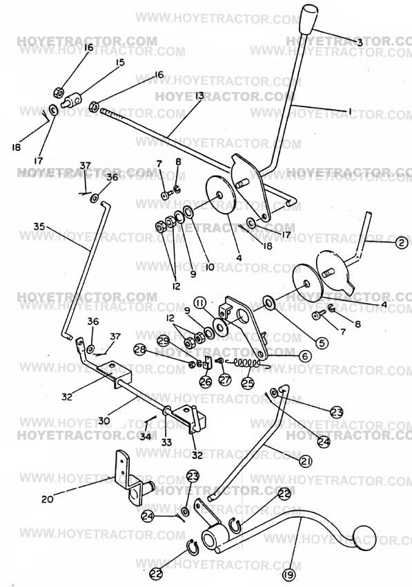

As far as the deiseling goes after shut off thats probably cause when you shut the throttle down its stiff enough not to allow the lever on the injector pump to imediatly shut fuel flow down (mine is the same) it will slowly close after lever is closed. This is due to a misadjusted spring, weak spring or to tight of a throttle. This should be an easy fix. To get around mine i when i shut the tracotor off i have got in the habit (sine i let it cool down anyhow, and am usually of it anyway) of putting one hand on the throttle lever and one on the linkage that its attached to that goes to the injector pump. I then close the throttle and simultaneously pull the rod back on the injector pump to shut the tractor off so it does not do that deiseling you talk about.
See the picture, for the rod im talking about. Its part #13, it connets to the lever on the injector pump on the right side of the tractor as you sit on it.

As far as the dieseling goes after shut off thats probably cause when you shut the throttle down its stiff enough not to allow the lever on the injector pump to imediatly shut fuel flow down (mine is the same) it will slowly close after lever is closed.
The two times I shut it off it didn't diesel and he was just adding that for our info. I sort of forget what he said, but I think he said when he turned it off using the key (?) on the "dashboard" by itself that sometimes didn't shut it down and that he did in fact throttle it off. But I could be making that up with selective memory. I'll ask again.[/I] :eek:
