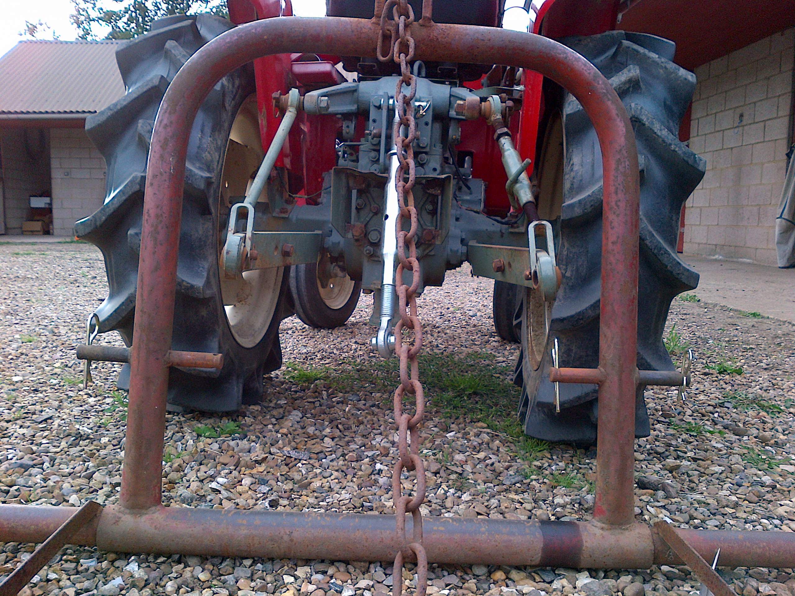

3 Point Linage Question - Can anybody help ?
I am a complete novice when it comes to tractor ownership. I have recently been given a grader for our ménage. I've hooked it up to my Yanmar, but the height of the grader mounting pins means that only part of the grader touches the ground, although I am assuming the whole thing should make contact with the ground ?
Is this grader for a larger tractor ? my linkage seems to be working ok, any suggestions ? IMG-20130810-00340.jpg
   / Proud New Owner of YM1610 2WD #39
Not for sure but I believe your side links are way to far back on the lower lift arms. Might try moving them to a hole further forward on the lower lift arms. I cannot see the back of the grader so perhaps you are saying either the front of the back of the grader is not touching the ground. If that is the case then you need to shorten or lengthen the top link. Here is a parts list of the 3 point components. Yanmar Tractor Parts: Under_20_HP
How about some pictures with it hooked up?
#40
Thanks Winston1 - yes, only the back of the grader touches the ground. Ok - So if I move the side links back to the spare holes on the lower lift arms (next to the bolts you can see on pic) then the linkage will be lower and therefore attach to the grader. Great, I'll give it a try as soon as I get home from work.
