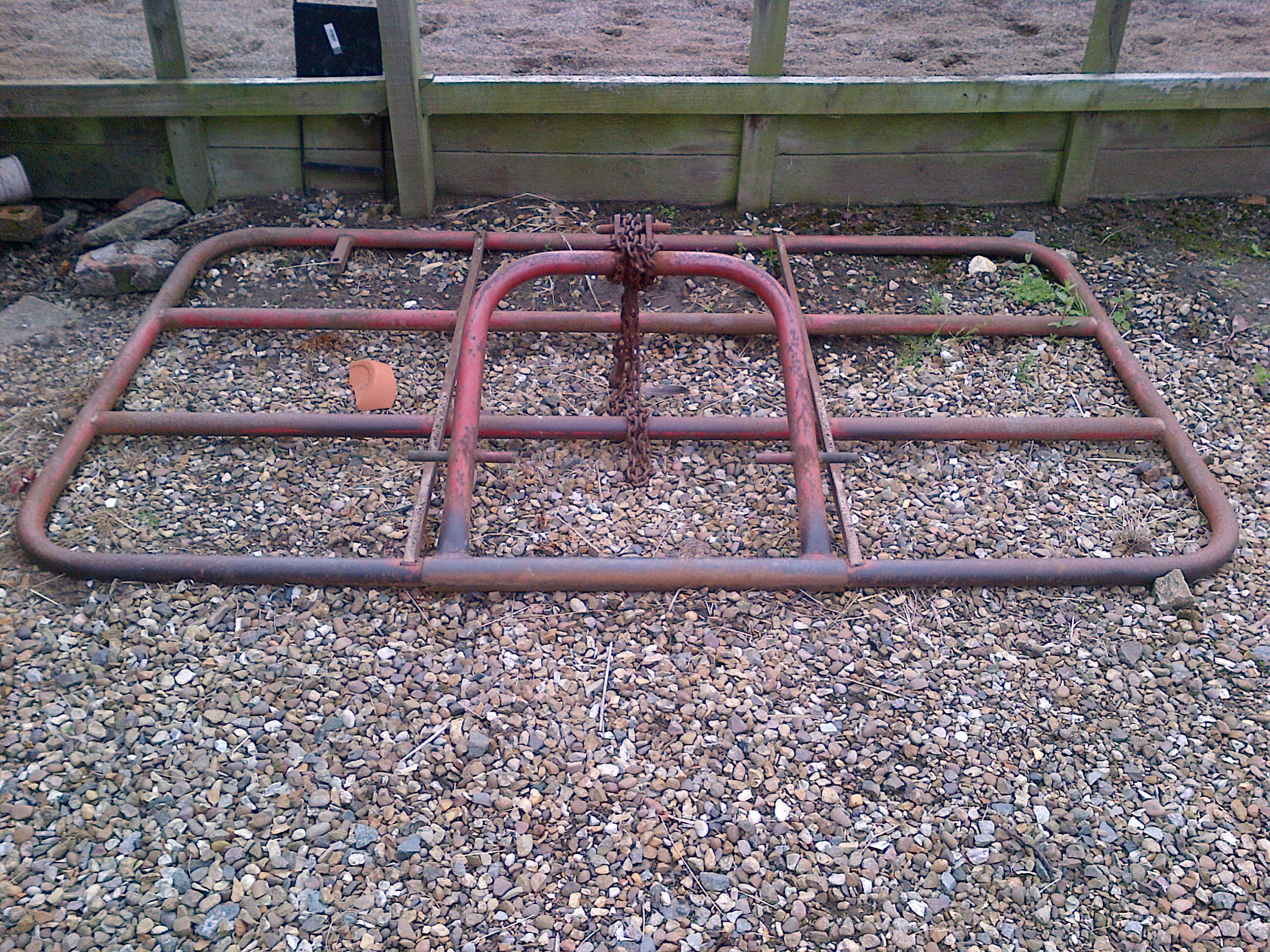

OH YEA , Winston is right again. MOve those vertical links that hook to the lower lift arms back to that open hole closer to the rear axle. You will loose some lift ability but for this it wont matter, you need those arms to drop lower.
If you were useing a heavy disk the way they are now may be a fine setup, as the thing has high attachment points and you need the lift ability.
   / Proud New Owner of YM1610 2WD #42
Thanks Winston1 - yes, only the back of the grader touches the ground. Ok - So if I move the side links back to the spare holes on the lower lift arms (next to the bolts you can see on pic) then the linkage will be lower and therefore attach to the grader. Great, I'll give it a try as soon as I get home from work.
Try shortening the top link first, that may allow the front to come down to touch.
Well, the more I look at your picture the more unsure I am of what you have. I now believe the back of your grader probably pivots off the front and the chain in the picture is what limits its downward movement. If that is the case then go with my first suggestion. Just not sure what I am looking at. Sorry.

The grader or whatever is pictured there is not hooked up yet.
   / Proud New Owner of YM1610 2WD #44
Yep, I can see that but cannot see the rear of the grader. I'm sort of thinking the rear of his grader is hinged off the front of it but just not enough picture to know.
   / Proud New Owner of YM1610 2WD #45
Yea i have no idea what that is a picture of? I was picturing a rear blade, but think its more like one of those land plane things, but the more i look at it, i like you have no idea?
Kind of like a bush hog is called a bush hog, shredder, rotory mower, roughcut mower, brush hog, and on and on.

I've adjusted the lift arms and the grader now sits firmly flat on the ground when lowered, thanks for you're help.
This picture shows it more clearly. It is hinged and held at a right angle by the attached chain. Worked ok when dragging it around with only one bar touching the ground so should be great now I can use it correctly.

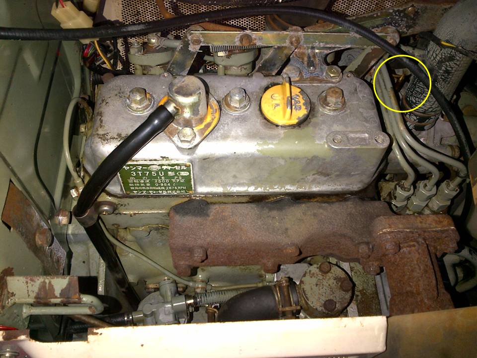

Never sat on a tractor before I bought my 1610 let alone worked on one ! I've now changed the air and oil filter, new oil, new voltage regulator, new indicator switch etc.
Only things left in the short term are transmission fluid change and temp sensor change.
Transmission fluid - John Deere dealer does not recognise JD303 so need to confirm the alternative, any ideas ?
Temp sensor - Finding it very difficult to remove as there isn't a lot of space.

Thinking your sensor is right on the side of the water pump. Should have good access. You might have to remove the engine side panel.
Thanks for the extra picture of your drag. That explains a lot. Sounds like things are going well. :thumbsup:

The sensor is on top (circled) so should be easy. I need to get an extension piece for a wrench and hopefully I can get it to turn.IMG-20130725-00319-1.jpg
