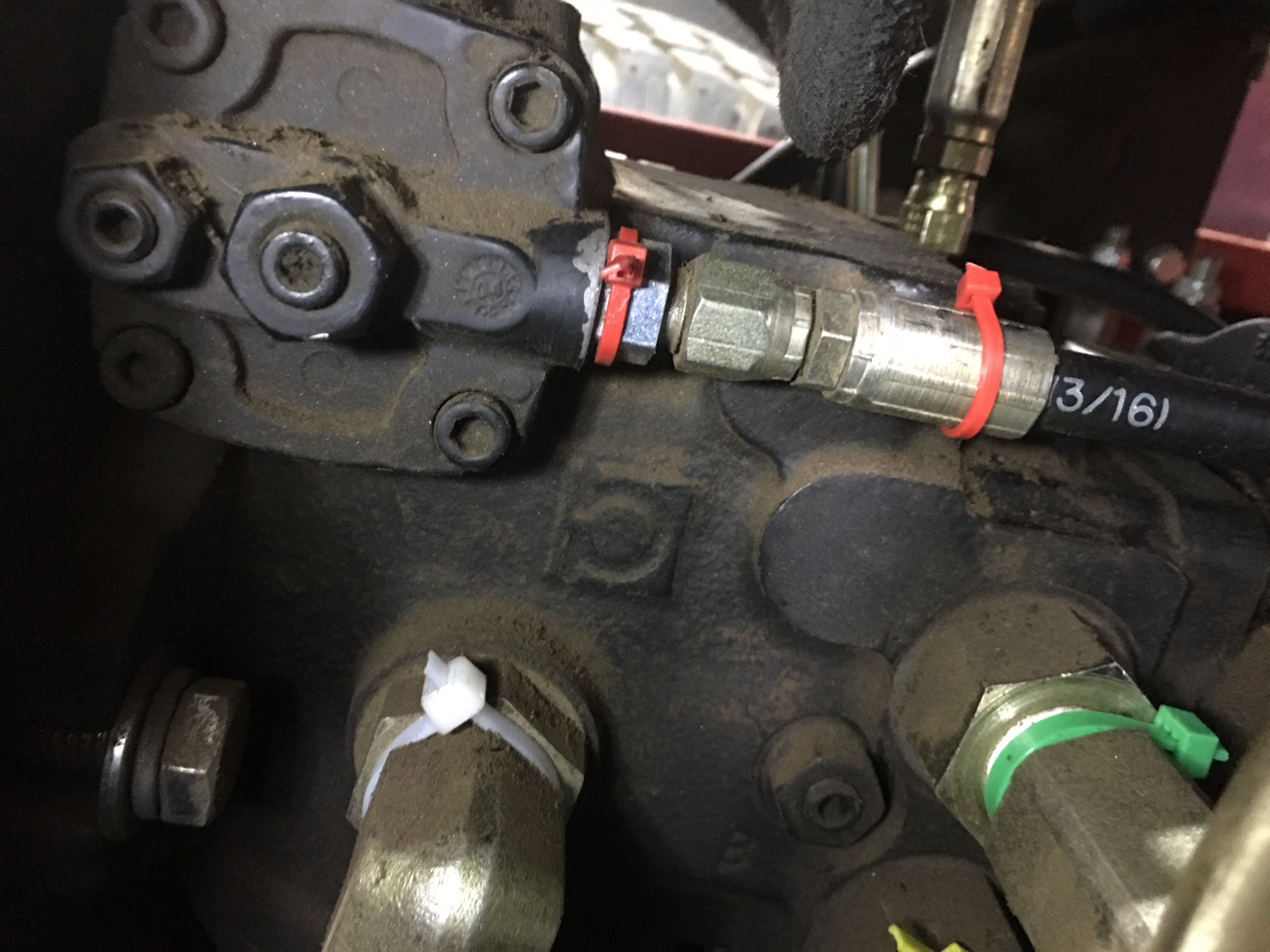

i called terry back and i described the tram motor and he said since i my tredle is hydraulic i didnt need a jumper hose. he said turn the bolt head (barely seen above and to the right of the 3/16 lettering on hose) anywhere from 1/2 to 2 turns and he said that should free up the wheels so i can get it towed back up to the garage so i can get it out of the front yard and start working on getting the tram motor out. he said when i get it in the garage, i should either remove the gas tank or swing it out of the way, disconnect the pto/steering pump from the tram pump, label all the hoses and then disconnect the hoses then disconnect the tram pump from the engine. so more to come when i do get it back in the garage.

X2 on the "label the hoses" advice! Preferably labeled in more than one place with materials that are oil resistant. (BTDT...) I have found that taking lots of photos as I work my way along to be really helpful in the reassembly process.
Congratulations, it seems like you are making progress.
All the best,
Peter
Good. I wish mine had a tow port.
As mentioned, labels and pictures, pictures and labels. Oily hoses tend to shed taped labels.
I'd give everything a really good degreasing and bath before attempting any disassembly. Dirt is the enemy of hydraulics.
Good luck and thanks for the update. (y)

thanks everyone, i had a local farmer get the pt towed up to the garage today. i got the hoses ziptied with different colored and sized zipties so far. stiil have to unscrew the big hydraulic filter housing from the gas tank and also have to remove the battery so i can get the gas tank moved so i can get to the tram pump. ill give everything a good cleaning once thats done then take more pics for documentation before taking off the pto/sterring pump to get to the tram pump. after 16 years of owning this 1430 finally a major problem to really take a lot of time to get it fixed. also someone asked how many hours i have on it and i have a little bit above 900 hours. thanks
