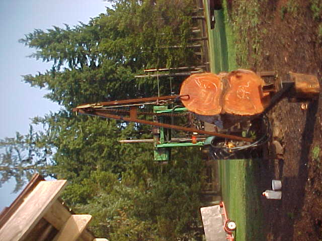

I have an old Unimog and fitted it with a hydraulic log splitter using the 540 pto and an old hydraulic pump from a truck. The slow revolving pto and the big capacity pump gives an ideal speed on the splitter. No trouble with overheating. The splitter is mounted in front with a sliding attachment, (self made) A jerry can with hydraulic oil is enough, even if experts says otherwise.

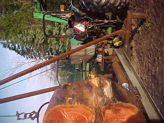

I have read your posts, I live in Norway, and I wonder why not anybody of you talk abouth using the return oil to speed up the splitter. If you force the return oil to fill the pressure side of the splitter, it will move much faster. Less power but more speed. If you need power, just switch the oil into "normal" return, or buy a pressure valve that that will do the job automatically.
/ pto driven log splitter #47
Are you looking for something like on pic?

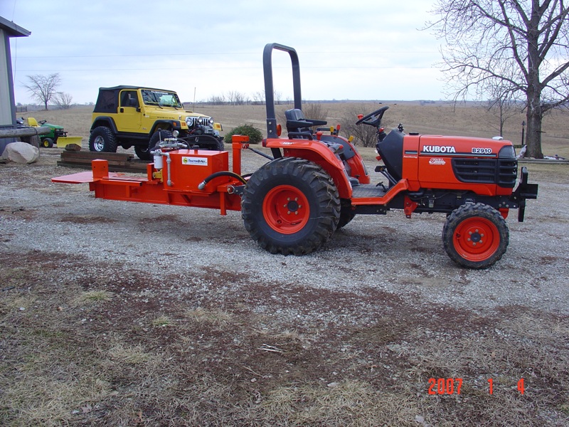

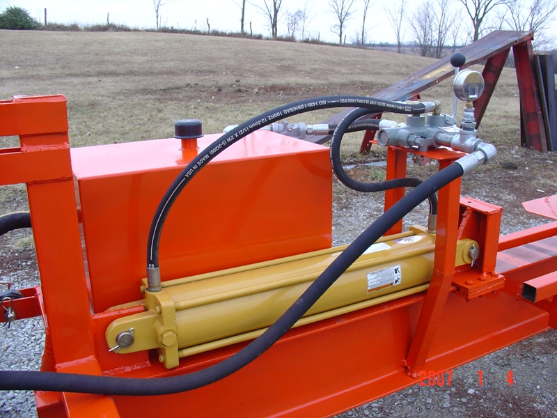

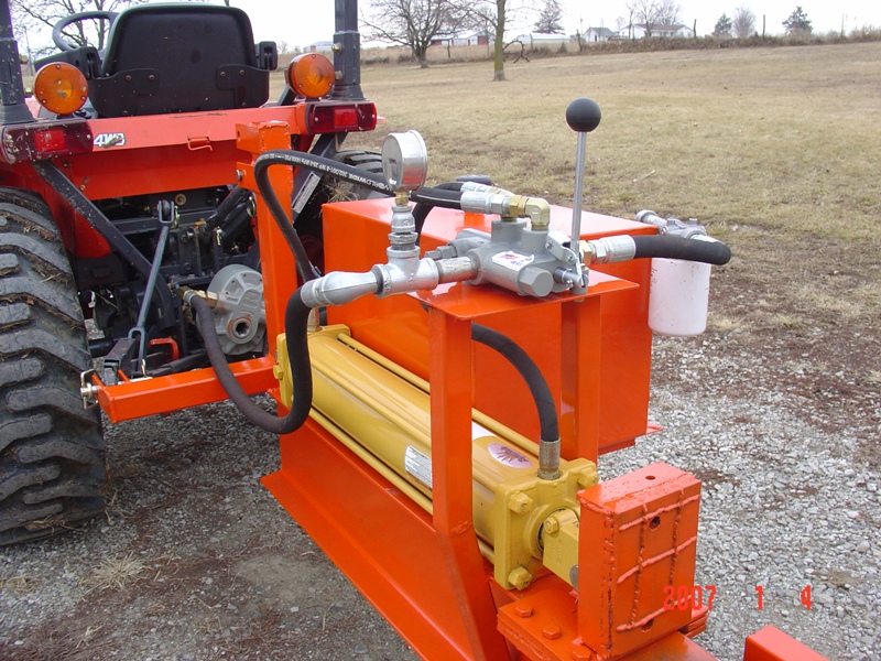

I built one to use on a 30HP Kubota B2910. I used a 22gpm PTO pump. I loved it. Cycle times were great and it had tremendous splitting power.
Here's a couple pics.
